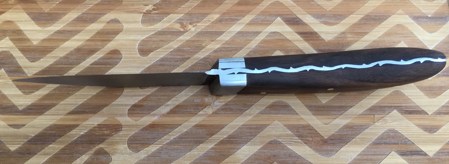

I am happy you like my filework, it is fairly basic vines and thorns the kind you find tutorial for easily on the net.
Here is the first "knife" I made about a year ago and I did it on that one too (the quotes are there as I practiced on mild steel to make this one)
VQdBf7

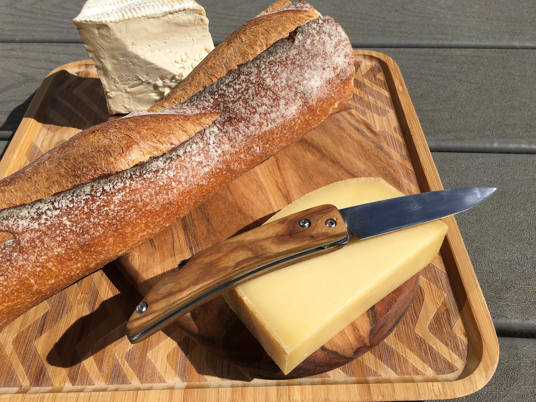

Here is my second folder, a screwed on construction with no bolsters.
BJLf9J
The pivot hardware sticking out over the bolsters look awkward. Either drill a counterbore hole to set the heads down in the bolster, or place them under the bolsters, and screw the bolsters over them. You need to drill a recess in the underside of the bolsters to match the heads. This is the most smooth and professional look. Remember, the pivot only needs to go through the blade and the liners.
The stop pin has the same issue. It only needs to go through the liners to work. Placing it under the bolsters will make for a smoother bolster. Again, this is simple when the bolsters are screwed on.
The bolster being too thin is definitely an issue and I have in fact discussed with friends here exactly the approach you mentioned for hiding the stop pin.
I think I would only be able to hide either the pivot or the stop pin, the bolster have to be fixed to the liner somehow no? And if I use a mostly screwed construction I do want to make sure the knife can still be taken appart.
I definitely need to invest in the right piloted counter bore for setting the screws correctly both in the bolsters and in the scales. I guess I would need a different style of screws too. The round headed one wouldn't look as good recessed.
A question related to screws: The screws I bought together with the pivot are too long the length of both together are longer than the pivot. Because of that I cut them to size, however that leaves a kind of bur at the end of the screw which makes it hard to start screwing them. Since the srews are so small I am having a hard time filing or sanding away this bur without destroying the thread (in part because they are hard to hold) do you have recommendation for that.

Regarding file work on the back of slip joint, this is actually very common on french knives. Causes no problem with dust and I don't think it affects the spring.
The Laguiole knives are a good example of pattern which are made with all kind of intricate filework (called guillochage in french so look up "Laguiole guillochage" in google) and they are slip joints.
UDeYUU
Some company will have each individual craftman in their company do a specific type of file work on the blade in addition to that on the spring as a way to sign the knives, here from Laguiole-en-Aubrac
R8zW7N
Another french pattern often sold with file work is the le Thiers
svmqjc

The new knife is better. You might want to make the counter-bore for the screw heads a little closer fit. The rear screw seems to be sticking out on the side, but that may be the camera angle.
Also, try the next size screw smaller on the scales. It looks like you have used 4-40 screws. Again, that may be the effect of the photo closeup.

OK knife is 3 finished, there are still things which could be better but they'll be for the next one. I took a couple picture next to my first one for comparison.
Since last pictures, the scales where glued and pinned, the pins peened, the scales oiled and buffed, the blade sharpened.
