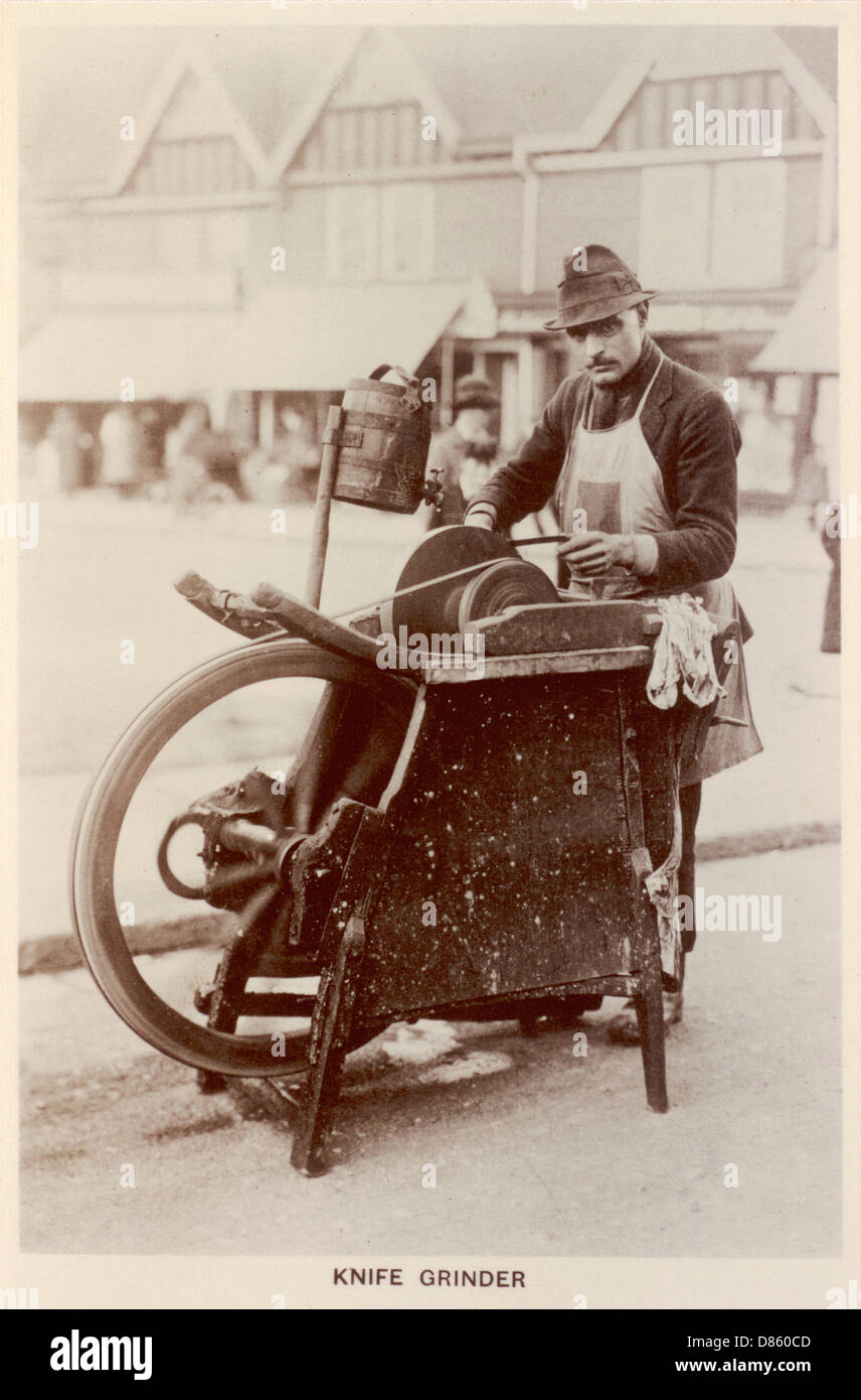

Just a small hijack Mike. Your post about grinding reminded me of something I read once by Chuck Buck. Back in the day it could take as long as two hours grinding a blade shape by hand but they had machines in the factory today that could do the same job in 17 seconds. Wish I could remember where I read that to verify my memory.
Some cool old pics
