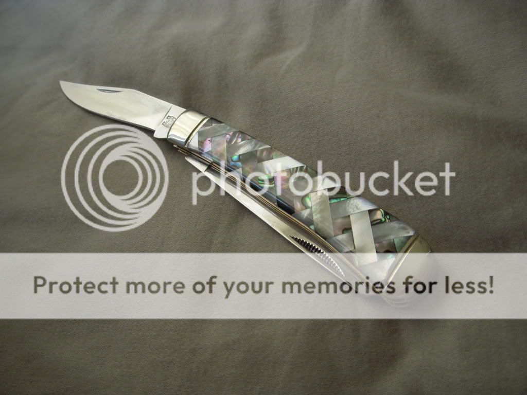

I'd generally agree with that. Although, I just got this for exactly $20 shipped, and I'm very impressed with it for the price. I haven't seen anyone post anything about this particular knife yet, so here's the Rough Rider basketweave pearl Trapper:
As others have stated when 440A is given a proper heat treat and left somewhere around 58 on the Rockwell hardness scale it can be more than serviceable. I own several inexpensive Rough Riders and while the edge retention is decent at best those little slipjoints can take a down right scary edge all in all while it isn't a super steel by any means it had the potential to be decent stuff.
