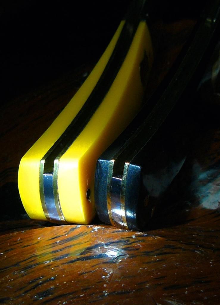

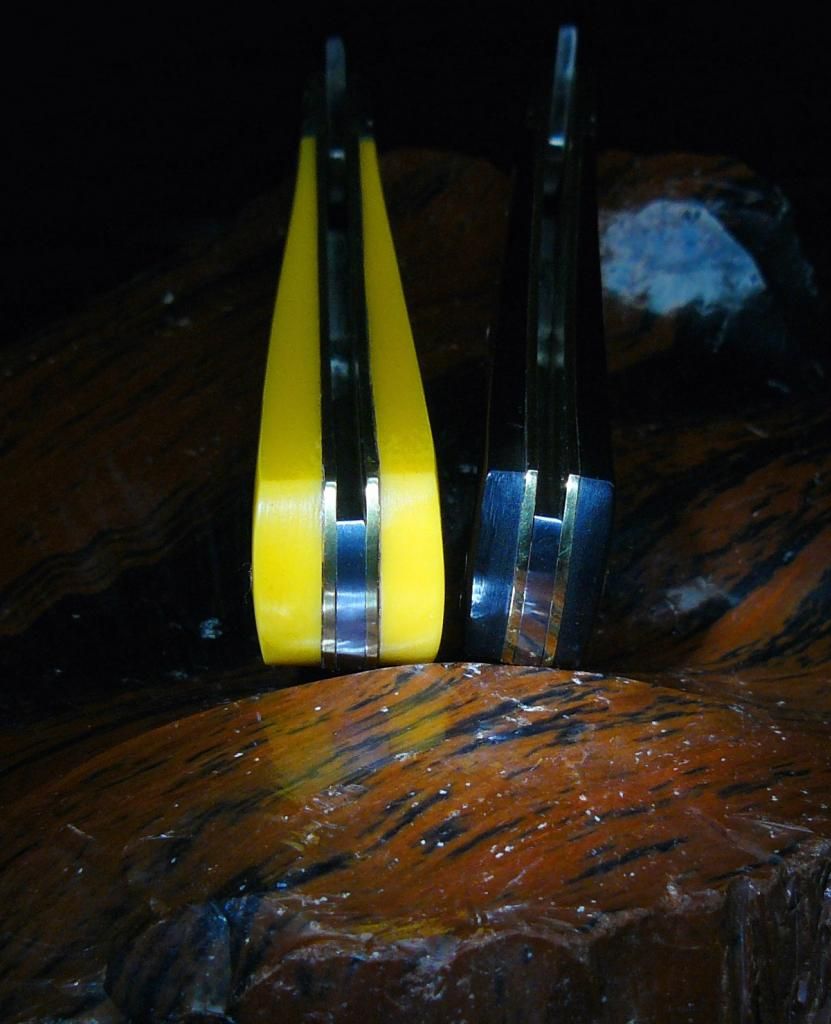

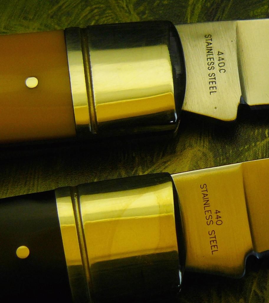

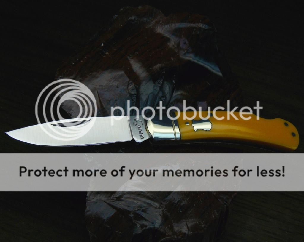

Boker plus 250Y, 6 5/8" overall open, 2.71 oz., NS bolster, brass liner, lockback, nail nic & kinda orange colored, handle flares from 5/16" (at pivot) to 5/8" (at end of bare head handle), tang marked 440C.
Boker plus 250, has nearly the same physical characteristics as above except for scale color, black resin scales as you can see, and barehead end of handle is thinner, about 7/16" vs 5/8" on the yellow handle's end. Tang stamp has 440 (no "C").
Inner edges of brass liners on both folders could use some small work to flatten their sharp edges but this is a minor issue and expected chore given the bargain price, less than $20 each delivered.

"real" 440C heat treated properly should hold up pretty well in comparison to VG10 or 14C27. I suspect what the Chinese call equivalent of the 440C specification has less tight quality control in regards to consistency, and also given the above pics of blades marked 440 and 440C, it is not clear to me whether the Chinese care if there is a difference between 440A and 440C. As I see it there are 2 problems, one is their fast and loose use of terminology, second is the level of qualiity control in terms of the steel itself.
