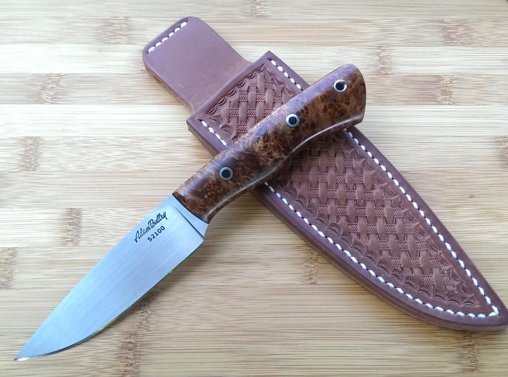

As a knife maker and user, 52100 is my favorite carbon steel. If you are a fan of 1095, O1, etc......you'll LOVE 52100. In my experience, it is easily as tough as those steels while having slightly better corrosion resistance. The best trait of this steel, is how fined grained it is. You can get 52100 screaming sharp! It's also relatively easy to restore/maintain that edge. I've also found it to have good edge stability with acute edge geometry. This hunter I did was heat treated and cryoed to Rc 60 and has a 25 degree inclusive bevel and will hold up to any task in that role.
Thanks for the info. That is one great looking blade Adam, nice job. You also answered a question that I was thinking about. If 52-100 is a very fine grained steel than it should make for fine edge right?
Grain size doesn't really have any bearing on edge sharpness. Thats carbide size.
