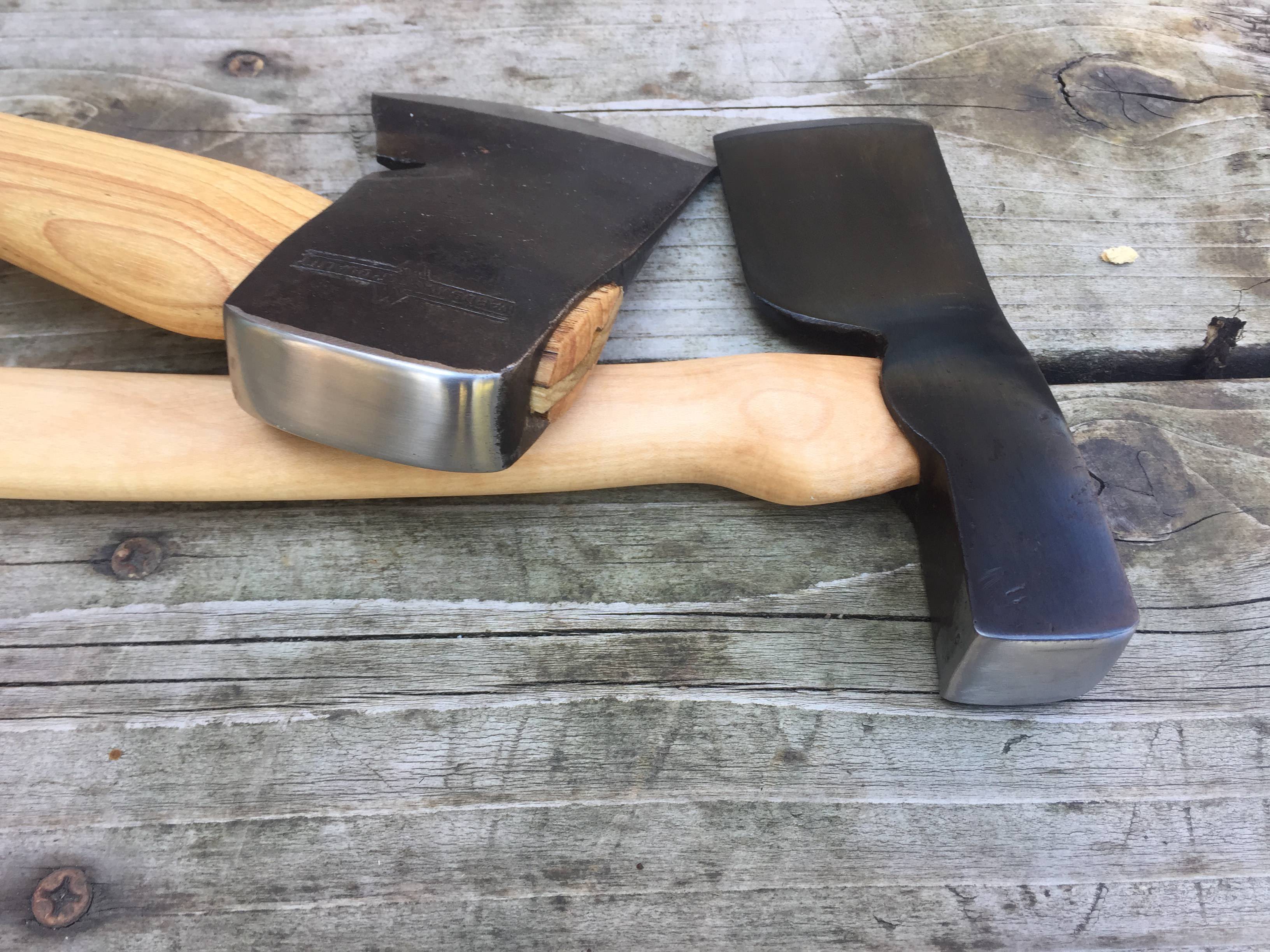

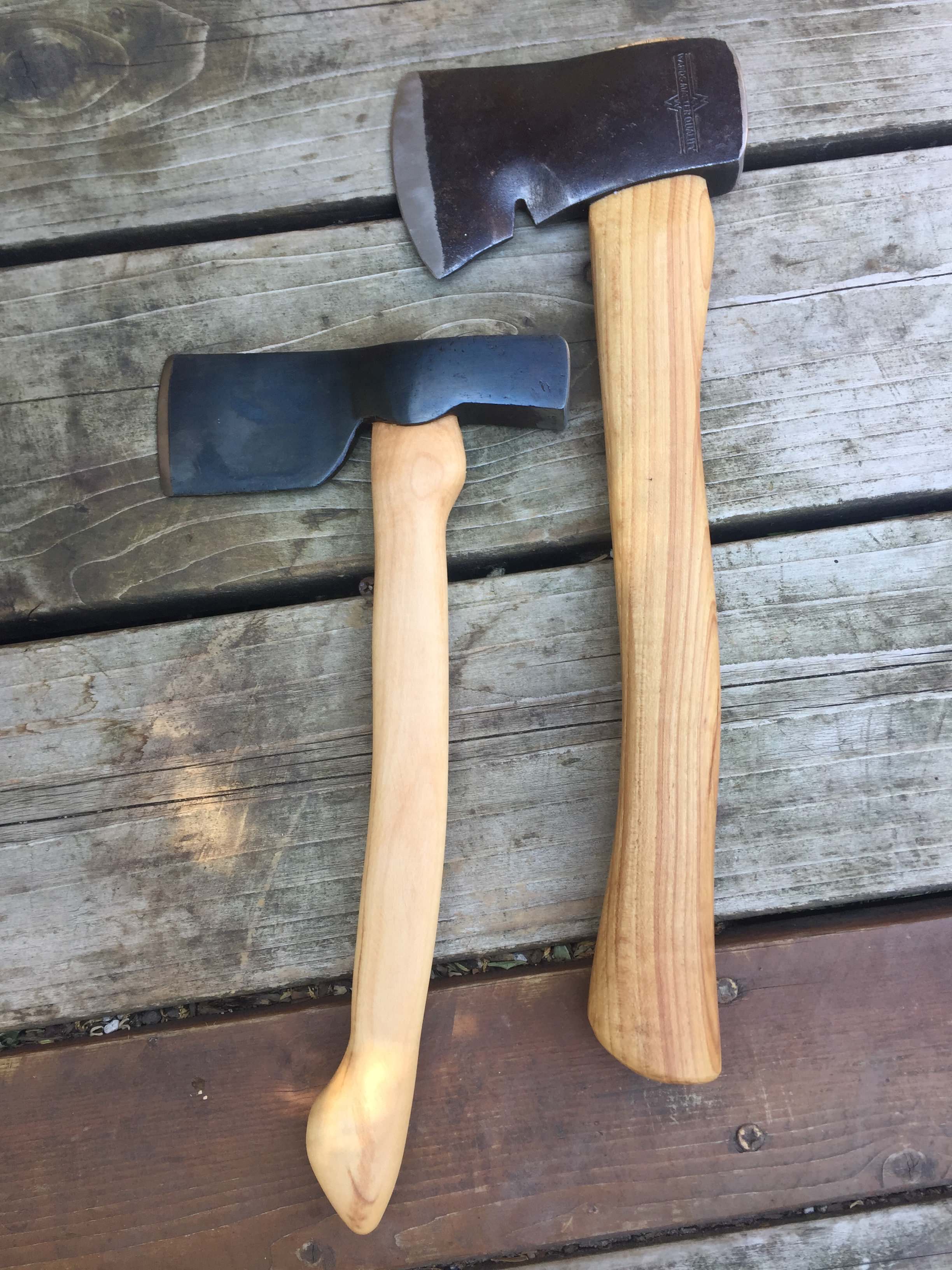

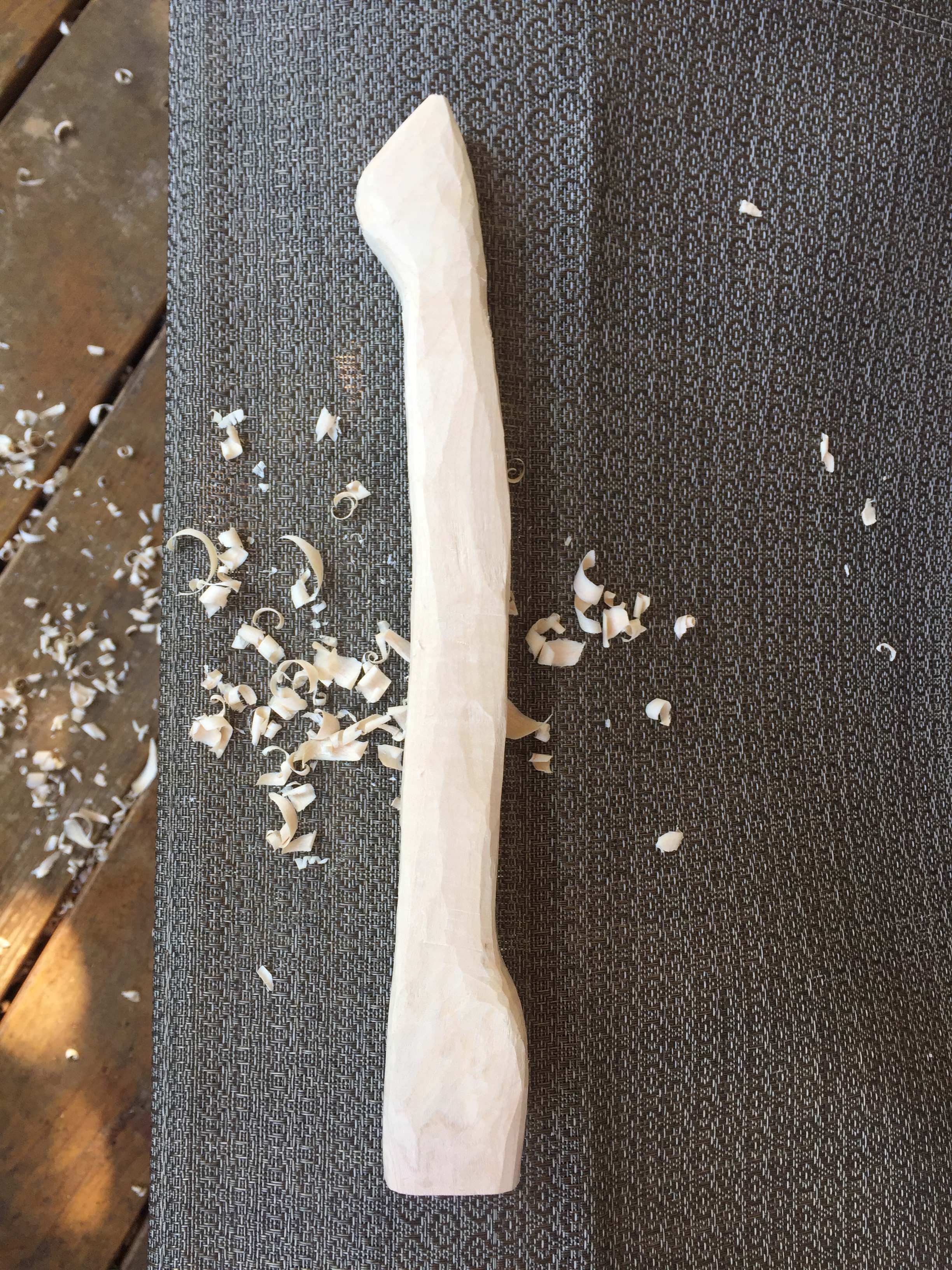

Hey all.
Here are a few picks of my first shot at "restoring" and old axe.
Most of my carpentry tools are old things I've revived and I turned to this forum when I wanted to make a carving axe and some axe handles.
[/IMG]

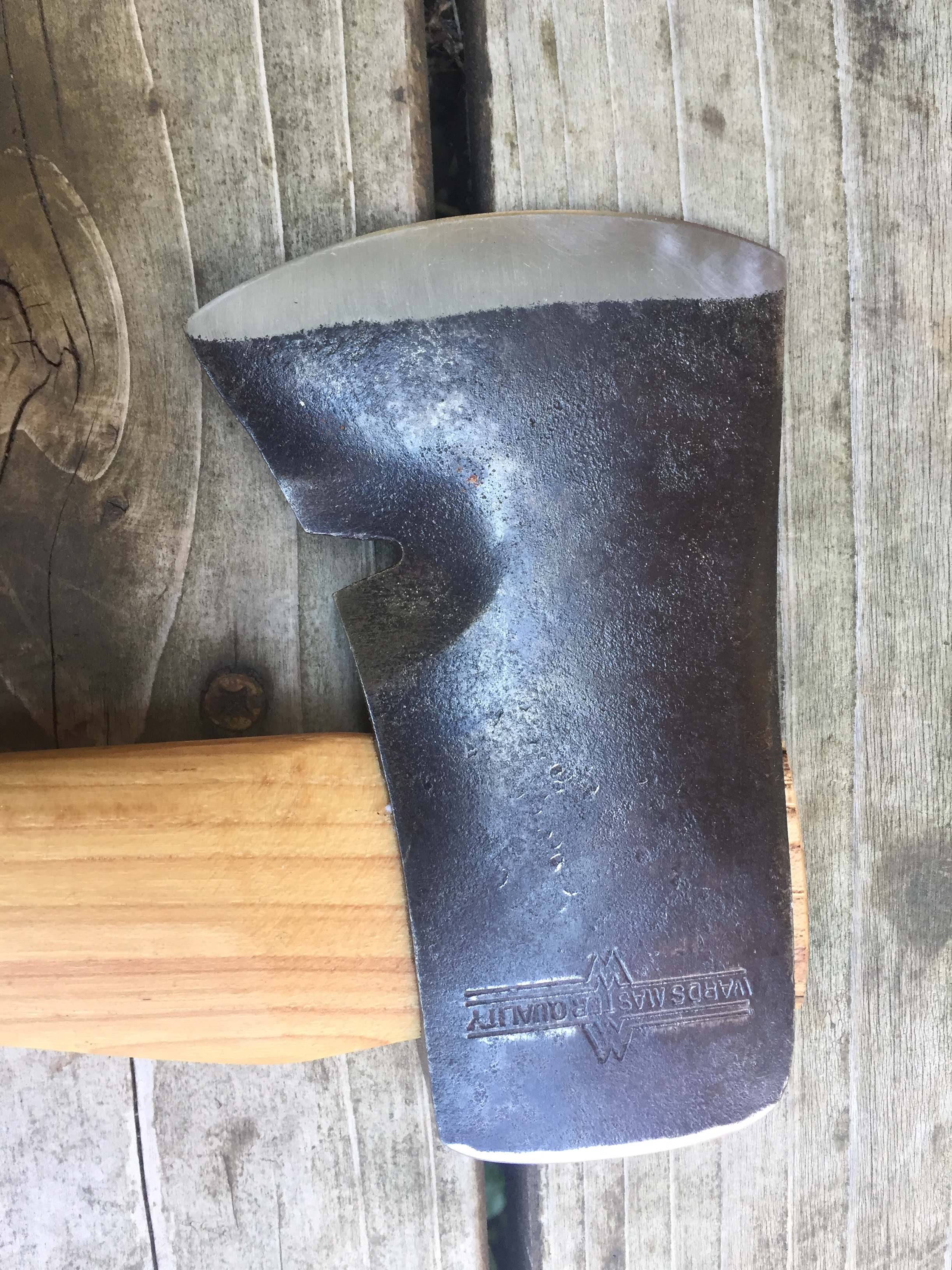

The Wards hatchet turned out to be a terrific carver!
I used it to carve to handle for the other axe above.

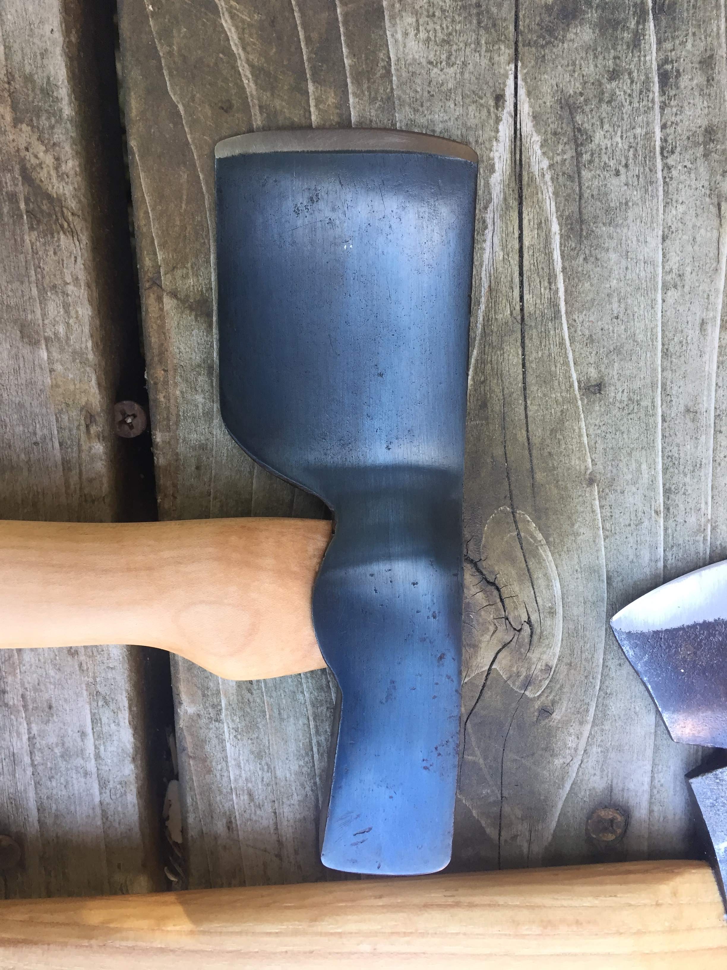

The interesting thing about the small box hatchet is the head, which was a waffle pattern and the blade edge are wrapped with steel and tempered to a very hard state.
I had to resort to my Belt sander to profile it to a shape that was usable.
The blade on that is Very hard and very sharp.
The handle turned out a little thin for my liking, but the Vaughn handles that are available for these are clubs.
Just for fun here are the before pics of the handle.
Cheers.
Rob
Lovely! You've done a wonderful (and tasteful) job of resurrecting a couple of old tools. My compliments.
Cool! I really like the look of rough carved handles - so thanks for the pictures showing the progress.
Nice little lathing hatchet you ended up with there and the Wards is a looker too :thumbsup:
That wards master quality hatchet turned out great, though I have to warn you that convex cheeks can prove a bit problematic for a carving hatchet. That's why a carving hatchet normally has the back side completely flat.
The lathing hatchet probably has a better profile for carving, but if you can use the wards to carve without issue then I commend you.
Camperspecial,excellent job on the both,and each,in it's own right,a neat old tool.Right on.

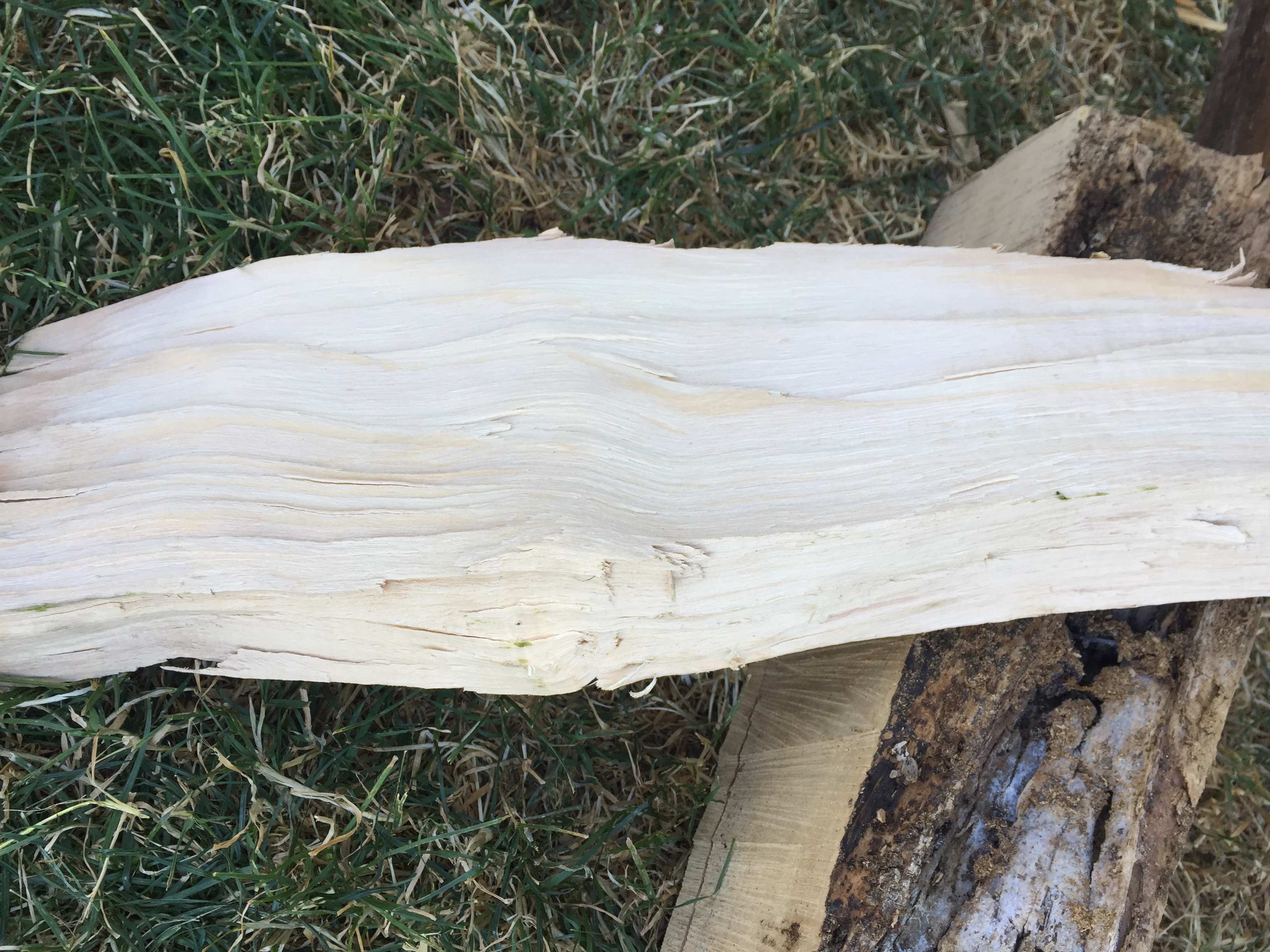

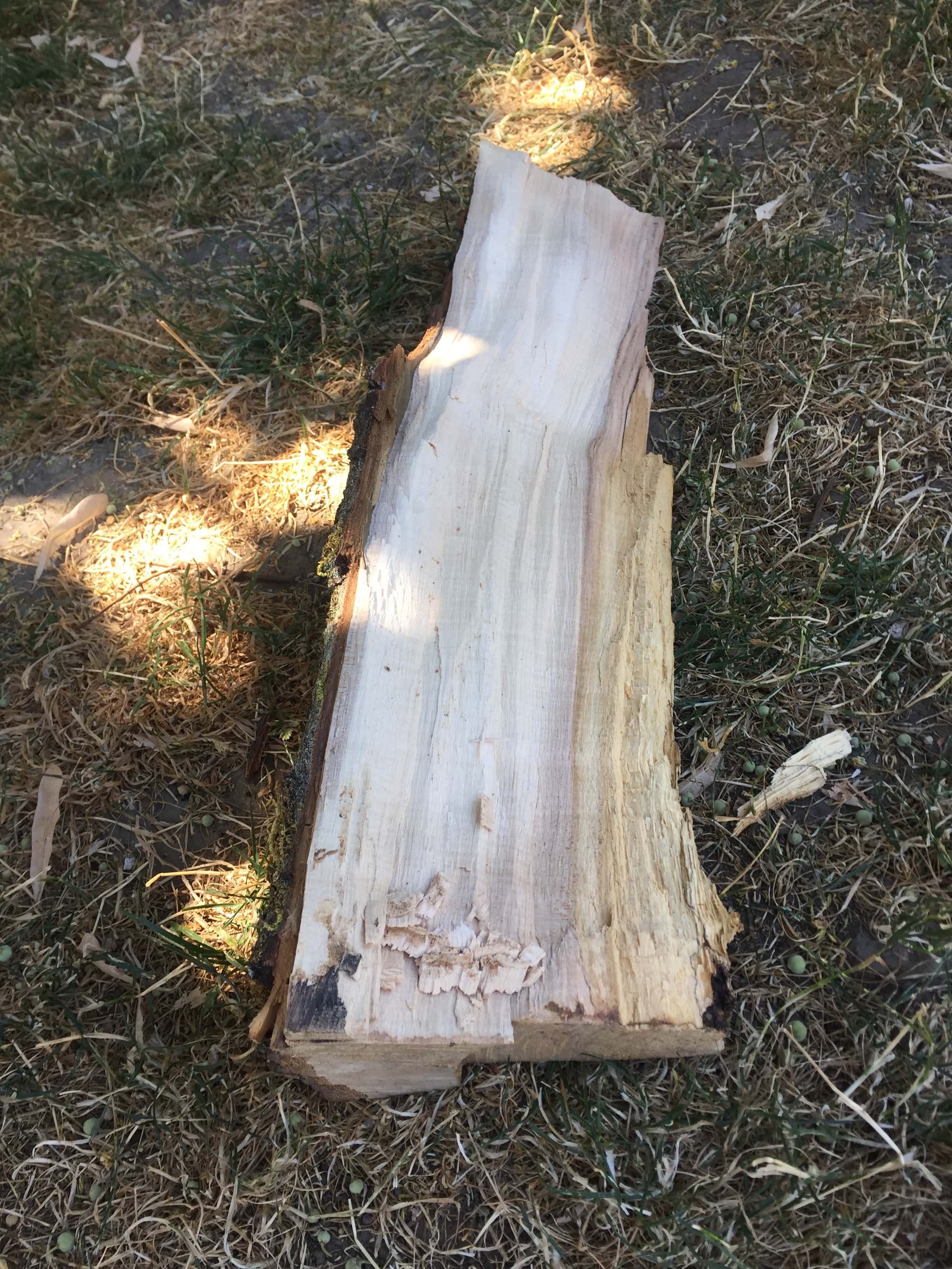

Great job on the handle, what kind of wood did you use?
The wood is from a 115 year old Norway Maple that had to come down in the city.
I got a lot of it. Mostly the highly figured stuff. If I had known I would want to start making axe handles I would have taken more of the straight grained stuff too. Oh well, plenty of trees out there.

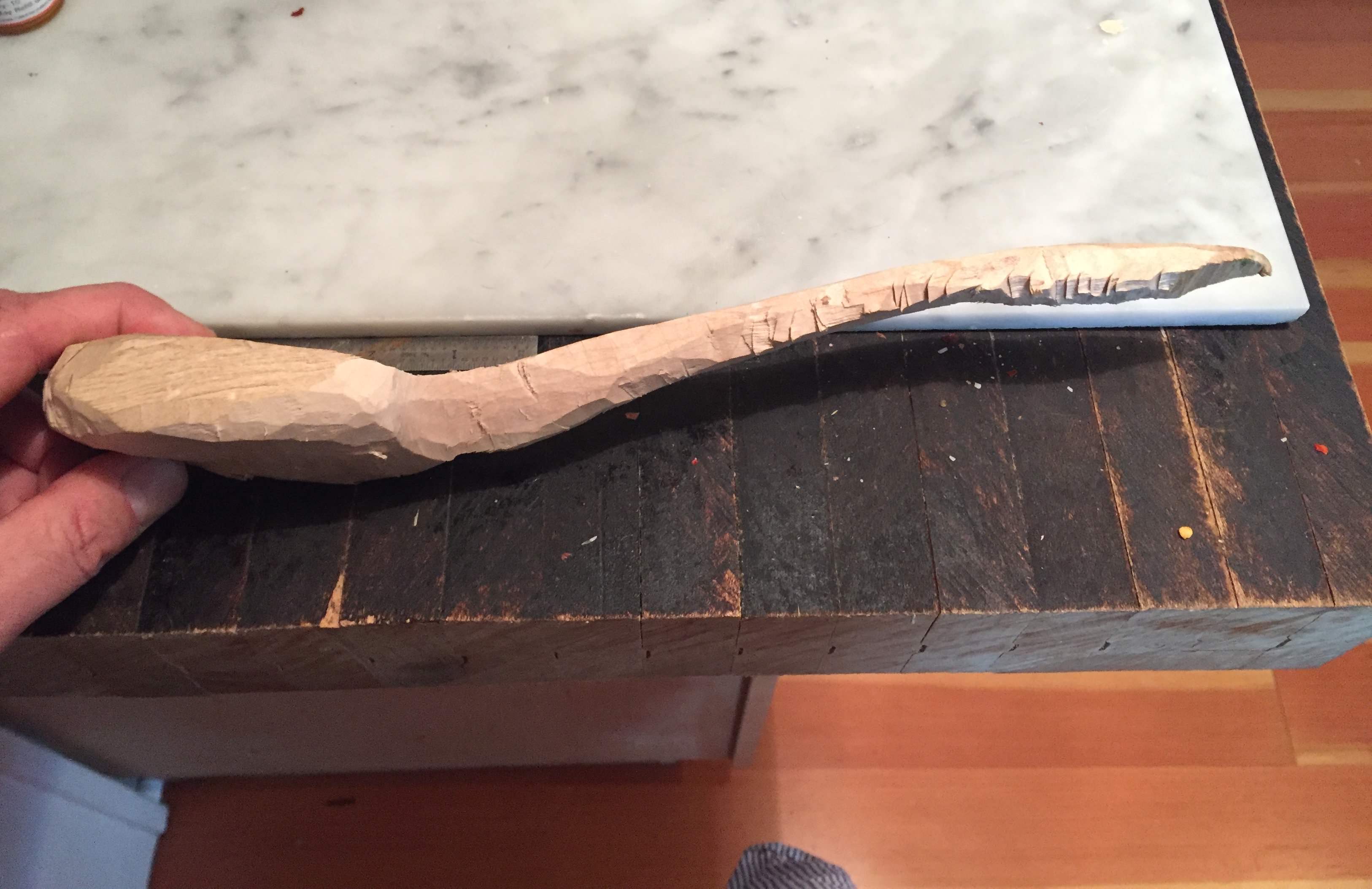

I made this spoon blank. I have never made a spoon before. This is about 10 minutes into it.
Whatever it's called is fine with me. It's great to have a new fascination after woodworking for years.

Love your work. Very skillful. Just one suggestion, if you will: I take a boxcutter or some other sharp knife and run it around bottom of the eye to clean up any bits of wood that burr up when I tighten the head.
