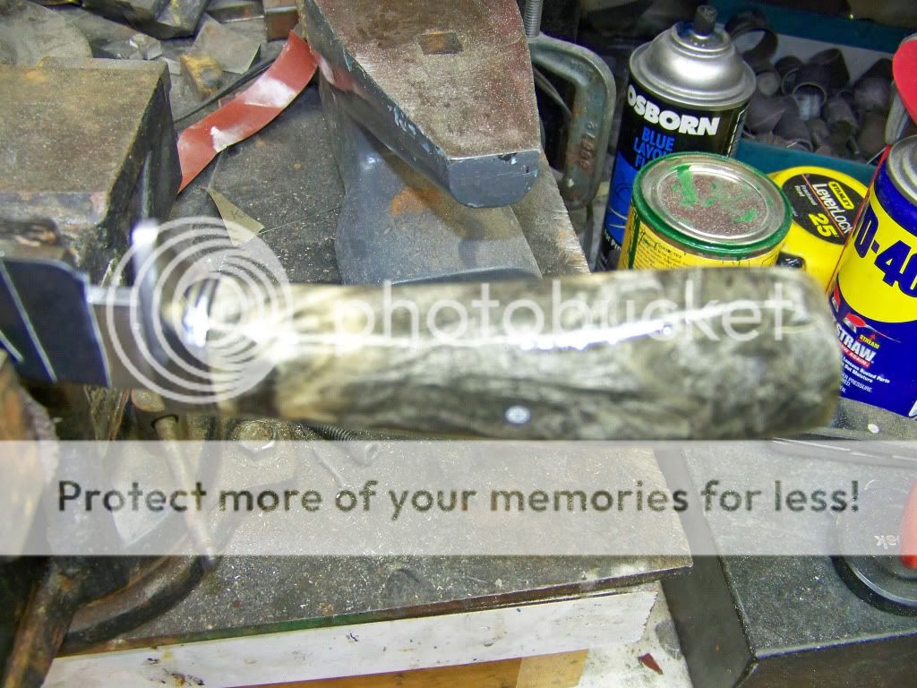

I took the knife out of the clamps this morning and will show a basic contour on the handle and guard. I use a dremel to make the radious on the spacers and guard. A round file will work too but my body is a temple and I'm not going to wear it out.

I sanded it down and put a superglue finish on the handle. It is very durable and smooth as a babys behind too.

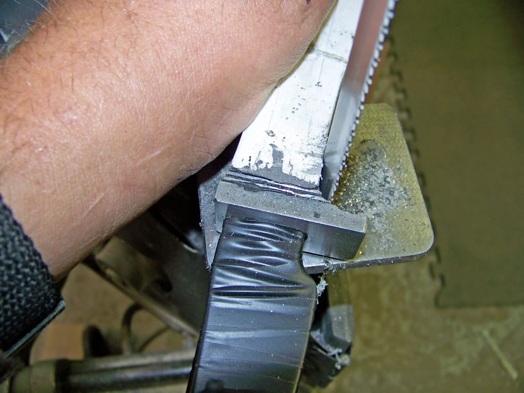

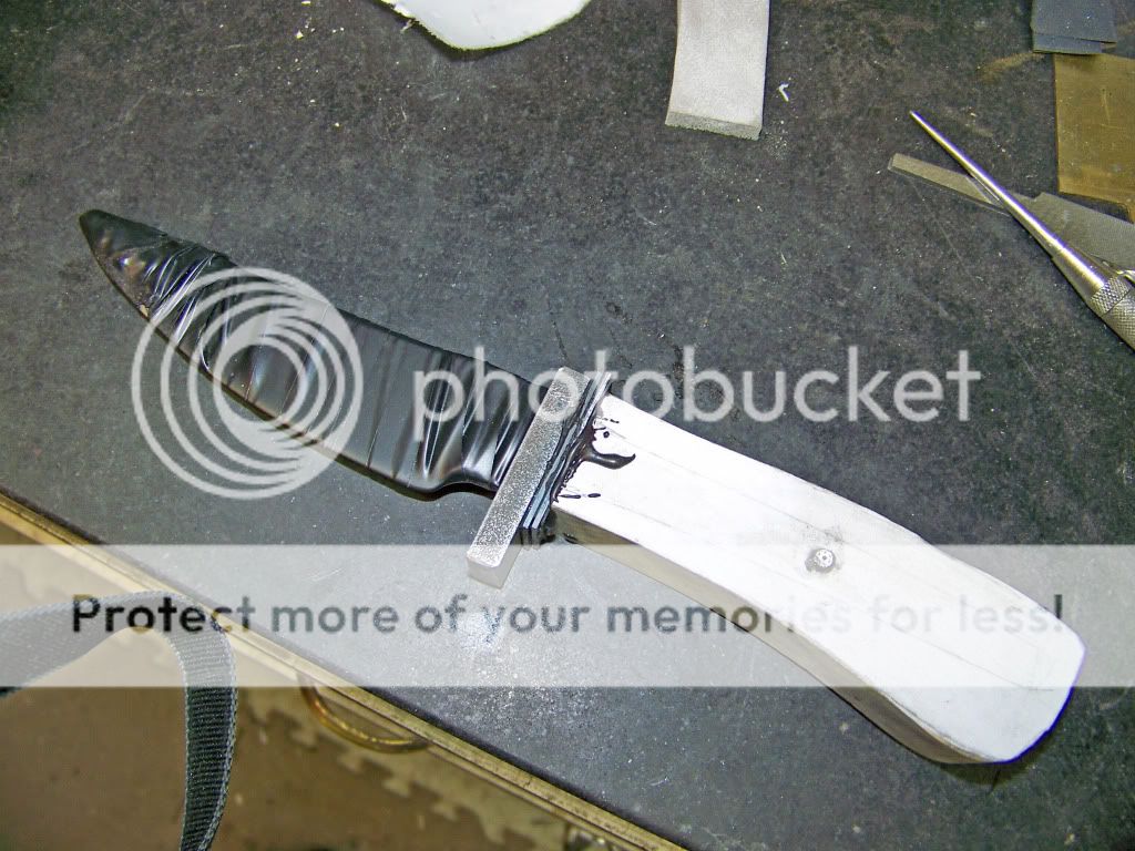

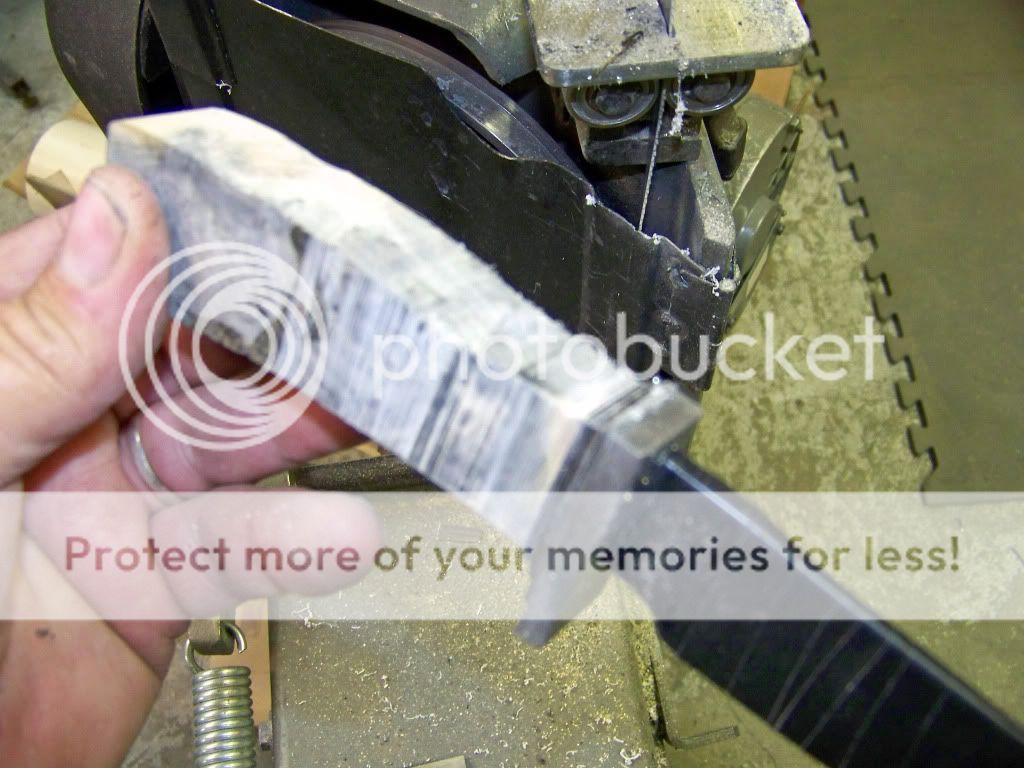

OK its out of the clamps and I take it to the metal cutting bandsaw to remove pin excess and some excess from the guard. The belt grinder would work too but slower and builds heat. Heat is bad.

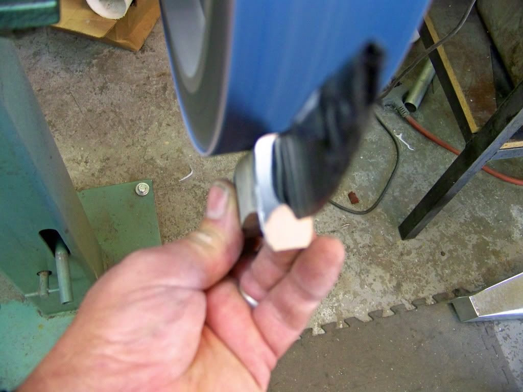

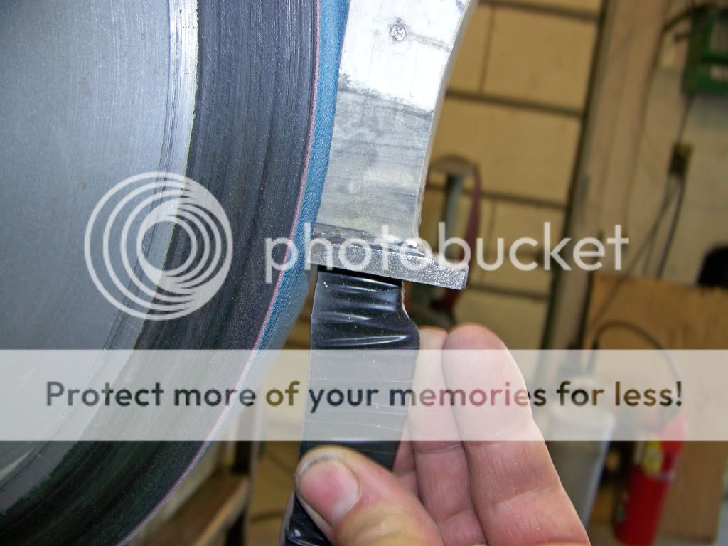

Now to the belt grinder with a new 60 belt. A new belt wont build heat. Heat is bad, I said that already.

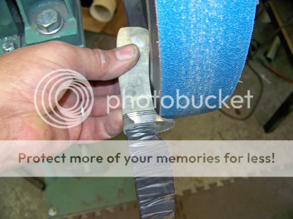

I like to get the contours of the guard and handle very close to finish shape but take care because that new belt takes off the soft wood very fast.

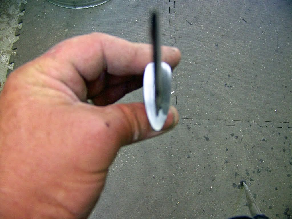

Here I am checking the oval shape of the guard

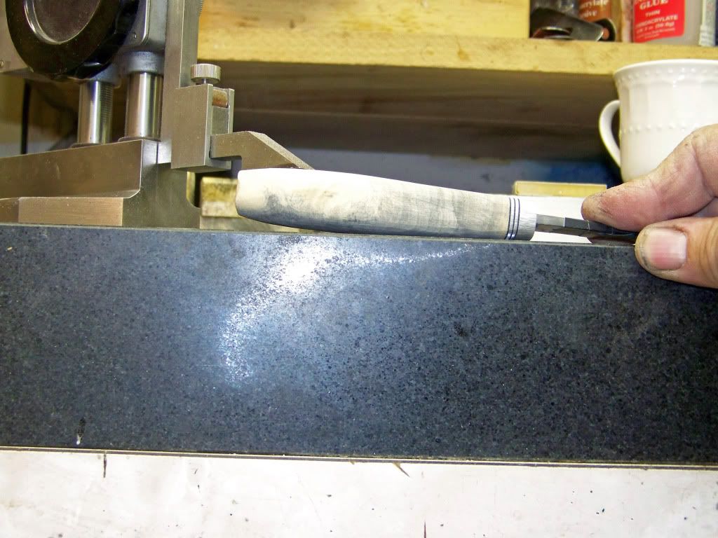

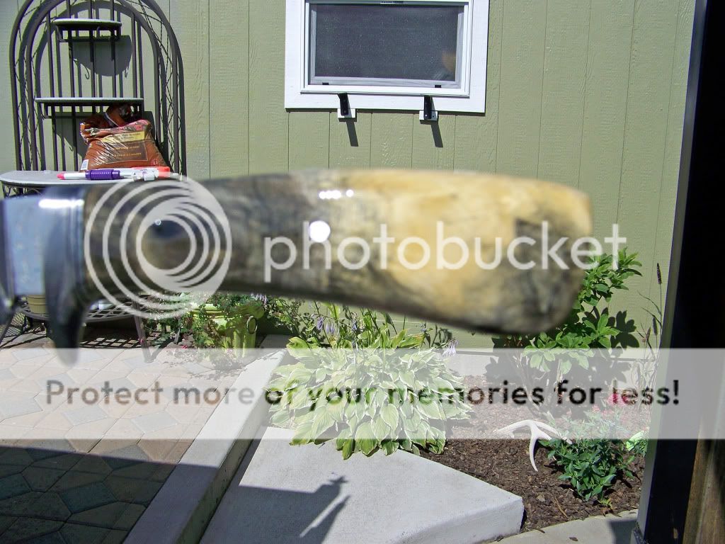

I use a height guage to see if both sides are the same. A set of calipers would do the same thing. Simply lay the knife on one side and measure the height of the handle, then flip it over and the handle should measure the same. A bannana shaped knife is noticeable so this is an important step. Another trick it to use a mirror on the flat of the guard so the reflection of the handle is visible in the mirror. If the handle is straight it will show up in the mirror. The mirror trick was taught at Josh's hammer-in by Tim Hancock. It works great for squaring a guard to the blade too.

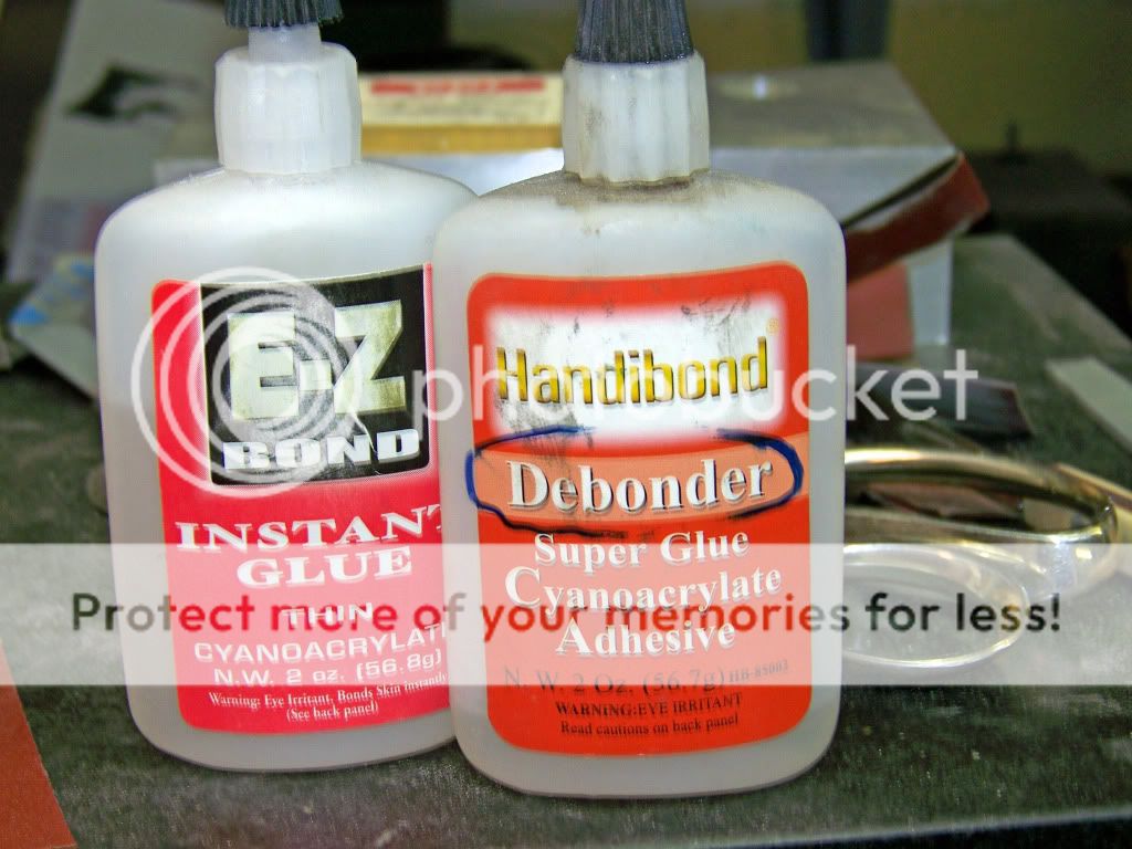

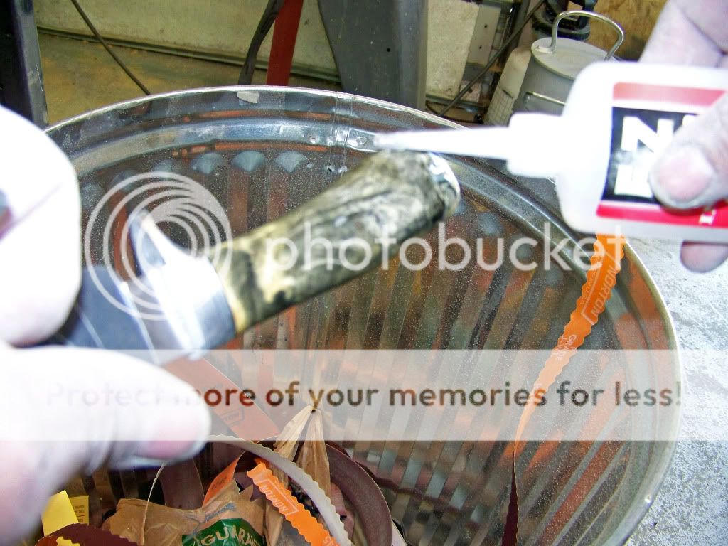

I dont know if you have seen a super glue finish before but I think this wood needs a harder shell. I am able to mark it with my fingernail and suspect it will show some wear in a couple years. I like my knives to be used but not look abused.
I sand the handle and guard down to 320 grit and pour thin super glue on the wood. It soaks in deep and needs a couple more applications letting it dry for awhile in between coats. I put 3 coats on this one. I just flood it on and rotate the knife so it covers the entire handle. It is pretty thick by the 3rd coat and the surface is very bumpy and irregular so I sand the high spots off with the 320 and flood it with Debonder and use my finger to smooth it out. I do this 3 or 4 times before it starts looking good. I put it away for the night so it can dry completely and in the morning it should be very hard and dry. It will still need some light sanding with finer grits and polish to get that deep look.

Bruce you stay up late working! I like your idea of flooding the handle with superglue. I've always just painted it on in coats, and not gotten the results I wanted. Never thought of using debonder to smooth the surface. I'll do it this way next time and see what I can get out of it. Great idea. Thanks some more. ;)
