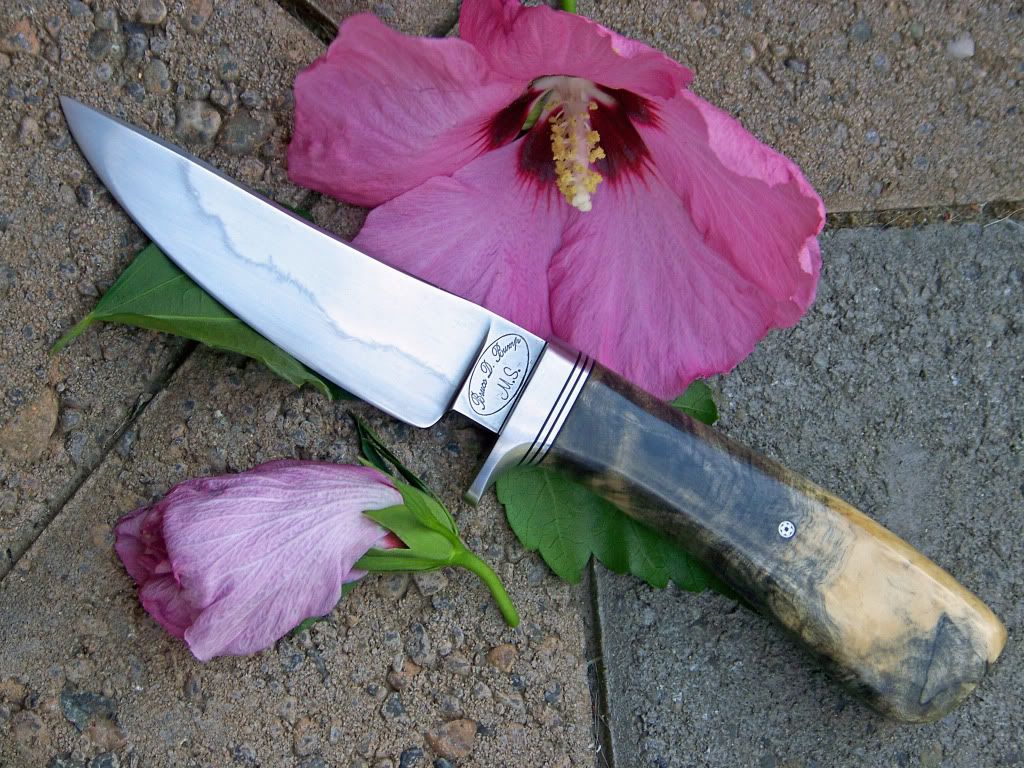

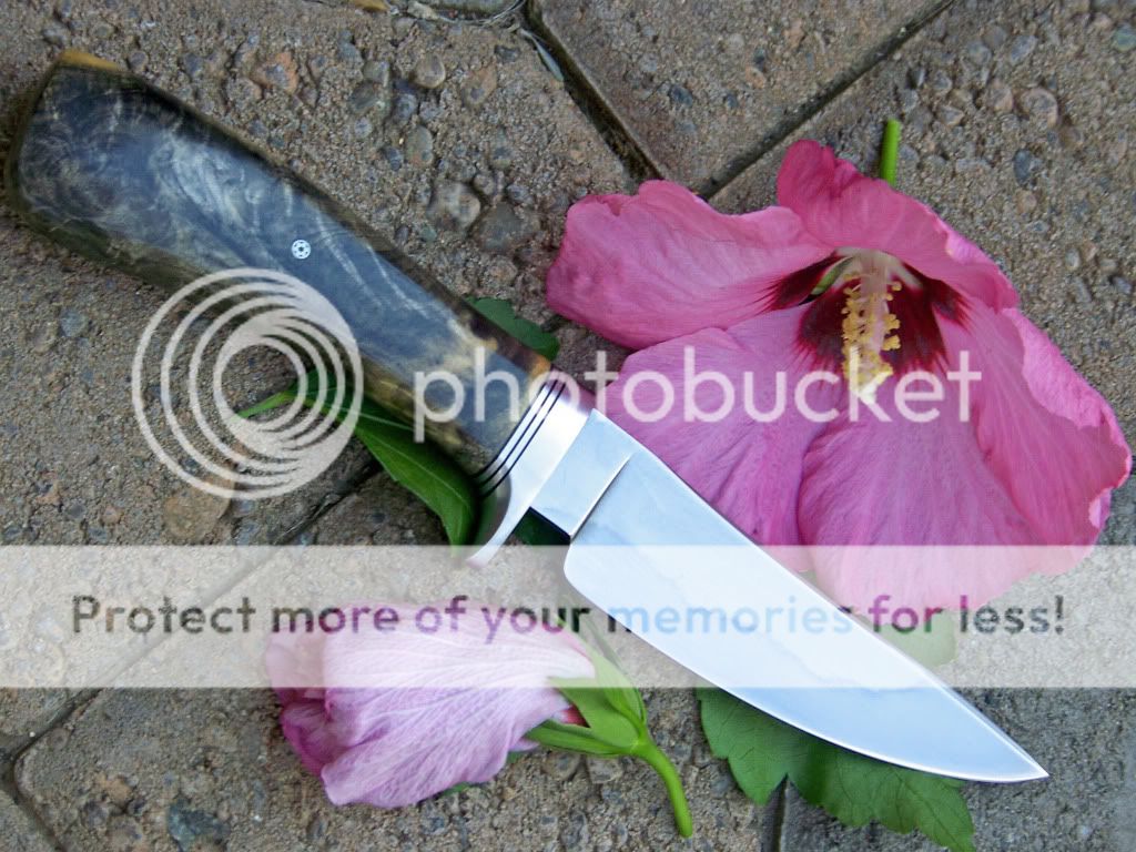

Here is the finished knife and handle.
I do like this finish because it is rock hard and can be polished or satin finished all depending on the disired look. It may be slippery when bloody but the design of the handle and a finger guard will keep the hand safe from the sharp blade. The full beauty and depth of the grain is visible.
I dont think its as difficult to do on wood as most of the other finishes. There is some question whether it needs any added finish on a stabilized wood and I think with this particular piece with the stabilizing process used it benefitted from the added hardness. I dont like the fact that my finger nail could leave an impression as it was. Some hardwoods are so hard they cant easily be scratched but this buckeye burl was light in weight and too soft for me.

Stabilized woods can still be softer than I like. Redwood seems to be the softest and lightest in weight. This one was stabilized by Burl Source and is actually a free piece to try. I talked to Mark after I did the CA treatment and he said a few of the Buckeye Burls got out lighter in weight and has an improved method now. Its probally just me but I like em hard and heavy. Not all wood is created equal. Actually some of the stabilized wood cant show its real grain beauty. This one looks really deep and clear. The pictures cant do it justice.
