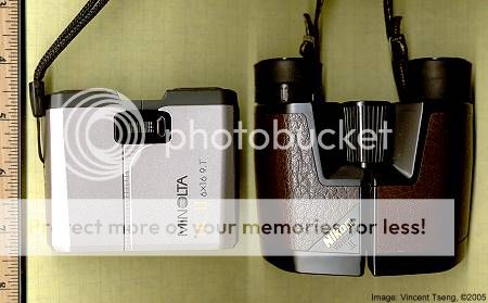

just for fun I decided to compare "test" the compact binoculars I have -
"quality"
Nikon Venturer II 8x23 compact
Minolta UCII 6x16 ultra compact
"cheapo"
Sakar "Ruby lens" 8x21
Simmons "8-Point" 10x25
I used a Patterson optical test target - illuminated with a standard 60watt "soft-white" in a desk lamp shade (flared-cone white internal like a reflector) set 3feet away.
I noted the distance when I could just make out the finest lines clearly on the black/white target panel (that usually meant the red and green panels were also resolved - I had difficulties resolving the blue panel as well).
These were the distances for resolving the test target -
Nikon 19ft 4"
Minolta 13ft 9"
Simmons 18ft 6"
Sakar 17ft 4"
The Nikon Venturer II are 8x - so corrections have to be made for different magnifications
Minolta 6x correction factor = 8/6x
Simmons 10x correction factor = 8/10x
So "normalized" corrected distances as if they were all equivalent 8x magnification -
Nikon 8x23 = 19ft 4"
Minolta 6x16 = normalized 18ft 4"
Simmons 10x25 = normalized 14ft 10"
Sakar 8x21 = 17ft 4"
If we use the Nikon as 100% resolution then
Minolta 6x16 = 95%
Simmons = 77%
Sakar = 90%
Th Sakar (makers of Sakar camera lenses) "Ruby lens" 8x21 seems to fair very well for a pair of $20 binoculars - until one looks through them - the image is very blue-green tinted - horribly so in fact - this due I think mainly to the fancy-shamsy "Ruby coated" lenses -
Objectives:
since the "Ruby lenses" reflect red/orange part of the spectrum - the complementary (opposite) color left is cyan - which is blue-green hence the strong UNacceptable color cast.
In isolation one may be able to tolerate the cast as the brain compensates for it - but it is immediately noticable on first viewing through the binoculars - and absolutely UNacceptable when compared side-by-side with more quality binoculars.
The Simmons has a very dim looking image which lacks real crispness. In comparison the Nikon's image almost jump at you looking really 3-D.
The Minolta does really well for such ultra compacts - nomally smaller objectives mean less resolution - in theory the Minoltas should resolve in the order of 16/23x = 70% that of the Nikon - the fact it managed 95% is a good indication. Compared to the Nikon the Minolta's image has less snap and there is a slight yellow cast/tint - but it is amazingly small - and for its size does really surprisingly well........
Vincent
