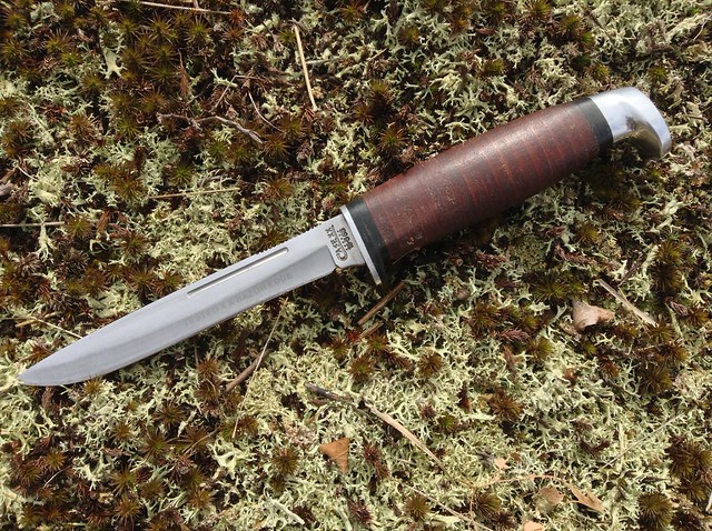

I've improved the all around slicing ability of a few of my hollow ground knives by taping the edge and then flattening the shoulder of the spine on a stone. Here are 2 and you'll note the rounded shape of the top of the grind where the shoulder has been flattend and moved towards the edge.
Case 316-5 (drop point) by Pinnah, on Flickr

It's been interesting to put the Case 316 up against my Opinel 8, 9 and 10 up against each other in the kitchen. The flatten 316 generates friction in some foods in a different place than the convex ground Opinels. The Opinels introduce some friction earlier as the convex is closer to the cutting edge while the 316 puts the (remaining) friction up higher. Obsessed With Edges (David) noted that he felt that some foods formed some suction on flat/convex blades that a flattened hollow grind avoids. I would say that my 316 does a slightly better job with juicy apples than my Opinel 8 does. Overall, I like the Opinel better which is one reason I prefer the Opinel for EDC use over a hollow ground blade like, say, Bucks. So, there you have it.
