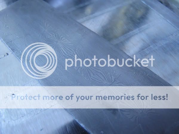

This time, it was based on an peice of Ed Schempp damascus steel. 1084/15n20 Turkish Twist Damascus with a core of radials.
Anyways, here we go.

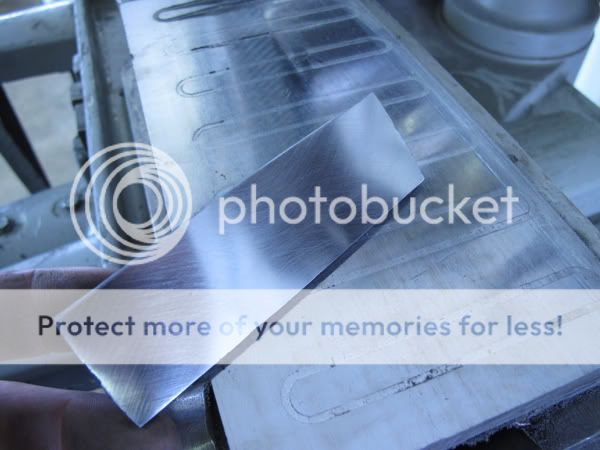

Starting with the blank steel.

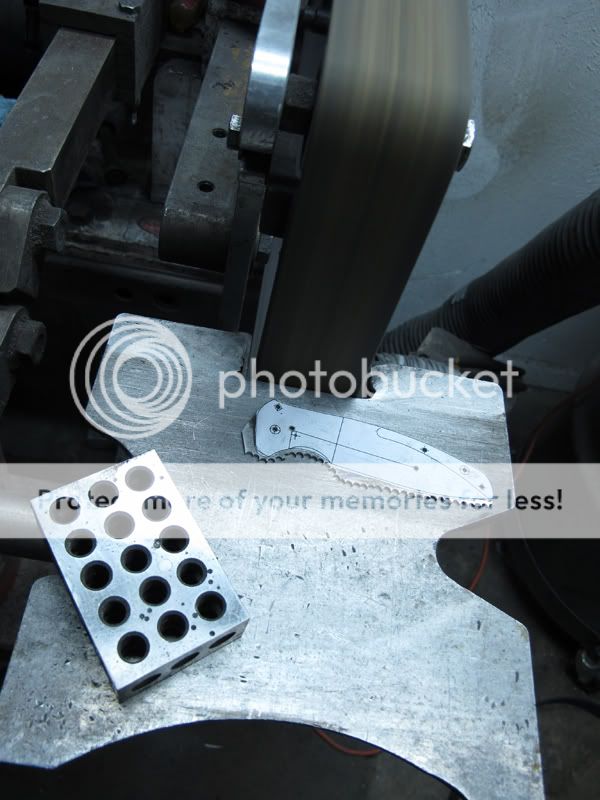

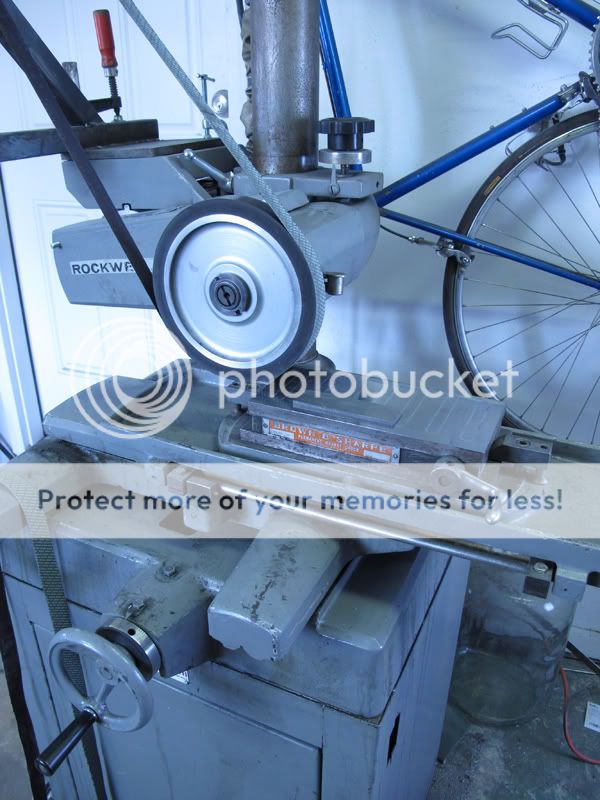

Gotta get it flat.
Off the Surface grinder, and cleaned up on the disc.

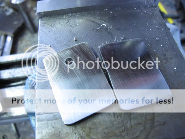

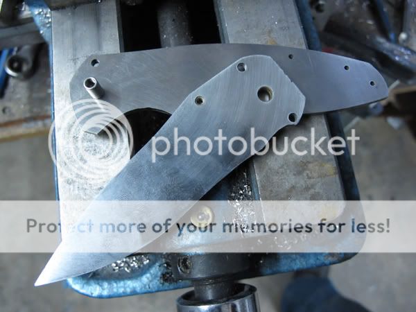

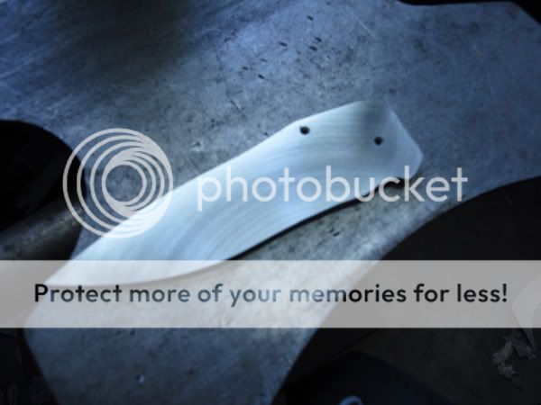

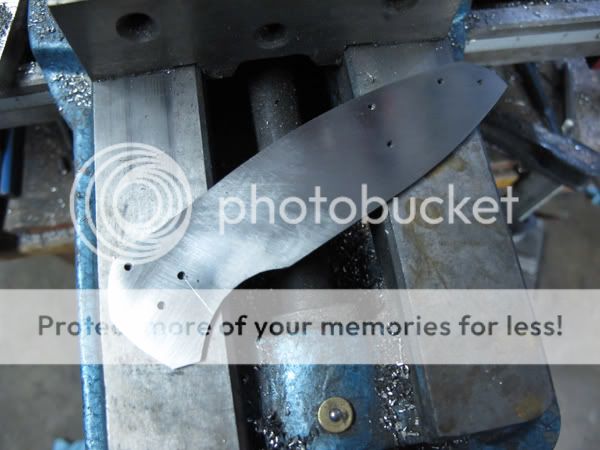

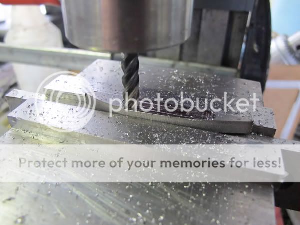

It seems I forgot to photograph anything else on the blade till it was profiled and spot drilled. So, here it is!

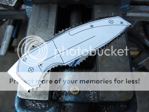

Old school style cutting of titanium. IE Drill a bunch of holes. Pattern layed out on titanium liners.
Holes drilled, profiling.

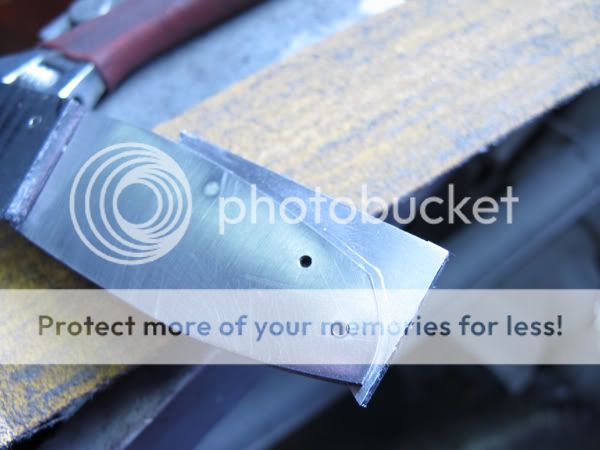

Basic profiles done and ready, stop pin locations set on blade as well.

I wonder why not cut the Ti? I figure the way you did it is how it must be done
Looks great so far, thanks for taking time to do this, especially when you're crazy busy preparing for the Blade show...
Cool Thread
I dont have a good method at my own shop to cut titanium, so although its an odd and annoying method. I can do it at home... hench holes, lots of them. Its actually really quick.
Just get a 14 teeth per inch or more for your band saw if you have one and away you go, real easy like. I usually use a high speed band saw but had a guide break on me and have gone to one with trhe regular speeds of cutting.I hope this helps. . It does a good job as well. Frank

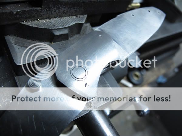

Time for some bolsters.
Backspacer time!
I really wanted some pivot rings around the pivot, and pivot screw. I wander how many times I can use the word pivot in a sentence.
Started to shape the bolsters, and cut the bolster shape.

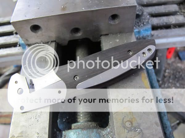

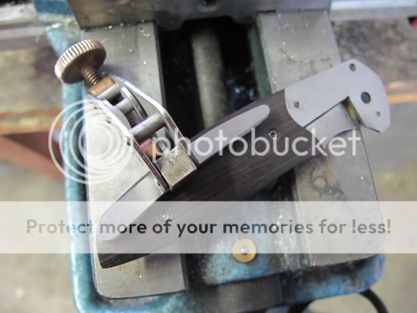

Got alot done yesterday and it seems my camera either wasnt working right or I screw something up, but it didnt take any of the photos of making the scales, or heat treating the blade. But alas, I did get some!
So, cutting the lock!
After heat treat I barrel lap the pivot out to perfect size, it also leaves silky smooth finish.

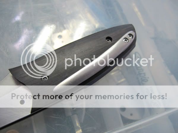

Time for a pocket clip!
starting to get it shaped correctly.
You can also see the lovely Macassar Ebony scales I made for it.
Ready for some anodizing. I also tapped the pocketclip into the backspacer for a extra strength.

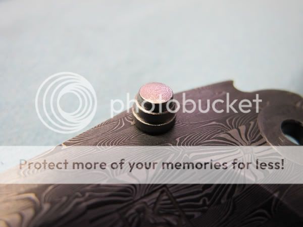

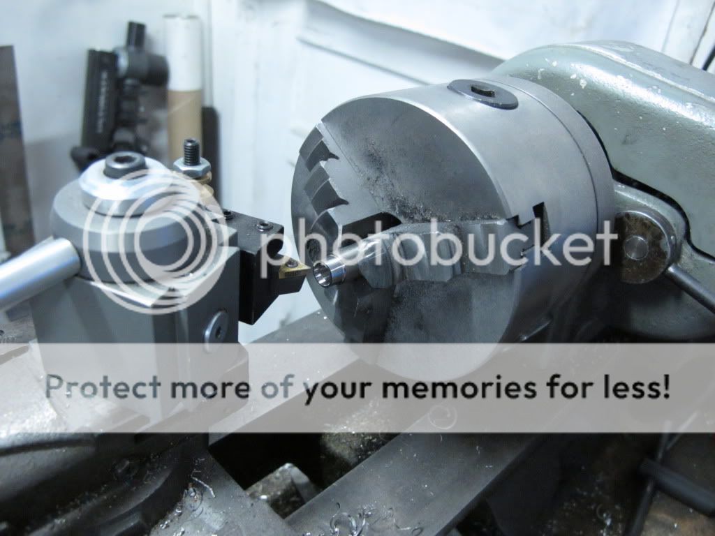

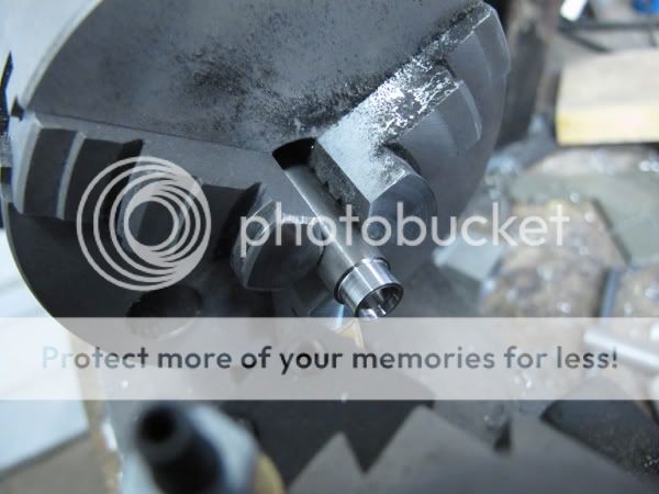

Doing some turning on the thumbstud, and a little preview pic.

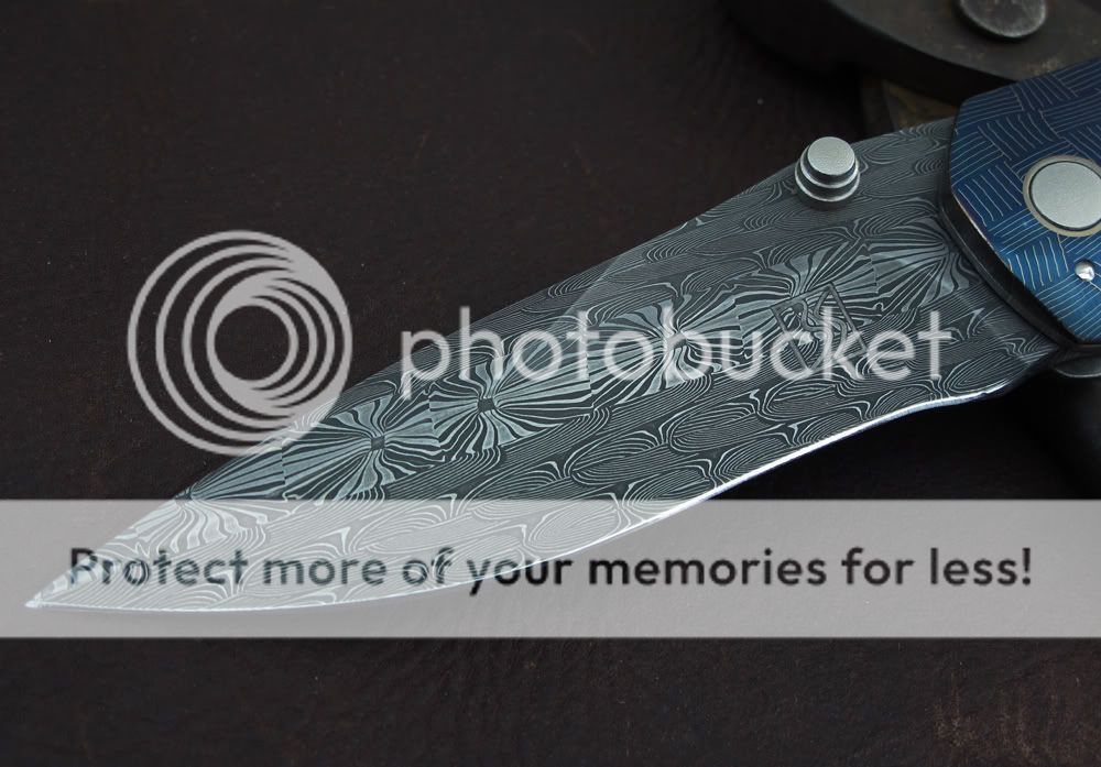

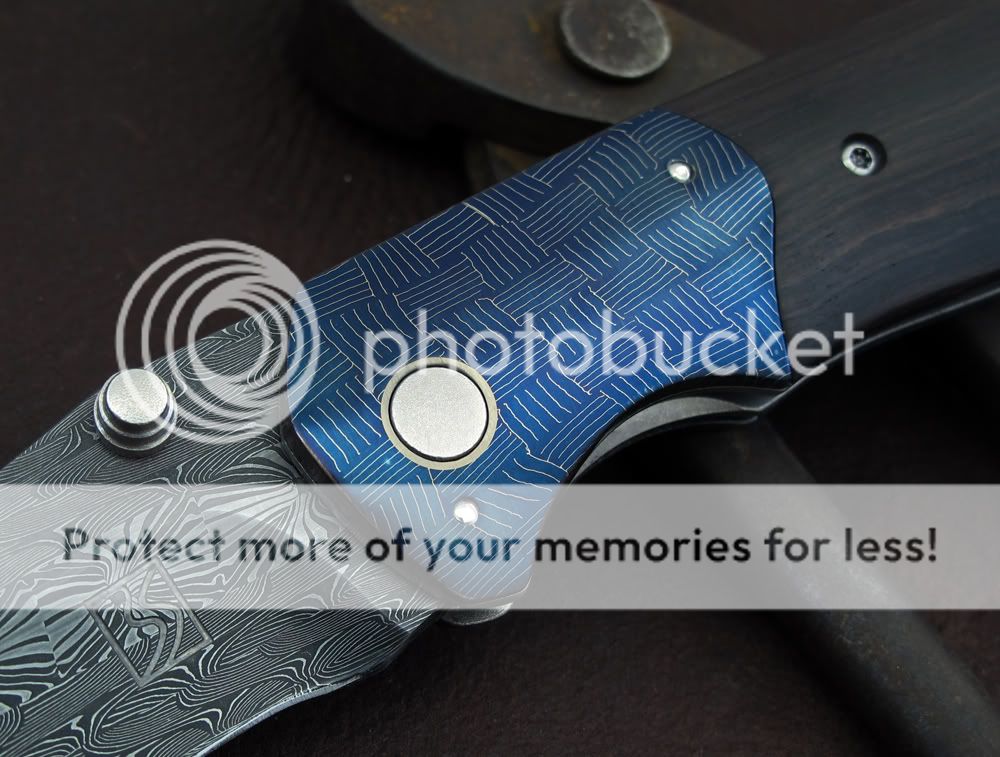

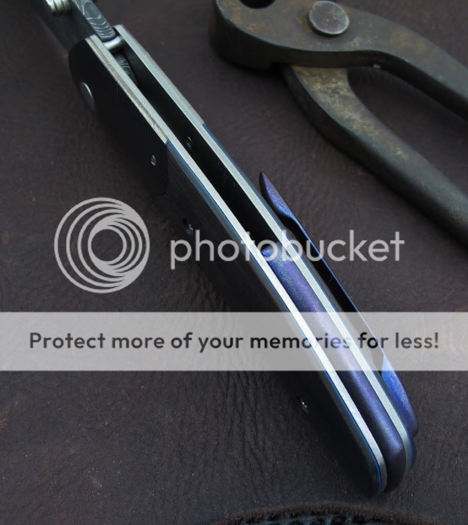

All finish!
Let me know what you guys think!
Ed Schempp damascus blade, Chad Nichols Damascus bolsters, Macascar Ebony scales, titanium linerlock, with titanium backspacer and clip!
