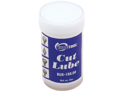

First off, let me state that I know as well as anybody, that the concept goes against "the accepted" wisdom. All the old literature, and all the casually repeated information by everyone that's ever heard a "thing or two" about file work says its a no no.
I love using files, and find them faster than the various grinders for a lot of work. I'm slowly amassing a large collection of hand files, including a couple sets of Vallorbe Valtitan needle files, and a handful of Valtitan hand files, and whichever other Vallorbe Grobet/Habilis, American old stock Nicholsons, and Germans I can find.
I reject the idea that files are short life consumables, and I believe they can give years of heavy service with proper care. I've always wished I could lube my files to help prevent rust, since I'm in a really humid environment, but I started using a desiccant in storage which has removed that concern. Still, I've often questioned the proliferated wisdom of not lubing files, and I've met some old machinists that disagree with that notion entirely. We lube all other cutting tools to extend life, why shouldnt we offer our files the same treatment?
I know the idea is that it will promote clogging and pinning, but that really doesn't add up. Recently I've become aware that many jewelers regularly lube their files with a product called Bur-Life, which RioGrande promotes.
I can see how lubing your files would cause you problems with "chalking" but to be honest, I've never found chalking to be useful, and frankly, I have very little issue with clogging or pinning on *properly* broken in precison files anyway. Admittedly I use seperate files for steel vs soft metals. I've also met old timers with serious experience that swore chalking was predominately urban legend also.
So, sorry for the long winded post, but i'd like to hear from those that *know*, with years of hand file experience, what your thoughts, or well reasoned beliefs are on this topic. I'd prefer we refrain from the "so and so said it so it must be true", especially in regards to literature being printed by companies (that make files) who have a vested interest in products being repurchased as often as possible. I'd really like to hear from Europeans that were traditionally taught if there are any floating around, since there are a lot of cultural differences in files and their use between the different hemispheres.
FWIW I spent the last couple of days doing some heavy filing skeletonizing tangs with a new (Brazil) Nicholson file that I broke in well, and kept lubed. Its a courser round file, no apparant deterioration of functionity, and honestly, much better than I was expecting from the source.
When I thought about it, the logic behind chalking doesn't really make sense- to my thinking, it would just encourage gouging by forcing filings to the top of the file rather than letting them push into the recesses. I never tried it, so I can only guess at it's effects. I've tried WD-40 and light oils as lubricants when filing, and while I can't really attest to any benefits, it did have a tendency to trap filings on the surface of the steel, causing gouges, though it did prevent any instances of the file sticking.
I guess that is a concern, lubricants could keep filings attached to the file versus casting them. I didn't notice much of that with the courser file, but I always smack the handle down and wipe the file with a cloth every handful of strokes regardless.
I could see how sticky filings could be more of an issue with finer cuts and needle files. Which is why I haven't tried it with any. Seeing info about jewelers using lubricants on needle files however, is what made me really want tto revisit this. Are they just misinformed? Is Rio Grande promoting a product at the expense of their customer's best interest or is there something I'm missing?
I forgot to mention, the only time it really presented itself was on wide, flat areas, i.e. bevels. Going straight over the cross section always gave me clean cuts. I imagine this wouldn't be a problem with jewelers given the much more intricate, and as a result small nature of their work.

I have never lubed a jewelers file, nor know any jeweler who does. I never lubed any other file either. I have chalked bastard files from time to time, mainly when working brass and copper. I know a few old timers who chalk their files, but most don't seem to do it.
Burr-Lube is for saw blades, drills, and burrs in my shop.

I like to use a dry film tool spray lubricant. It's sorta like tuf-glide aerosol, not your typical white teflon film dry lubricant. I don't remember the brand name right now but it keeps the rust off the files when they're stored out in the shed and doesn't leave a visible film. Other than that I haven't used chalk or anything, nor do I lube during filing, just brush out any debris with a brass cleaning brush.

I've used this (or other brands similar) daily for 35 years...
http://www.cooksongold.com/Jewellery-Tools/Burr-Life-Lubricant-prcode-998-021

I still use files for the majority of my bevel refining. I have tried 3in1, WD-40, Mobil, chalk, charcoal and silicone lube... Nothing was better than applying good technique. I do make one exception and that is using soapy water as coolant when doing any heavy draw filing. The work piece gets hot to the touch and there is no doubt in my mind that the teeth are subject to unwanted tempering.

Stacy; Ok, I know you're well plugged into the jeweler scene, so I guess the Bur-Life promotion of lubing files is just shameless oon their part. I did read a few "blogs" that mentioned lubing their needle files with it, but they did seem novice.
