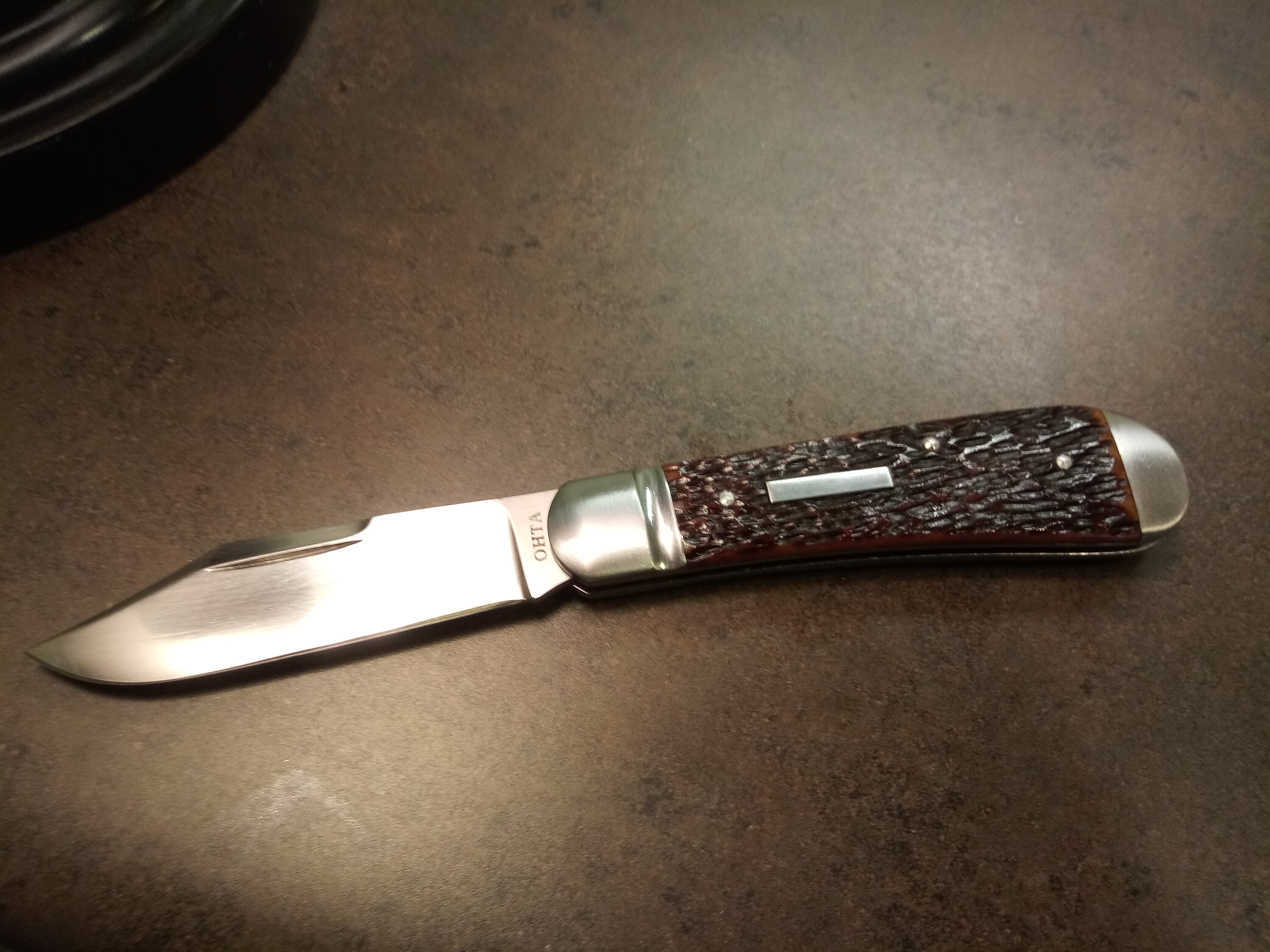

So about 3 months ago I purchased my first Ohta thanks to some recommendations on here..it is a stag wharncliffe with thin liners and absolutely stunning handle to blade transition that I admire every day...I had such a good experience with that knife (my profile pic) I went ahead and purchased an Ohta LC this dealer also had on his site the following pay period (yeah I have a problem)...it was 350 which seemed like a steal at the time. It is indeed a beautiful knife as well but upon recieving it I noticed two bummer flaws that were not just OCD knife collecting nit picks. Now I'm sure the dealer would have refunded/accepted the return of the knife but it seemed nice enough to warrant sending to Mr Ohta if he was willing to look at it...he responded back to my inquiry and said yes but that he'd need me to send it to Japan mid-June as he is busy until then. I'm just happy he is willing to fix it.
Here is the knife.
So for the problems...

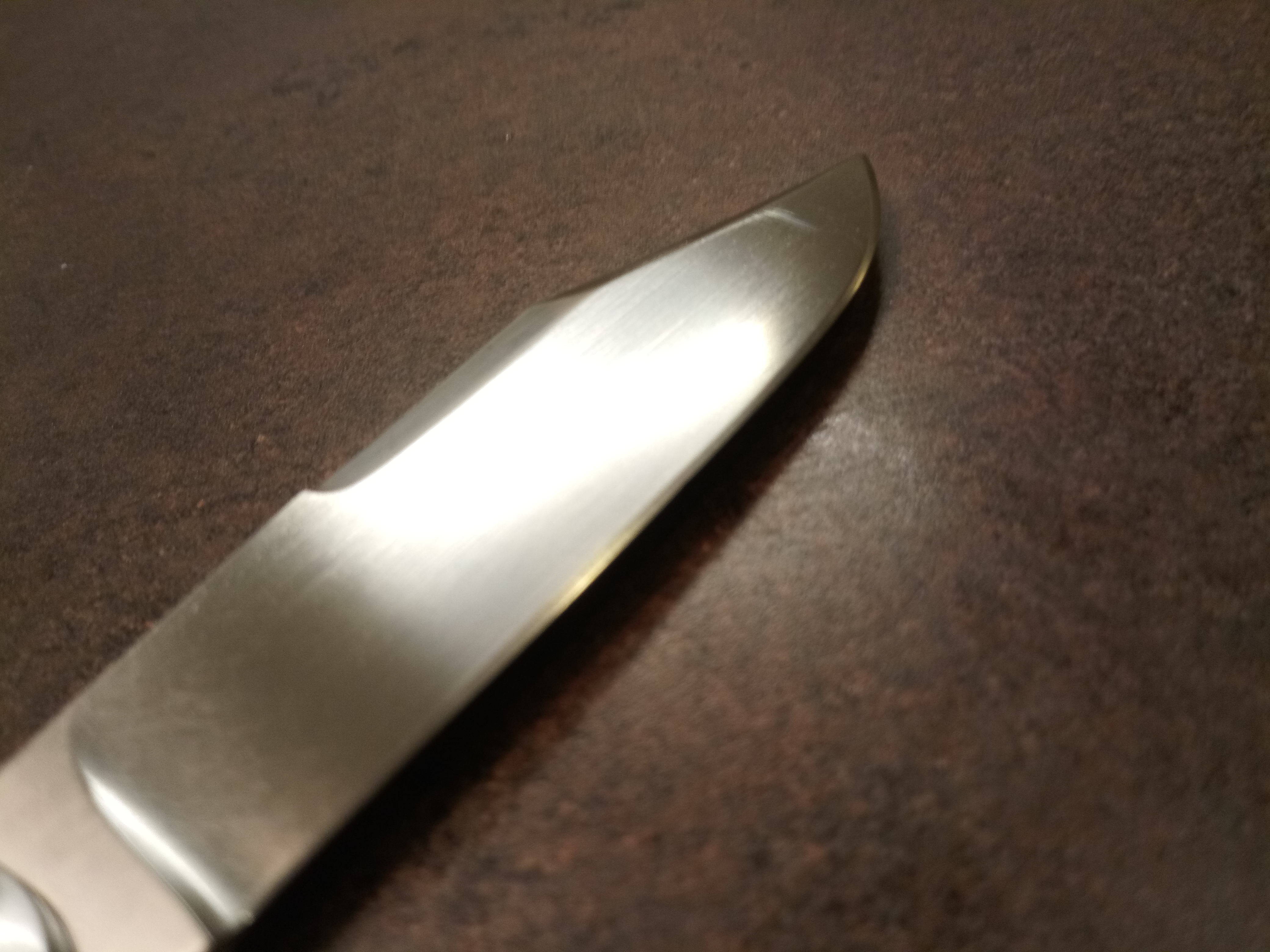

The blade is off center causing the blade to rub on the liner putting scratches across the hand rub finish...(bound to happen from use regardless I can live with it but disappointing).

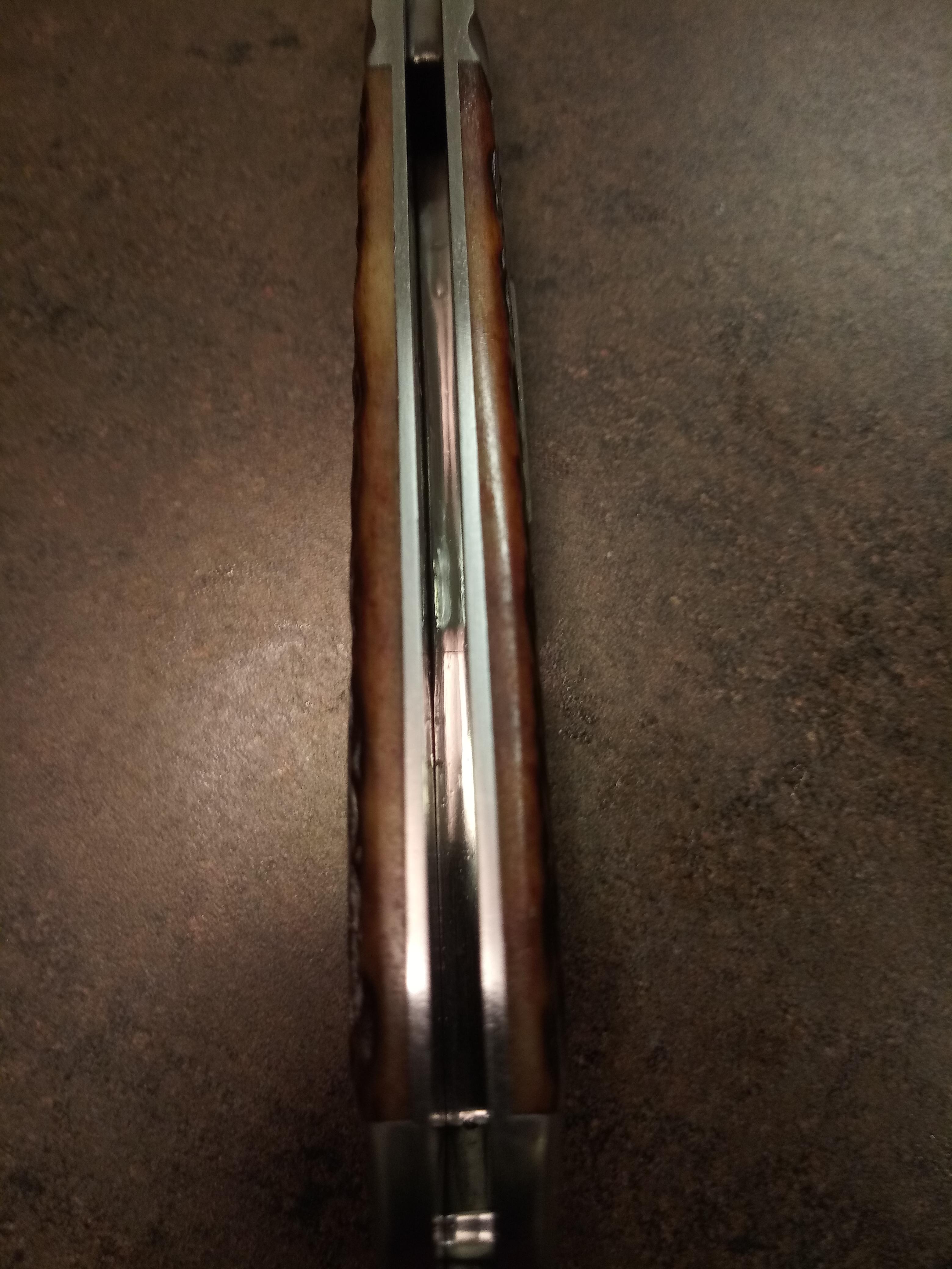

The main issue and the reason for the post was that the pull on this thing was like a 14 out of 10.. I feel like it was maybe a custom order to the specs of one of those WWF type "strongman" dudes who bend rebar with their hands while preaching about the benefits of sober living at schools.
While watching tv I have opened and closed this thing with the blade wrapped in a towel hundreds of times and have had zero luck getting it to lighten up. I finally put it away in my knife case and forgot about it --until tonight when it occured to me that parcels take time to get to Japan and I should maybe get it prepared for its journey to the maker.
I admire the knife and fight with the blade to get it to half...pinch the blade and snap it into the open position. At this point I heard a loud pop....I immediately assumed I snapped the spring.
To my surprise the knife was still completely together...not only that- it now has like a 6/7 pull and the action is snappy and feels like the other Ohta. I'm very confused at this point and start inspecting everything..upon shining a light into the liner I see that the spring has cracked near center pin. Only on the inside of the knife is it apparent the spine looks normal.
You can see the perfectly straight line in the photo where the light is hitting in the photo.
I keep my knives in a light coat of mineral oil like I've learned to do ....the knife walks and talks great now...what kind of structural integrity do you experts think I'm dealing with here? In your opinion is it unlikely to last very long with the crack in the spring? Anyone ever have something like this happen?!
I have read about springs snapping but never them cracking and improving the movement. I should probably still send it off right?

That spring is cracked partially through. That crack is now a weak spot and the spring is flexing at that point. Naturally it will feel different, and it will get easier until fatigue causes it to break completely. That could happen next time you open or close the knife, or in a week or a month. It will eventually fail completely, don't wait to return it.
As others have said, that spring will break sooner or later. I'd send it back now. You'll be happy you did.

Judging by your linked picture, and that it happened to OP's knife also, I wonder if the maker isn't leaving enough material on the blade well side of the spring pin?
I suppose that's possible. He makes a lot of slip joints though and I rarely hear of a problem.

I noticed it was in the same place as well I'm just amazed it was a partial crack and not completely through like Peregrin's! If I picked the knife up I wouldnt think anything was wrong with it since the blade moves normal although as I've been advised...ticking time bomb!
Looks to me that the crack goes right through the hole where the pin goes through. If so, the inside part broke leaving the outside intact. That being said, it is common practice to stop crack propagation by drilling a hole at the end of the crack. The round hole just might have stopped it from breaking completely.....for now.......
Broken springs are usually due to improper heat treatment. The only two I’ve experienced were from one maker in the same pattern. At first the action felt smoother then gritty, then the spring popped. Both cracks were at the same location.
