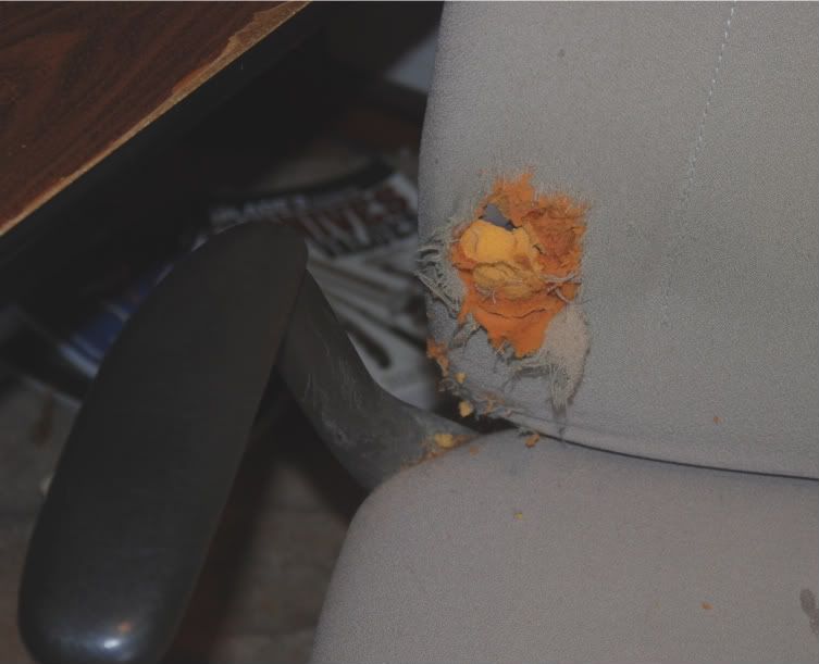

2. The low ride tip up clip system of the Pro is better for me. The horn on the TNT sticks out of your pocket a good quarter of an inch and will damage chairs and knuckles.

TNT rips a hole in my chair. Those frame horns are pretty tough on chairs and knuckles
I appreciate the write up and your thoughts, and will be checking out the Pro next chance I get, but what were you doing in that chair?

Great comparison! :thumbup: Thanks much for the info. I still plan to get a Vantage Pro even though I have the TNT and carry it daily. At work I carry it in my left rear pocket and I sit at a computer most of the day and have for years. I don't know how you sit in a chair :o, but I have no experience with the chair getting ripped up because of the knife. I really like the "horns" because they serve to keep my hand from slipping down on the blade. Lord knows I need all the help in that area I can get. :o

No holes in my chairs ,car or pickup....I have 4 " between my knife and seat backs.
Ah, well the TNT was being carried in my right back pocket all the way over as close to my hip as it'd go in that pocket. I sit all the way back in the chair...no slouching. I don't know, maybe I'm trying to put to much butt in that chair.:o
