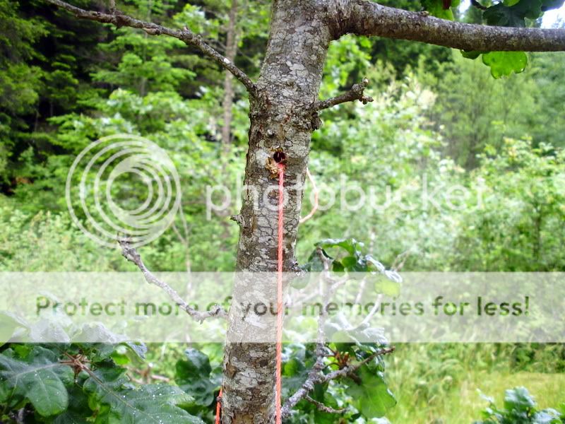

While I was out today I decided to make a bird snare that I'd seen recently !
Ideally this trap should use a pre-cut pole so that it can be set up in an area where there are no other places for the bird to perch. As I was just practicing I used a tree and no prepping so there were hardly any signs of my presence once I had gone.
Anyway to start you need to make a hole through the pole so you can pass some cordage through, I used the awl on my Swiss Spirit:

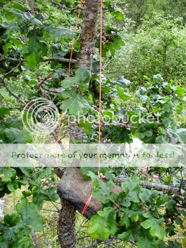

The cordage ( I used high vis so you can see it ) comes out of the back and is attached to a rock:

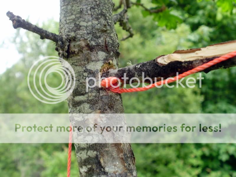

The front of the hole should have been slightly dished. The piece you use for the perch should be rounded at the end to sit in the dished section of the main pole. A knot in the cordage, pulled tight by the rock, is all that stops the perch from falling:
When in the set position the rock should be just above half way up the pole.

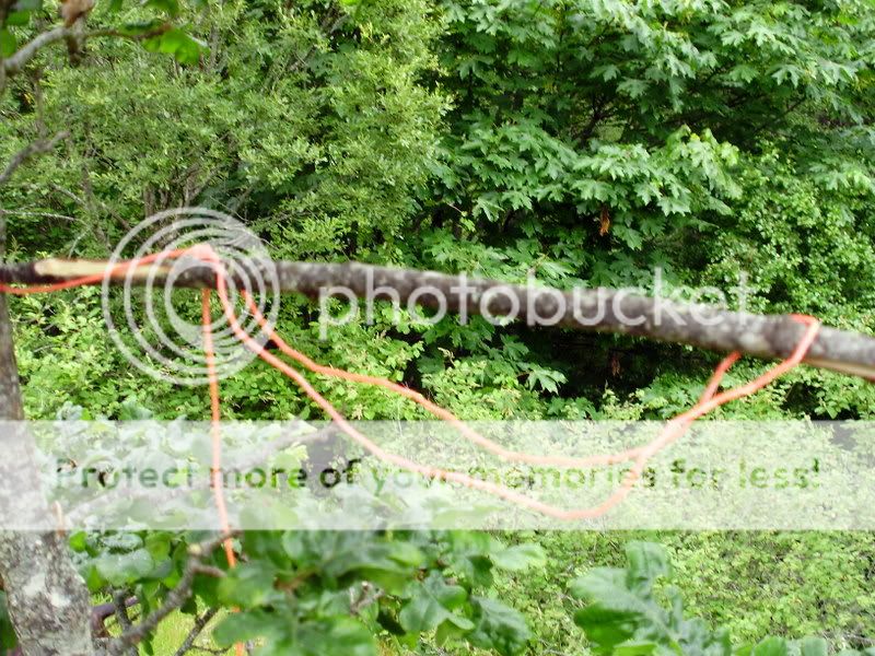

In front of the knot a noose is made and rests on the perch:
As I could get no birds to act as test pilots I had to use a stick. Once the stick was placed on the perch the perch dropped allowing the weight of the rock to pull the cordage through and tightening the noose as it goes. One trapped bird...err stick !

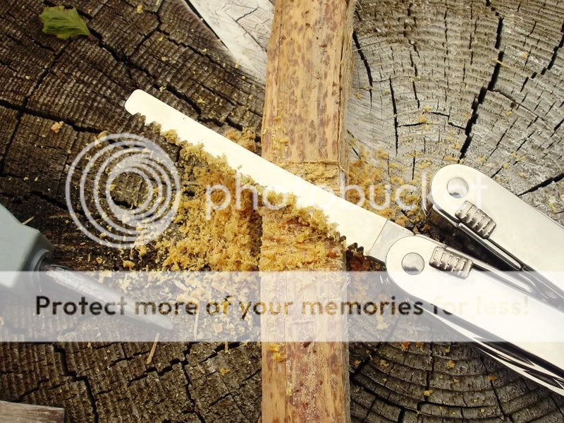

I then used my Spirit to make some Fatwood dust:
And my other blade to make some nice shavings:

Just one thing you might want to consider. The knot is not necessary to hold the perch in place, the tension on the string is enough if the hole is tapered well. If you are gonna use a knot you should always place the knot on top of the perch stick instead of the bottom because it has a tenancy to catch on the hole and slow the trap enough for the bird to escape. I use these to catch starlings for practice and that's one of the lessons I've learned the hard way.

I did actually try with the knot to the top to start with as I thought that was how I'd seen it but it would not hold it !:(
Then try to shave the perch stick to match the taper of the hole that you put in the vertical support stick. The stick should "mate" up to the tapered hole and form an even plug. If you do not use a knot at all and the perch stick is even with the hole it will have a much higher success rate for catching the bird that lands on it. I have actually found that the extra grip of natural cord like dogbane or yucca make this trap easier to set without the knot. I should also mention that you need to make sure you rock is sized correctly for the type of bird your targeting so that you don't accidentally pull the string through the birds legs and lose the now legless bird.
