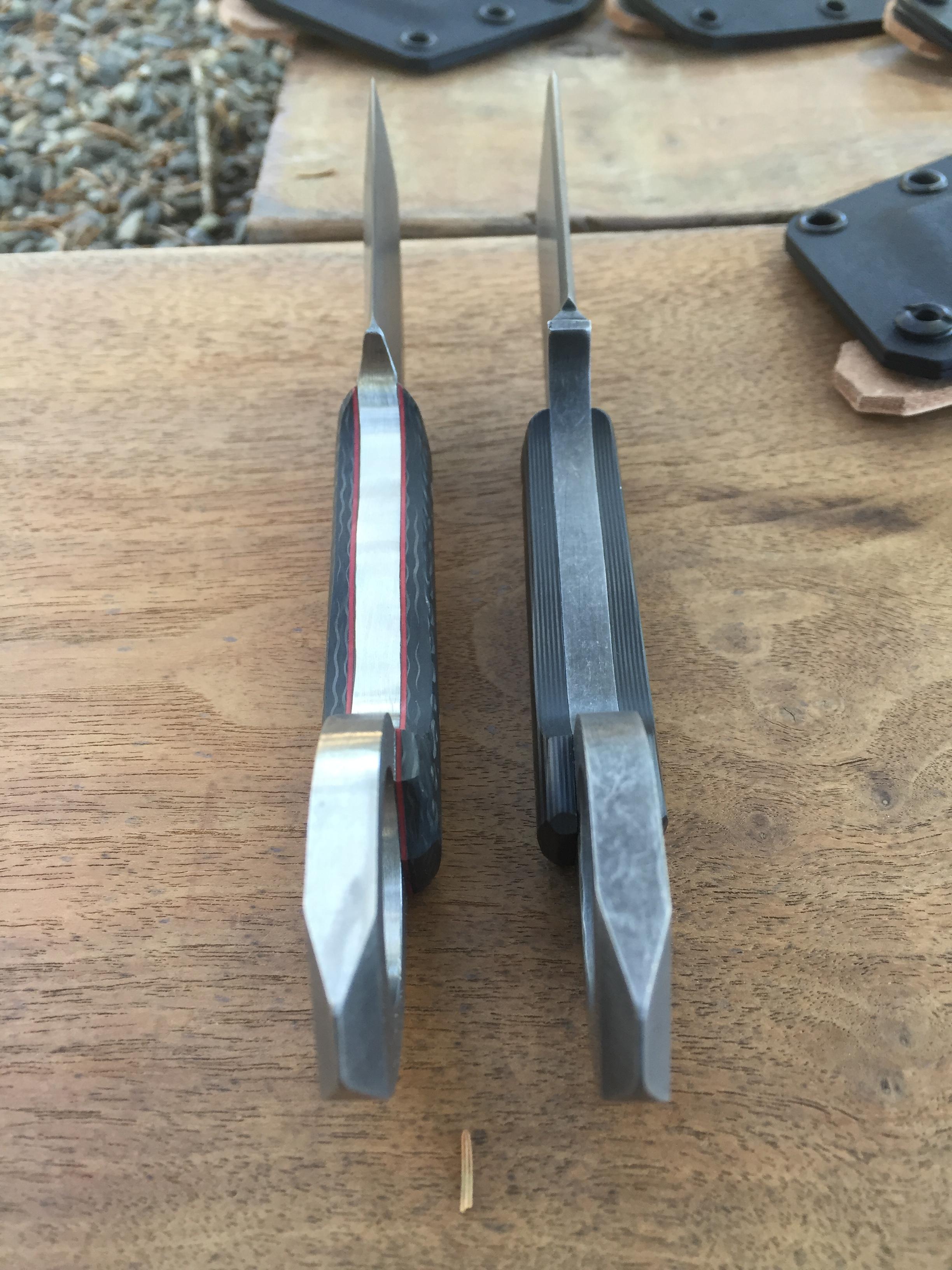

I personally use a 50-50 mix of ferric chloride and water. Leave it in for around 10-15 minutes and then stonewash. I use an old thermos with various sized stones that I found in my yard. Make sure they are pretty smooth, otherwise you will have a really scratched up blade, not a tumbled look. Here's how mine come out. The flats still have the rolled steel texture but the bevels are how it should turn out.
looks great. can you describe your thermos procedure?
I have a video on my instagram (from a long time ago so it'll be hard to find) and will be posting a video/tutorial on how I do my whole acidwash procedure in the next week or two. I basically put it in the thermos with the rocks and a little WD-40 and then shake it by hand until I'm happy with the results.
