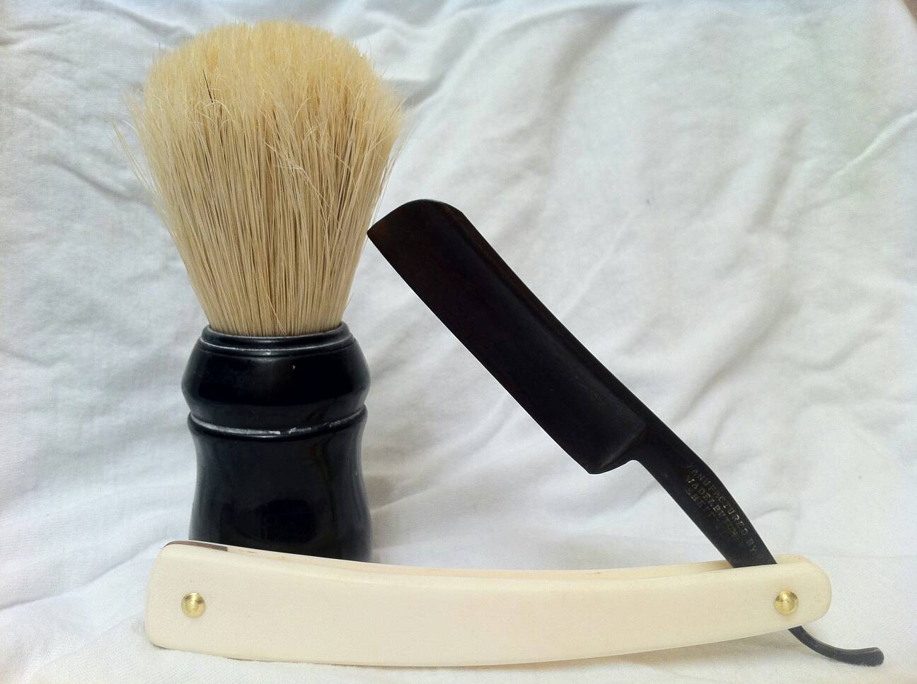

I will agree with Daniel. You can take your vinegar/salt water/hydrogen peroxide patina blade and "set" it a bit with boiling water. Just don't let the blade touch the bottom of the pot, suspend it in the water some how. Then, immediately from the water, dry off, then oil or wax while very hot. I liked the finish on this razor I restored.
