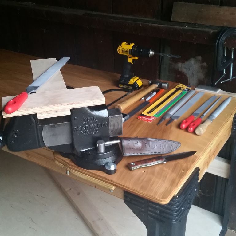

Suffice to say I started researching more seriously and started getting some tools together. Started with a blank slate minus a basic set of ratchets, pliers, screw drivers, sockets, etc. I figured I'd start small with a Aaron Gough file jig and actually cut out my first blade from bar stock with a hacksaw. The results were pretty awesome IMHO and I only got more excited as things progressed. Until I helicoptered the blade on the drill press while drilling out the weight relief holes. Yup! Rookie mistake not clamping it down correctly. Lesson learned. The blade was too damaged to continue with but still usable for a pattern.*
By that time I'd picked up an angle grinder and was seriously considering a belt grinder. The Gough file jig was nice but not really how I wanted to do this. I realized I could go the upgrade route with a 1x30 then 2x48 to a 2x72. Being me, I ended up just going whole hog with a Pheer 454 2x72 grinder. Figured in the long run it'd save me money over the upgrade route. Yes, I've thought myself crazy a few times during the decision process. Especially considering I don't have a completed knife under my belt. Still sorta do but that's me.*

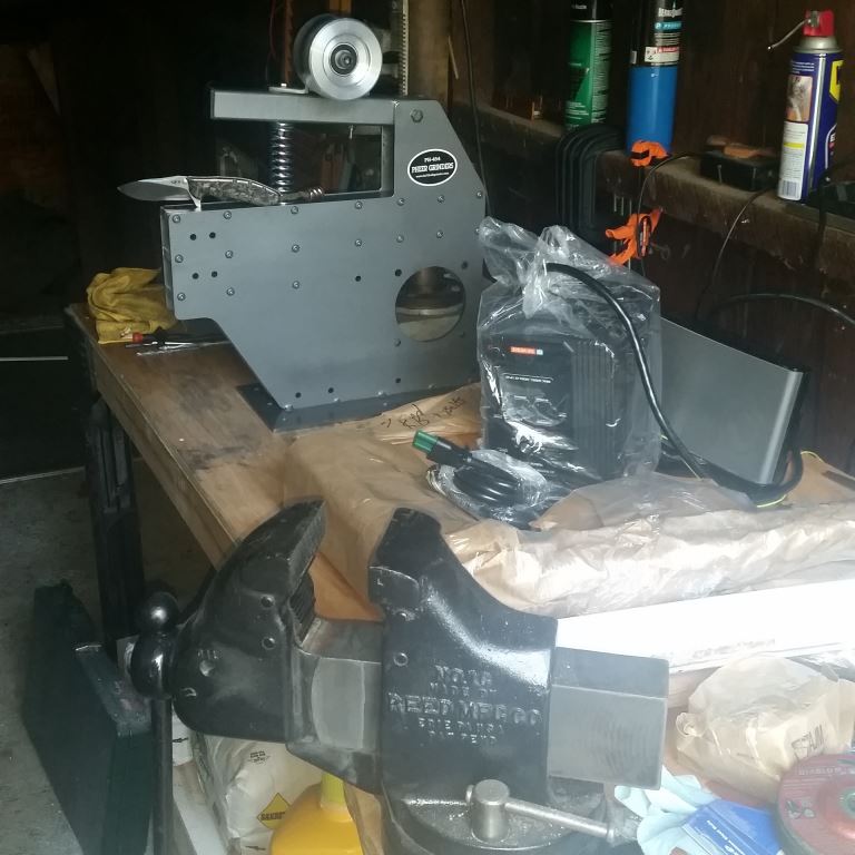

Got the Pheer 454 put together and working. No electrical mishaps after wiring YAY! This thing is a beast. The fit and finish are excellent. Got the flat platen, 10" contact wheel, small wheel tool arm, and a tool rest. I used my previous attempt as the pattern for this next build. It's a basic spearpoint bushcraft knife somewhat similar to an Arete/Bushcrafter. Last week I cut the blade from 1/8" bar stock and ground the edges to shape on the Pheer. Tonight I drilled out the pin and lanyard holes and some weight relief holes. Then scribed the edge and gave my best shot at a freehand full flat grind on the flat platen.*

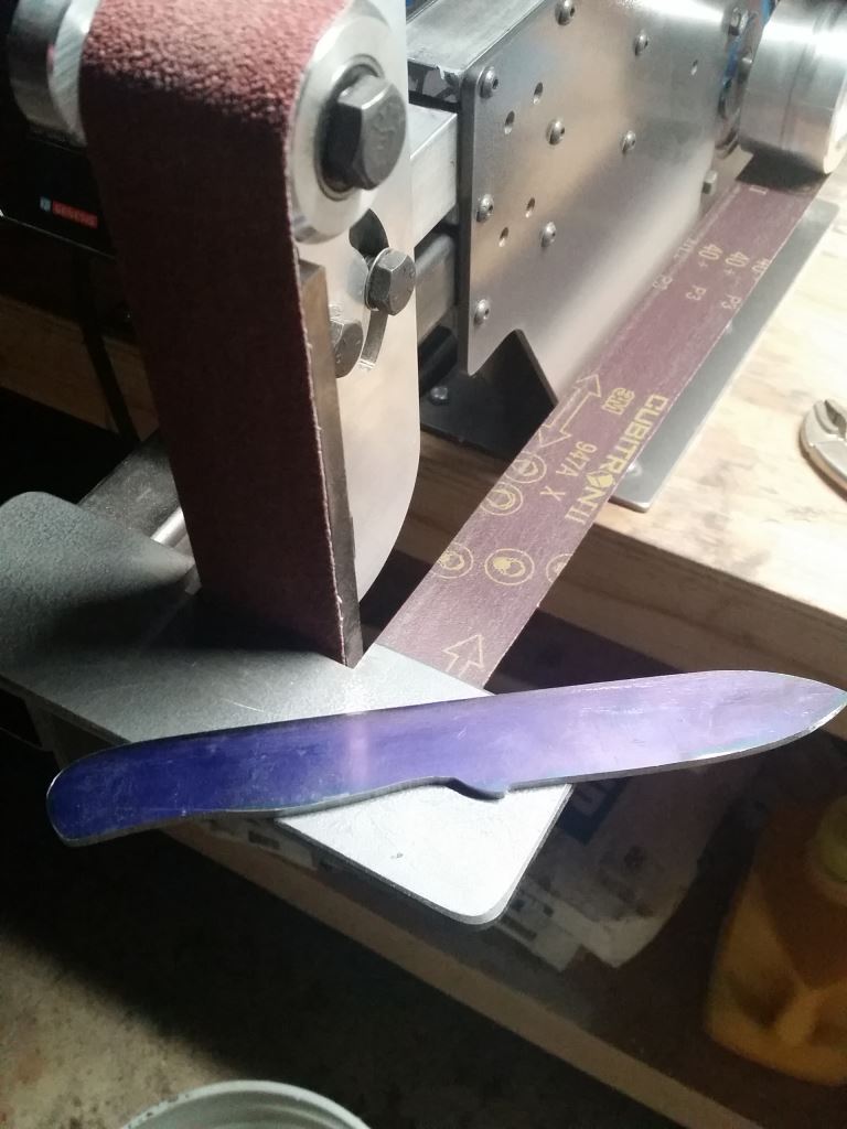

It's not straight.*
It's not even.*
Rounded the tip on one of my first passes. Before I figured out how much angle to add as I drew the tip into the belt. Hint - not much.
Hit the edge too much and had to take a bit off to get it thick enough again.*
Got a great even bevel edge on one side and totally screwed up the other by taking it too high haha. Ended up taking the bevel all the way to the spine.
Had to adjust the plunge lines a few times and one is still not straight. I think I'm going to order a grinding guide by Bill Behnke to help this part be a bit easier for awhile.*
Learned a ton about how it "feels" to grind a blade. It was definitely a great learning experience and I still plan to complete the knife with all the planned finishing steps. I'll pick up some vegetable oil for HT soon. Still need to find a cheap toaster oven for tempering. This is NOT easy and I can tell it will take awhile to get good at doing this. I'll take it slow and do little bits at a time to avoid getting frustrated with rookie mistakes.*
I've always had a ton of respect for all the guys at Fiddleback Forge, Osprey K&T, W.A. Surls Knives, Fletcher Knives, Jarrett Fleming and bunch more since I started buying handmade knives. Yet these new experiences dabbling at knife making have really upped the level of respect I have for you all. Thanks for being the inspiration to start this in the first place!

I learned 2 things from using the Gough jig if you don't mind my passing them along. You really have to keep the file clean with a card. Also focus on not using the tip of the file because the taper against the plunge bolt will mess with your plunge line. Other than those it's pretty easy if you discount the sweat equity.

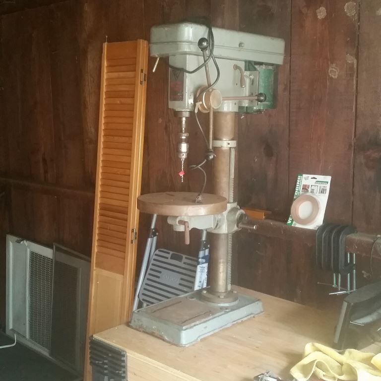

On your drill press use a stop bolt through the base. If you don't want to scar it use a small rubber hose on the bolt. Thanks for the other videos too I will definitely check them out.
