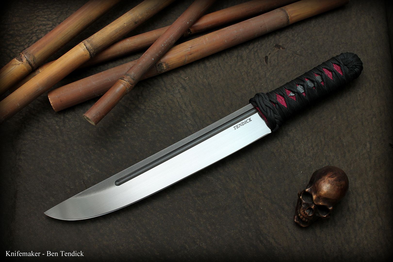

Just finished this one up. it is a bit different being that the grind goes through the grip. The blade is just shy of 10" with a 5.25" handle. The blade is more hand rubbed 3v at around .280" thick.

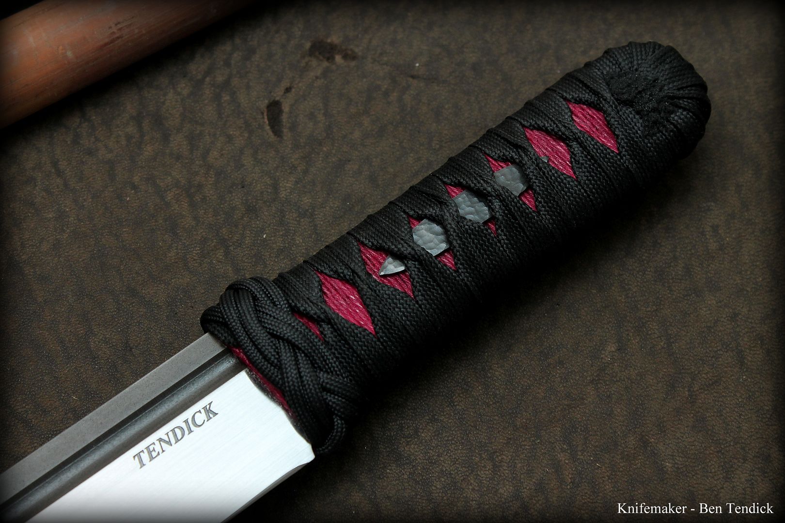

Oddly enough, I have never done a turks head knot, this was my first try. The Menuki are hammered Zirconium. I am pretty happy with whole the thing.
As always comments are welcome!

That blade is really a style I like and it looks great.
Nice Turkshead Knot, it tops off that handle just right and I sure like the way it feels on a wrapped handle like that.
Is that hard utility cord that you used for the Turkshead.... I ask because I use that because it stays round and does not flatten out like gutted paracord...either way it came out great.
The black and read contrats with your Menuki really catches the eye.
You've been turning out some awesome asian inspired blades lately.
I just wish I could afford one of your waki's, just killer.

Thanks Adam!
The turks head knot is just Paracord with the guts still in it. It worked really well, and has a nice look I think.

Nice knife. I like the simple hammered menuki.

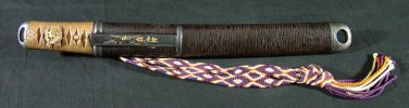

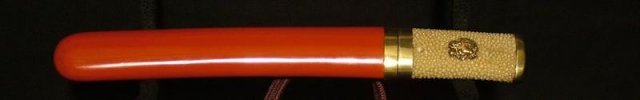

Just as a general matter of definitude, Mike157 is correct in that the term "Aikuchi" is a term which indicates the type of mounting, not the style of blade. More specifically, the way what would be known as the fuchi / kashira come together without the use of a tsuba (guard). There is a small lip (or male end) on the "fuchi" which fits precisely into the mouth (or female end) of the "kashira".
Below are several examples of this type of koshirae. Two are Tanto, one is a wakizashi. The close-up is of the seam found on aikuchi f/k.

Very nice work. For what it's worth though I personally prefer your metal guards, but that is a matter of opinion :)
