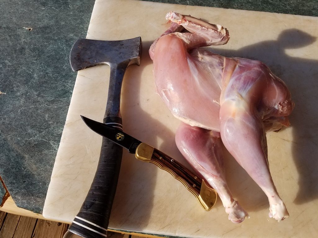

Koss, I thought I'd take this further. By showing the AG in use. Material slides off these coated blades when being used. Just take a normal 110 and cut a slice of cheese. Then examine the blade. Now do the same with the AG. You should notice much less cheese stuck to it.
This is why I enjoy using it. We raised a rooster and being fully matured I'll use this model for the processing today. DM

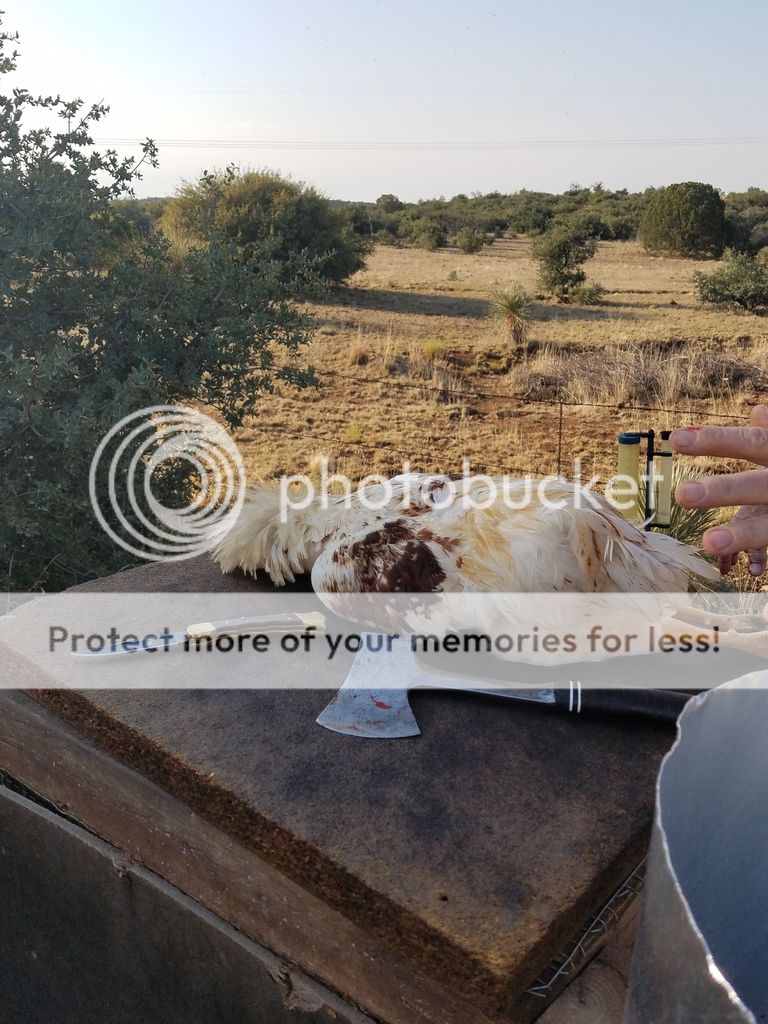

I got these first 2 photos reversed but will go forward with it. This morning early, rooster caught. DM

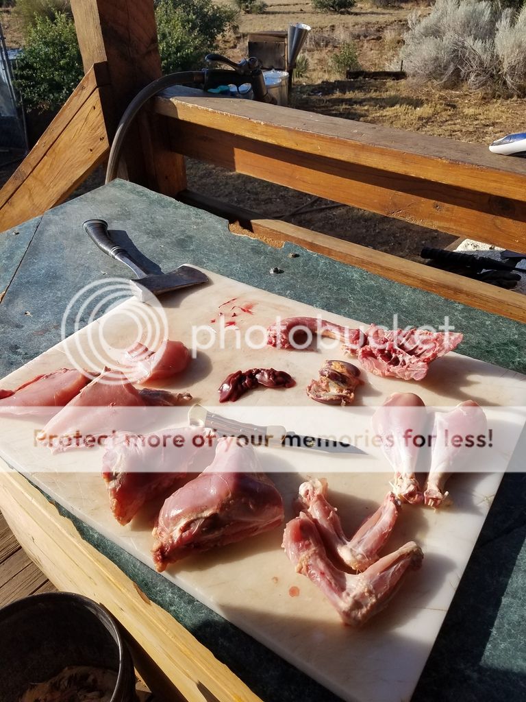

Here is all the cuts and parts ready for the freezer. Being from the South we save the liver and gizzard. The back and neck, (sometimes not saved) with a drum thrown in are used as grocery extenders in chicken soup with noodles. The AG blade remains clean like this all through. Any of this look familiar? DM
