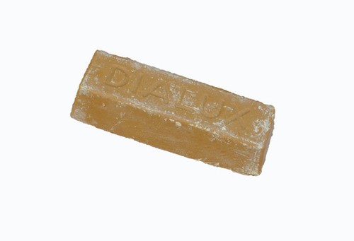

These are the REAL bars sold by Gesswein, the Orange bar/Vornex is not shown, so I will provide an image of just that bar next
This is the REAL Orange/Vornex bar out of the McCaw Catalog, adding to the set from the image above, note how dark it is compared to the orange shown on the box, then compare the colors to the fakes, now you know.
This is the REAL Beige/Vonax bar out of its packaging, I don't have an image of the box and I have not seen it counterfeited but I put it here to be thourough. Image from The Polishing Shop
Another REAL Beige/Bonax bar out of its packaging, for reference of possible color, as it looks slightly different from the other image. From EBAY

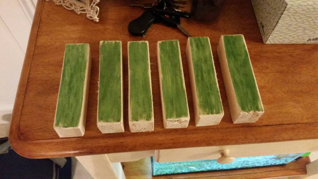

Thanks for all the info I actually just ordered some dialux green to try polishing up my knives. Was thinking of trying a balsa wood strop with it too. Has anybody done this?
Sent from my SAMSUNG-SM-G870A using Tapatalk
ive never tried it on balsa but I've been using Dialux Vert for years on leather and it works very well.

Well I got the green dialux in and put it on some balsa and it works amazing. I am very impressed with both the compound and the balsa.
No not yet and it went on surprisingly smooth. I figured I would end up using a heat gun to warm the surface but it wasn't needed. I actually got a 3x3x12 block of balsa and cut it up into 1-1/2x 6 sections giving me 8 blocks of balsa and put the compound on all of them. I kept one and used the rest as gifts for a few friends and family.
