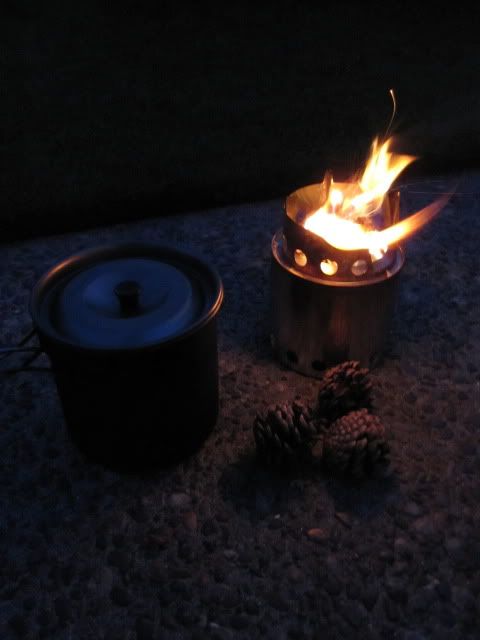

While I was out walking the dog this afternoon I realized that there were a ton of pinecones on the ground. These pinecones were dry and open and brown. Very woody i might add, especially when you pull some of the tabs off you can find wood like fibres.
I returned later in the afternoon and filled up a grocery bag full of pinecones and took them home. They have a wonderful smell to them that i just cant get enough of :)
I decided to bring out my bushbuddy stove and see how well the pinecones would work as stove fuel. Having filled the pot with a liter of water i proceded to get myself setup.
My bushbuddy stove setup and ready to go. The Brunton IB pot filled with water and lid on. A small bag of fat wood with shavings and my brian andrews skog kniven. Also, the type of pinecones i was using. (Not pictured is my goinggear firesteel/mischmetal [always mix them up]).
i proceeded to stuff the pinecone with a few shavings of fat wood and then struck a spark onto it.
The fatwood lit up instantly and the pinecone lit up with it.
i placed the pinecone into my stove and proceeded to add more pinecones to it. Heres a pic of the stove going with 3 pinecones in the stove.
Heres a shot of the pot on top of the stove.
Heres a few shots of the fire from the stove
The really cool thing that i found was that the pinecones burnt almost like charcoal. They would burn really hot in the beginning and then produce a very nice and even heat, perfect to cook a few smokies on.
Heres a shot of the pinecones burning like charcoal.
All in all it was quite an interesting experiment. Once the pinecones had burnt down they really did burn like the briquettes you'd buy in a store. Seems like a great way to cook in the outdoors.
Oh ya, it took 10 pinecones to boil up 1L of water in 8 minutes. Not bad when you've got nothing to do on a Sunday night.

That is very cool. I use that stove as well. In fact, it's the stove i use on any multi-day hike. I usually light it off with a little chunk of an esbit along with sticks that I gather and bag as I walk. If I get the chance, I'll try the pine cones. One question, though. Did the pine cones leave any really tough residue inside the stove or on the outside of the pot?
the outside of my pot is black as hell from all the soot from previous use so i couldnt really tell or notice if there was additional buildup.
The inside of the stove seemed fine, it was as if i was burning wood in it.
That's cool. You can always find cones, or at least I always can where I live. Wonder how different cones would work. Those are some sort of Pine, red pine or ponderosa pine, I can't really see from the pictures. I'd like to see the same with spruce cones too.
I've tried spruce cones when i was camping. They work but not as well as the pines.
