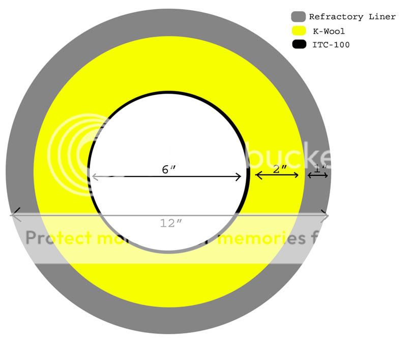

Hopefully I followed what you said. Is this the end product you were thinking? I'm not sure if I should do a 4" or 6" opening. If I do a 6" opening and 15" long that gives me 423 cubic inches. I think I saw somewhere about how many cubic inches you should expect out of one of the EZ burners.

I'm pretty sure the kaowool goes between the metal skin and the refractory liner. ITC-100 seals the refractory.
Yes, the refractory liner is wrapped in K-wool on the outside.
If you use a 4" inner chamber, and 2" walls that makes the liner 8" wide. Wrap that in 2" thick K-wool and it should fit a 12" shell nicely. The ITC-100 is a coating on the inside of the poured liner.

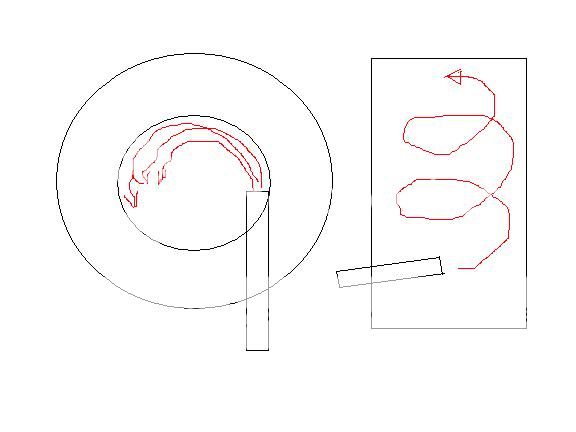

My concern with a 4" chamber is that I'm going to have a huge hot spot at the point where the burner enters the forge. Any thoughts on creating an environment with even heat?
If the burner enters at a tangent to the interior of the forge the flame will swirl around the outer part of the interior. This evenly distributes the heat. You don't want the flame aimed directly at to work.

Kind of like this, left side. If you were to have it upright, the flame would spiral upwards, laying down, spiral out towards the front opening
The main purpose of a poured refractory liner is to make an even heating chamber. It will have a hot spot at first, and take as much as fifteen to twenty minutes to fully soak the refractory, but once up to heat, it will stay at a very even temperature. Placing a blade in after it is soaked will allow a very even and controlled HT. PID control will make it even more accurate.

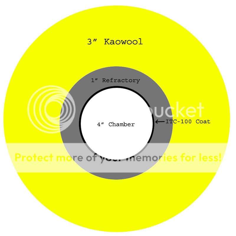

So here's the conclusion I have come to.
1. 3" Kaowool, 1" refractory, Coating of ITC 100....giving me a 4" diameter
2. 14" long should give me all the depth I need for now
3. I'm going to stick with my venturi burner to keep costs down
4. I'll get a PID/thermocouple but just for monitoring purposes. At this point I'm not going to go the extra mile for full control
I do have an 8" SS tube I could use but that only lets me use 1" Kaowool and 1" Refractory cement...or 2" kaowool with just a coating of the cement. Hmm...
The 1" of refractory vs 2" is because I'm not making mass quantities of knives, nor am I going to be hammering anything. I think the time it would take to heat up 2" would actually cost me more in fuel even though its more efficient once its up to temp. I just don't see myself running the forge for an hour at a time.
What do you think?

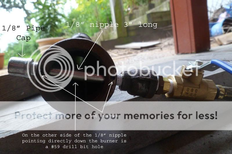

Here's a few pics of the pieces to my burner. The design is Ron Reil's. Here's a link to his website (which I find ridiculously hard to navigate...): http://ronreil.abana.org/sitemap.html
Look for the "Reil" or "EZ" burner design plans. The only place where I deviated from his design is the flare at the end. Since I don't have any way to flare a 1" x 3" pipe I just used a 1" x 2.5" and put a 1" to 1.25" bell reducer on the end. In the video above you can see that it seems to work quite well. I have never build a burner before and have never been in another blade smith's shop so I really have nothing to compare it to.

That plan should work fine. The aluminum shell should barely get warm.
The venturi burner you made will do the job, but I think the bell reducer flare is not right. Try just a sleeve of 1" stainless pipe without the reducer. That should allow the flame to mix and expand as it leaves the burner tube. The stainless flare will last longer.
When running the forge, let it heat up slowly. Running the burner wide open into a cold chamber invites cracking the liner. Once heated to above 1000, you can crank up the heat to whatever yo want. Allow the chamber to fully soak before doing a HT.
I tried the burner without the flare and it doesn't work. I haven't researched it enough to know why, but it seems venturi burners require it. Ron suggests flaring a 1" piece to 1-1/4" on the end or you can buy a SS one from him. I'm cheap...
Here's the burner without the flare. When I start to turn up the pressure it blows itself out

Here's the burner with the flare. When I turn up the pressure it sounds like a jet taking off :o)

That type of burner will burn outside the forge with a flared end but the flare is not needed in the forge just a straight pipe.
