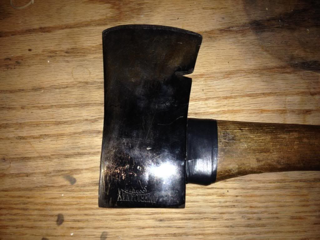

I've become a lot more interested bushcraft lately and had been looking for a better hatchet than what I currently have. I was looking at the wetterlings and other Swedish axes. I was about to pull the trigger on a new wetterlings when divine intervention struck in the form of a phone call from my mother. Over the course of the conversation my potential new acquisition came up. She told me to hold off because she had a hatchet for me. It turns out that my great grandfather used to work for the American ax company in glassport PA until 1919. He had held on to several of the hatchets he had help to make while there and had designated that one should go to me when I got old enough (he died a year after I born). I can't think of anything more cool than using the hatchet made by and picked out for me by my great grandfather. I just want to know if anyone here knows much about the company, and how this hatchet would serve in a bushcrafting role. Also any advice on securing the hatchet head, it's somewhat loose. I'd love to use the original shaft if I can, but if that's unrealistic I'll replace it. Thanks in advance!

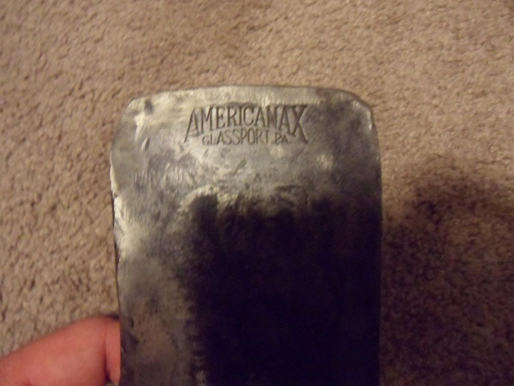

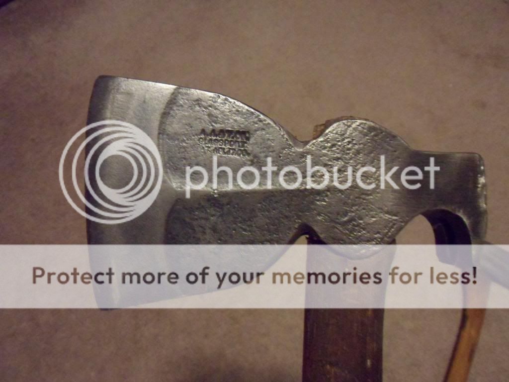

If it is an old original placed away for you to have one day down the road, that is awesome. I am sure it will be a great user. Here are some pics of some of mine -

That's the general opinion I've come to, thanks for the info. I've perused the yesteryear tool site and the american axe and tool threads on here. Those are some beautiful axes. I can't figure out for the life of me how to put pictures on here so I'll just describe mine. Standard looking hatchet head, flat back, a slot in the bottom near the eye to pull out nails, I assume. Arching Americanax, Glassport PA logo. Original 16 in hickory handle, curved, stained, and waxed. The head has no rust, just normal greying of tool steel. Still has all the original gloss on the head too. I've put a new edge on it and done some practice cuts in the yard, and has blown my other hatchets out of the water. I'll probably keep my estwing in the pack as a back up since it's indestructible, but the Americanax is definitely my new primary hatchet.

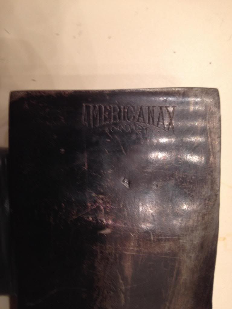

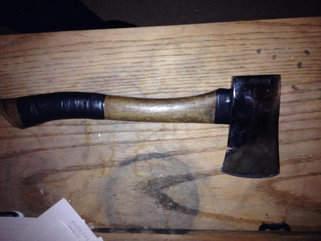

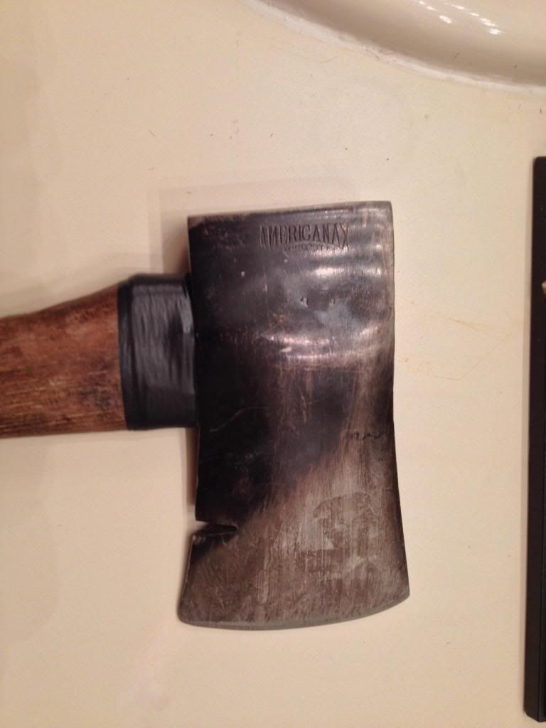

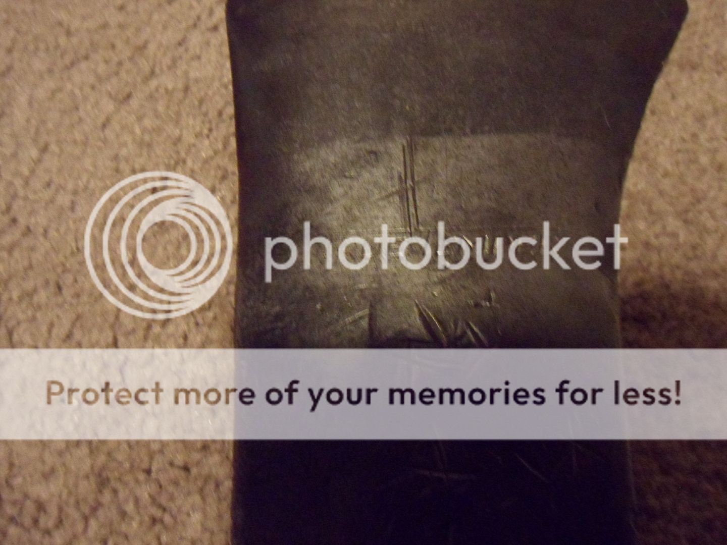

Apparently I can do it from my phone, here are the pics.
The electrical tape was added by my grandfather, I liked it so after I cleaned the handle up I put it back. Thanks for the photo tip, I can now fully participate in the community!
Thanks. My grandfather who was keeping it for me from his father maintained his tools in a way I can only hope to emulate. I know he used it for some yard work but for the most part it sat wrapped in an oil cloth in a box in his tool chest.

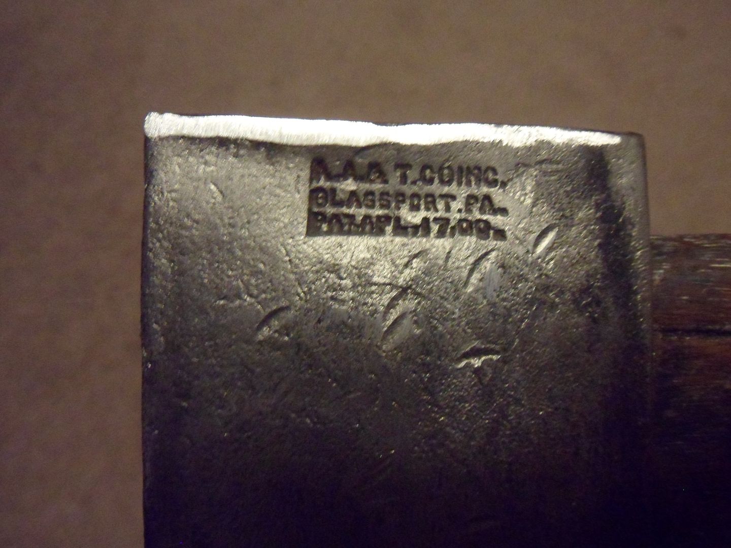

The axe with AmericanAx on one side and TrueTemper on the other seems very confusing to me. Especially with AmericanAx "Glasport PA" that supposedly closed in 1921, prior to the Kelly buy out. It seems that Kelly with their True Temper name could have later used the AmericanAx brand that they acquired, but why would they use the stamp with Glassport PA?? Any ideas on that, I have seen other axes with that same double marking.
First off, that's an awesome axe and a great story. A photo of the top of the axe would help us to advise the best way to go about tightening up the hang. It also shows off the profile of the axe head ;-).
As for how this could be used as a tool for Bushcraft well it's a camp hatchet so that's essentially what it was designed for. It can be used to chop and split wood generally of a smaller diameter, rough carving tasks, driving wooden stakes and wedges, the nail puller aside from the obvious can be used to pull up stakes from the ground, and if need be it can completly take the place of your knife. Check out MCQBushcraft on YouTube, he demonstrates a lot of hatchet use in his videos from 2014 if I recall. His hatchet isn't as nice as yours, but he certainly puts it to work.
The axe with AmericanAx on one side and TrueTemper on the other seems very confusing to me. Especially with AmericanAx "Glasport PA" that supposedly closed in 1921, prior to the Kelly buy out. . .
I think you are referring to the dbl (first pic in operators post above), Here is the other side of that axe:
It is post AA&T. The Americanax trademark was used after the AA&T buyout. The trademark went with Kelly and beyond,
