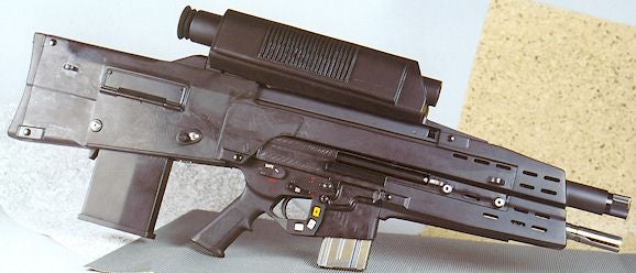

H&K developed it, nice to know we don't have any companies capable to
doing that anymore , I would have loved to have a chance at that. That would be the design job I would love to get my hands on. Heck , I might even look forward to work....
They do look similar, I wonder if the is another case of sci fi , helping the creation of new technology alond the way. The carrring handle looks a little bit delicate, and that barrel shroud is a bit confusing as well. If it's plastic it won't conduct enough heat, but it will be easier to manufacture . If it's metal it will cost a fortune, it will have a chance of conducting the heat from the barrel, those irregugular biocompatable shapes are hard to manufacture in metal.
I will believe the caseless theme when I see it , the military has been after that for years without sucess( I guess late 70's at least). Semi caseless
round may have possiblities, but it will also share some of the major problems encourtered with the caseless rounds, which is maintaining intregity feeding and extraction of the primer from the mechanism. I would like to see the chamber/ case design. The extraction system would be interesting to look at as well, the case has to be big enough to grab a hold of mechanically to extract reliably. It also is gass operated with a rotating piston, I wonder if is the same as the m16,which blows the exhaust gass right into the bolt? I have always thought that a bad idea from a maintainace standpoint, but it does save some weight.
Also I think making a service rifle and the sniper rifle the same design rather poor, sounds like something some industrial designer just out of school would propose (looks good on paper till you dig a little deeper), yet it is ever so popular. The sniper rifle require much better fit, which requires more care in manufacture/maintanance. A service rifle needs to operate in adverse conditions, Kind of like designing a jeep to run the indy 500, no matter how you sort the compromises, your not going to qualify........ Or an indy car to off road in, might work for a while but not too long.
