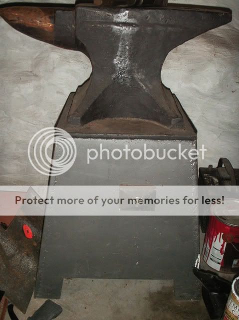

I have a good size anvil that is welded to a stand made up of 1/2" plate.Very sturdy,perfect height... but it's loud I mean really loud.Not in the nice "TING" way either.Another problem is leveling it.Iv'e considered cutting it free and making a wooden base.Ive also thought of putting car sound deadening mat in the base.Iv'e tried attaching large magnets to it but no joy there.So,opinions or options? Ideas on a sturdy method of adjustable leveling?A method of making it more mobile would be awesome as I have a rather small shop and alot of tool intensive hobbies.

I didn't make the base,bought the anvil this way.I'm leaning towards cutting it free and making a tried and true wood base rather than spending the time and money trying various fixes on the steel base with no way of knowing if it will work.
Have you tried expanding foam insulation? If that base is hollow Id fill it with the stuff, no way to resonate if it's full of that stuff.

I'm with Jason. If you are going to keep that setup, fill it with Great foam and it should attenuate the sound a lot.
The best solution would be to make a wooden stand.

That must be the resonator model of Anvil. You could also fill it with sand and leave a plug hole on the bottom then if you did need to move it, you could just knock the plug out. Or you could cut a few interesting holes into the stand and try to tune it.

I've mentioned this before, but what I have done with mine is : Weld a steel plate, tacks will do, to the bottom of your anvil,then get an old oil drum, twenty litres should be big enough, and fill it with sand. Then sit the anvil ontop of the sand. It is very steady without having to bolt it down as it settles into the sand a little and the sand cuts down on the ringing. It is also easy to ajust the hight by removing or adding more sand. It is also quite portable as you can just take the anvil off the base and move the base to wherever you want and then put the anvil back on, simple.

for leveling, weld some 3/4" (or larger) nuts to the bottom of the stand - maybe as many as 8, one on either side of the corners about 1" or so from the corner - and use bolts as your levellers. Head on the ground and a piece of stall mat glued to the head to help dampen vibration. use a nut and lock washer to lock the bolt in place once you have everything set the way you want it.
