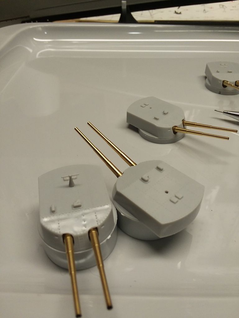

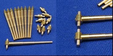

They are brass etched parts that either come with newer kits or add ons for older kits they replace plastic parts or are extras , rails , funnel caps , life boat frames and on and on. They also make brass turned guns as a add ons .

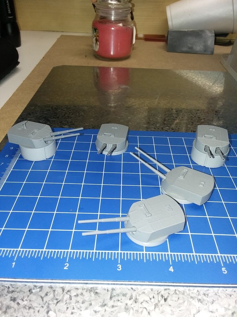

Guns are assembled and painted.

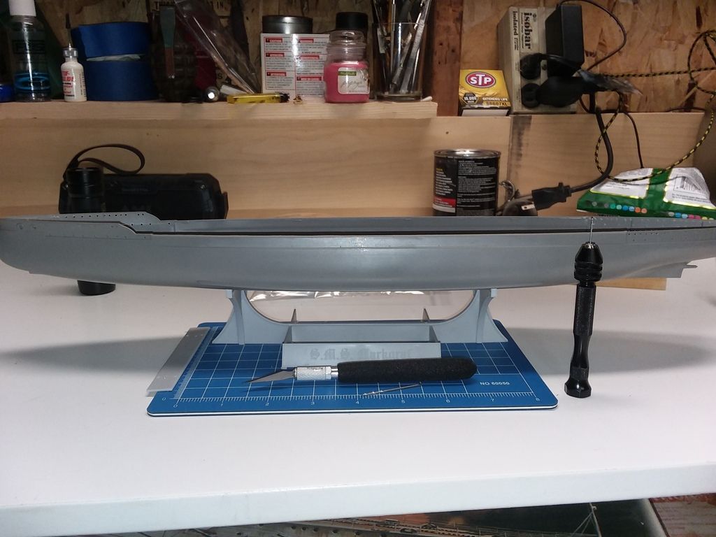

I've been build models for a few years and I see your making progress on that ship. Photo etch is a PITA.It takes patience and a very light touch (as your finding out ). Are you cleaning the sheet before you start ? If not, its hard to get paint to stick, same with the plastic. A bath in the sink with dish liq. Clean the PE with 90%alcohol .Ask me how I know this !I learned the hard way. Very sharp x-acto knives (hone those things ). Good tweezers and a piece of glass to cut those little googers free . If your eyes are as bad as mine (old fart here) a magnifying glass helps.
Keep at it ,you'll figure it out.

Yes I cleaned the whole sheet before I even started , I learned the hard way about cutting that stuff on a soft surface bends the crap out of it my first attempt was a ladder , ruined it . Magnifying glass and 1.50 reading glasses .
