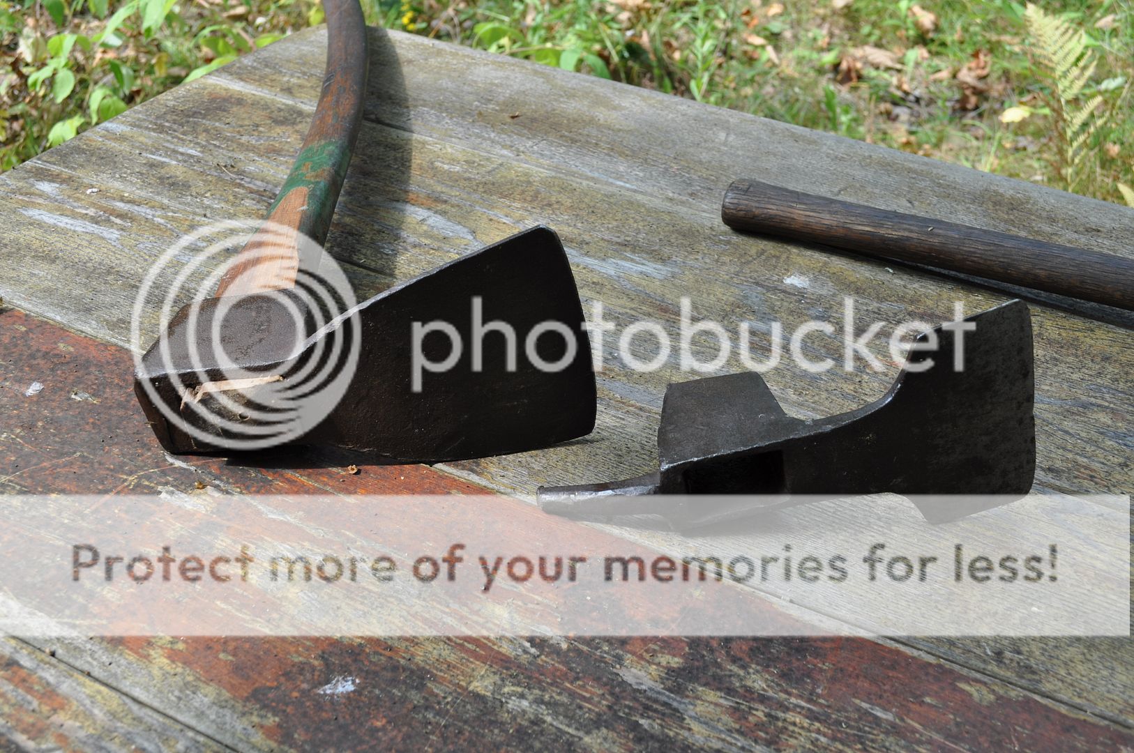

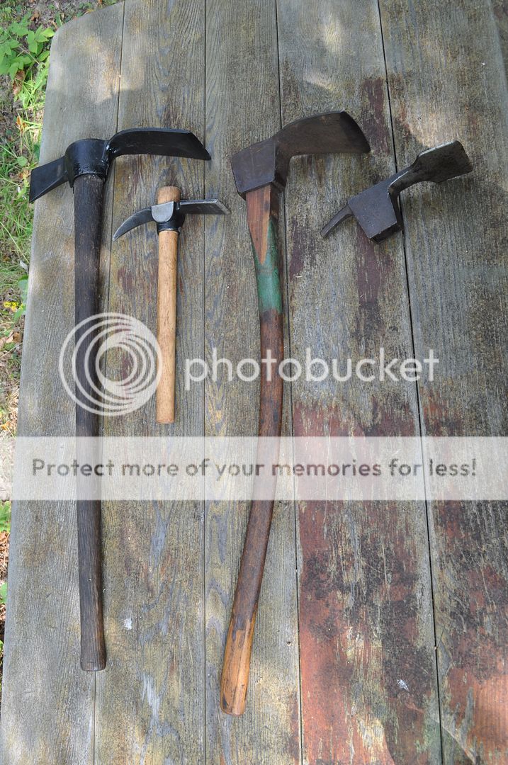

Here's a few that I've picked up at garage, estate sales. I don't know very much about them.
Third pic left most tool looks like a grub hoe variant not an adze. The next one the little tool is neat, still more pic than adze I think. Next looks like a standard carpenter adze and the last one is a shipwright adze, I just bought one very similar. Adze's are cool.
You're right about the first one. It's a mattock, and earth tool rather than a woodworking tool.

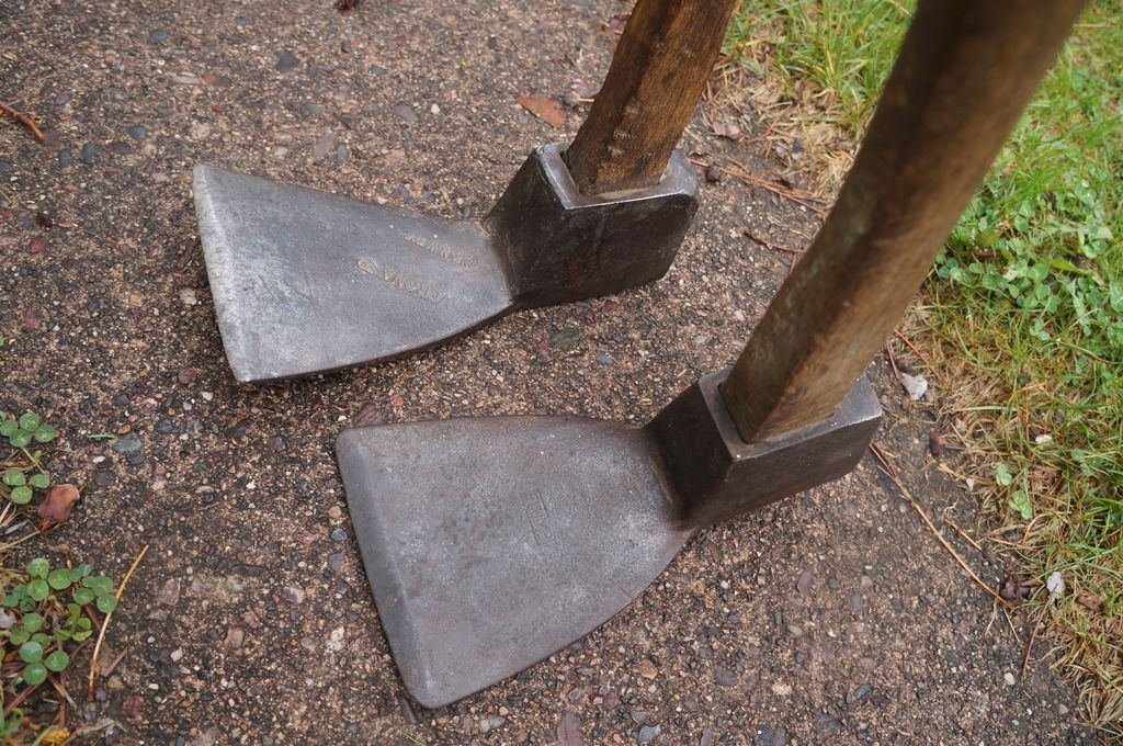

An adze was the tool that gave me the the restoration bug. I picked up an old piece of rusty crap at the salvage shop in town, paid a few bucks, gave it a vinegar bath, and came out with this flat-head house adze by the Douglas Axe Manufacturing Company. She's from before 1900, and the stamp only shows part of the "W. HUNT ... DOUGLAS ... MFG CO" along with what looks like "...SSD" which is an unknown mark to me. But beneath all that rust and age she still had a razor sharp edge. You can't beat a well made adze. I'm looking forward to having the time to hang this one. Or at least pass it on to someone who can appreciate it.

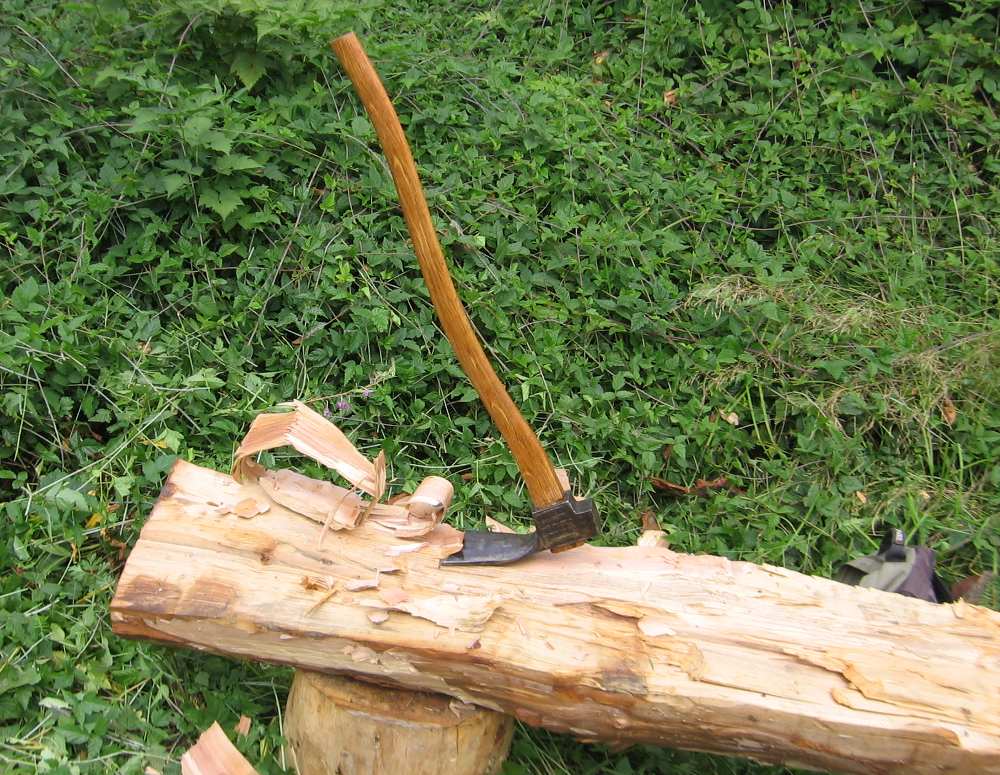

This thread is a good excuse to get out my adze accumulation. I am not an expert in adze use, maybe four hours total. There is an English guy with a hole in his jeans does a good job on youtube. Adzes leave a smoother finish than a broadaxe and are often used after the broadaxe. Left to right two railroad adzes, 3 carpenters adzes, 3 shipwrights adzes, two gutter adzes.

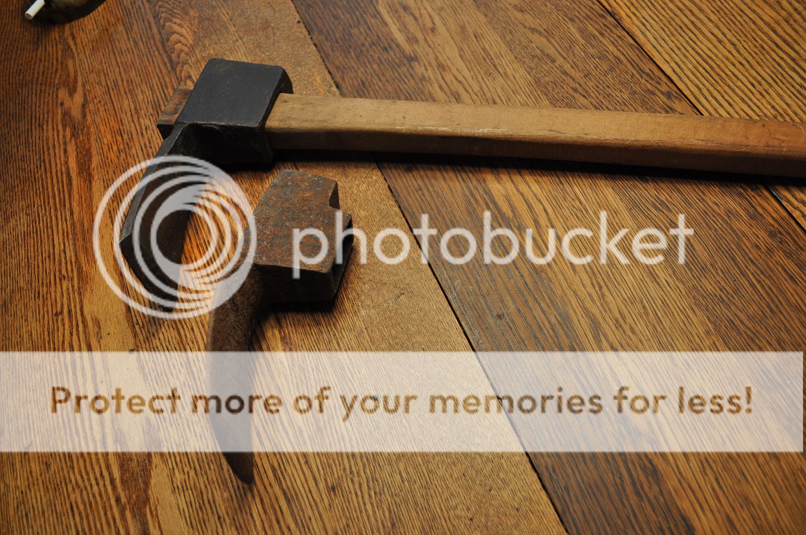

Kelley, unknown, unknown older forged with hammer poll.

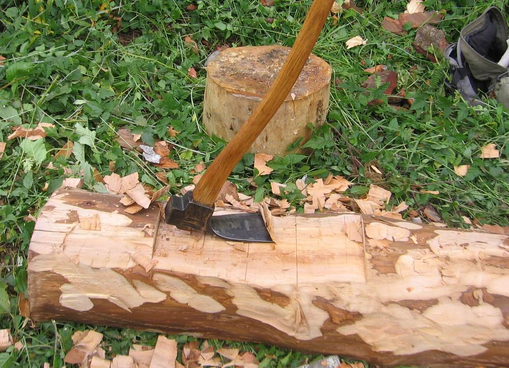

Gutter adzes top unknown bottom Underhill Edge Tool Nashua, NH. For hollowing.
