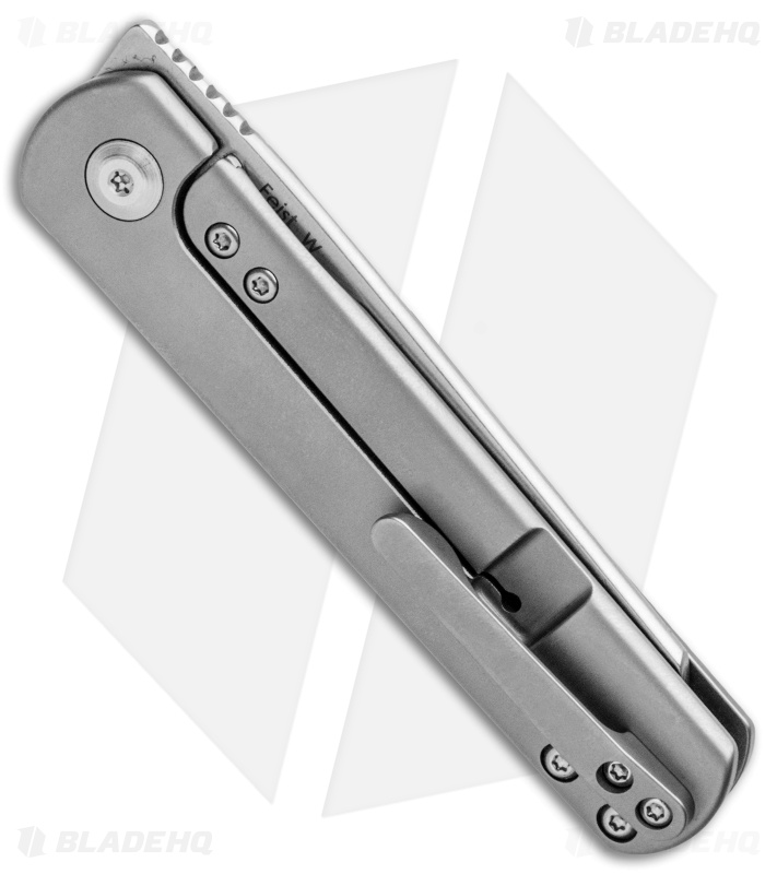

The Feist looks to have a milled clip that is elevated along its entire length; thus, giving better purchase:

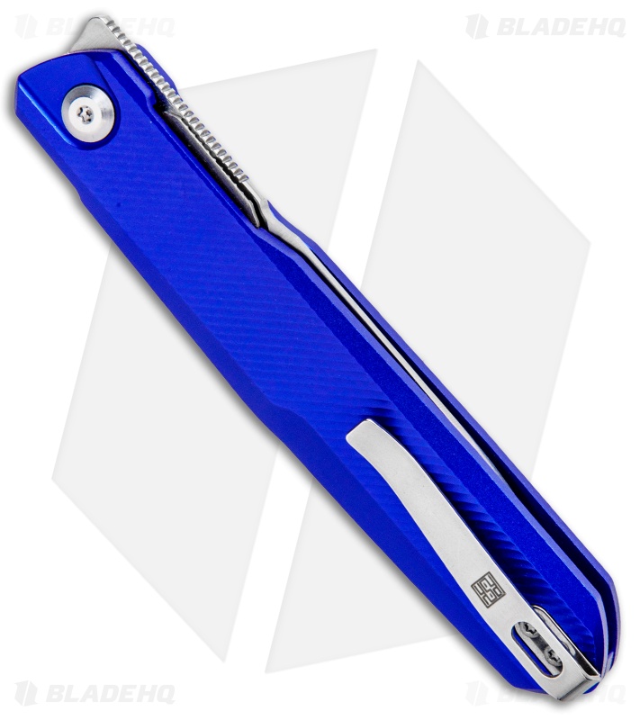

Little of the Metamorph clip is elevated:
The Metamorph's handle is a full inch longer than that of the Feist, which I think makes it harder to hook the relatively short clip while opening the thing.
Maybe I shouldn't be too eager to scratch the Feist from my wish list.

There is not much room for finger tips to hang on beside the clip for Metamorph.
