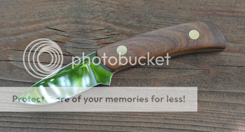

My first ever knife build is a knifekits drop point hunter with kingwood scales. Made the sheath too.

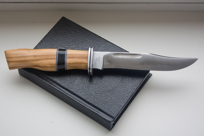

Isaaki Jarvenpaa kit blade, my handle, guard, buttcap and sheath.
