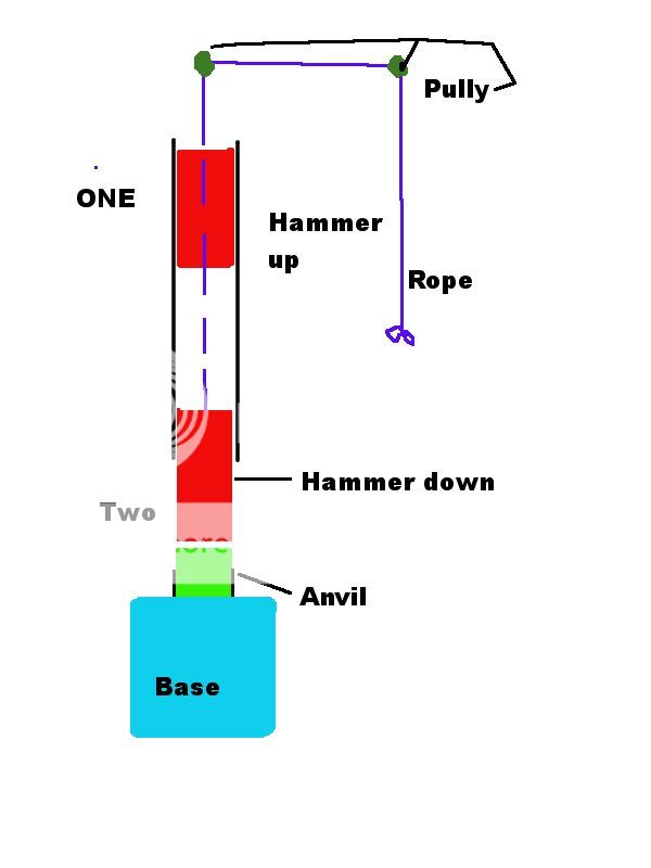

I got to thinking about wanting a power hammer and the high dollar price on them that I cant afford right now. Right now I don't even have enough "play money" to build a small home made one. Has anyone ever seen or made a manual "drop hammer"? Where something like a sledge hammer head, or other heavy piece of metal, is dropped down into a chute onto an anvil to strike the hot metal?
The drawing below is basically what I was thinking about. The hammer would have a rope attached to it on one end and then lowered into a shaft that would allow it to rise and fall easily. An anvil of some sort would be placed below it on a stable base. Pull the rope and then let it go. The weight of the hammer would make it drop, striking the object on the anvil.
A sledge hammer head could be crammed into a pipe just big enough to fit it in then welded on. This pipe could be inserted into a slightly larger pipe. One that would have enough clearance to let it slide easily enough. Or maybe a thick (2" to 4") piece of plate steel 3 or 4 inches wide and long enough to give it sufficient weight. Weld up some c channel to create a chute. Would something like this work?

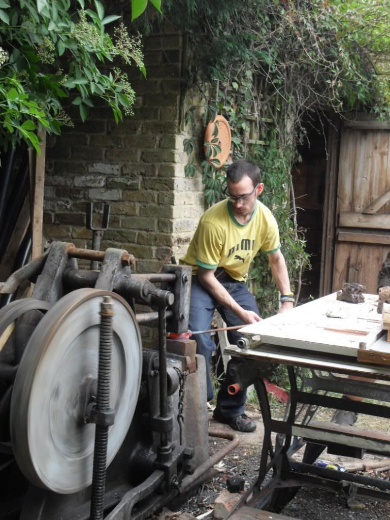

This is one heck of a drop hammer. Think a 10 to 20 pound sledge hammer would work the basic way this one works? Rope to pull it up, maybe a spring to pull it down faster?
http://www.redbubble.com/people/sweeper/art/1089661-finch-forge-drop-hammer

The force to lift the ram has to be equal or greater that the ram's downward force. So you will be doing the same as wielding a 10 pound hammer. There are several other problems with your plan.
The proper way to do that is to let the inertia of the ram do the striking in a more controlled manner. A treadle hammer does just that perfectly. There are plans and kits to build them readily available. These plans have been worked out and all the engineering problems solved. Parts lists are a real plus,too.
Another way is to suspend the ram on counterweighted cables. This is done in the "bicycle Wheel" power hammer plans. On this type system, the ram is suspended over the anvil on a steel cable. There are handles on the side of the ram to grip. The cables run around pivoted bike wheels (sans tires) and there is a counter weight system that lifts the ram. You pill down hard on the hammer ram and the inertia makes the strife strong, your arm gets saved the trouble of lifting the hammer/ram, by the counter weight system. This works with up to a 20 pound ram. I don't see the link I had to one of these, but their scarcity makes me assume that they aren't worth the trouble.

Thanks for all the additional replies and links guys. Sam, the drop hammer on your post is pretty cool looking(post #4). Do you know if he has a write up on it on the iforge site? I'll have to look around for it.
