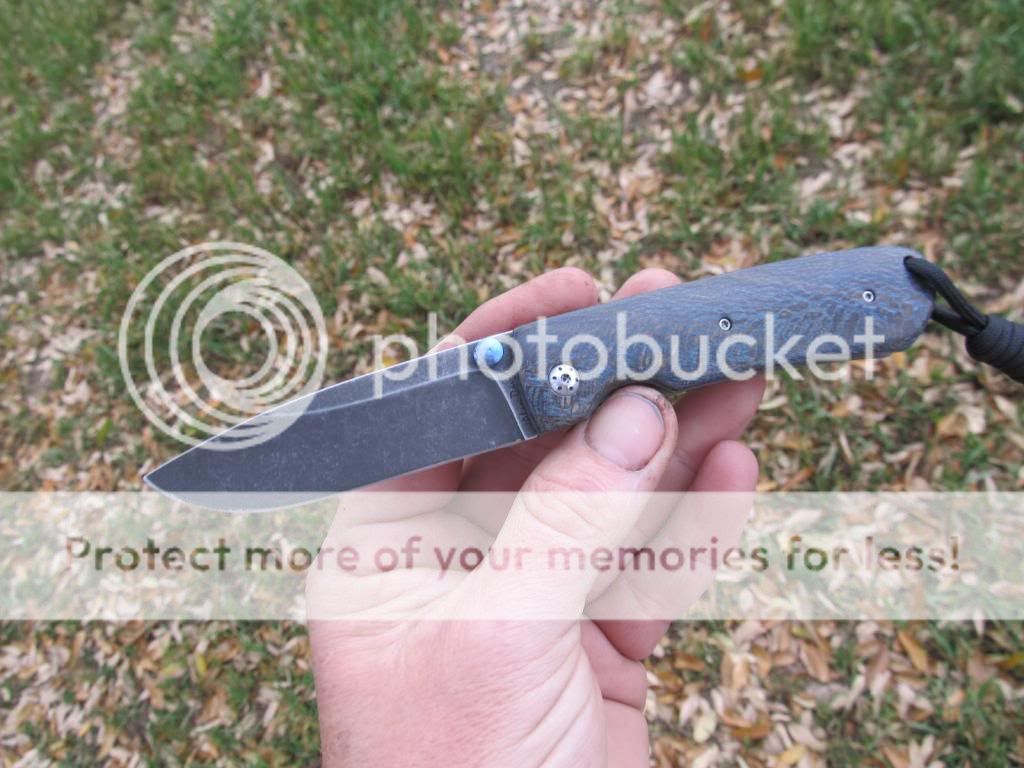

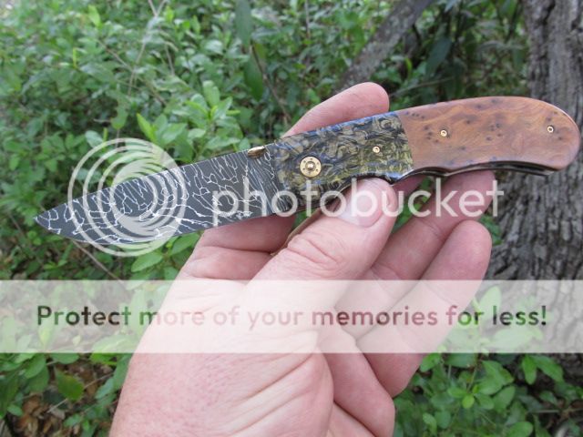

I parkerize nearly every carbon Damascus blade I make and have done several where I parkerized carbon blades before stonewashing rather than acid dip. It is very durable, my own personal edc knife was parkerized about 2 years ago and is still just as black now as it was then. The main difference between the two is I sandblast the plain carbon steel blades before Parkerizing and do not sand blast the Damascus. Here are a couple examples -
Lots of top makers in pattern weld are doing it- the Brazilians popularized it more, fairly recently. Check out Sfreddo, Quesenberry, the DesRosiers' work. Gives great contrast for mascus.
Alan, Nice Axis Deer! Your knife still looks good after use. Well done, Larry Lehman
thanks for the input and pics guys! Those look great!! That's amazing the damascus still shows through it!
