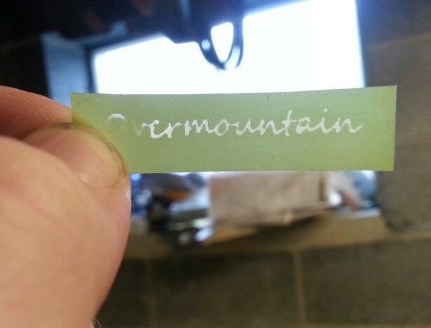

I have been obsessed lately with trying to build a better mousetrap on this one. Well, a cheaper one anyway... I started with the pcb etching stuff, their paints and the like, but moved on to screenprinting emulsions and mesh substrate. I wanted a stencil I could use more than once but only have a dollar or two into it so I could do one-off's as well. I discovered for our purposes the emulsion needed to be way thin on the mesh... A hard thing to do and keep even. So I discovered Ryocap emulsion sheets while talking to a friend who owns a promotional materials shop... Much finer results can be achieved with it. Below is how the standard speedball emulsion on 300+ tpi meshnhas been turning out. The Ryocap is much much cleaner but I've yet to photo the whole process. As soon as I see how it holds up I will do so.
The best part of all the screenprinting stuff is that it is cheap. They are looking for materials to do square yards of fabric. We just need a few inches... That means $10-15 can get you enough emulsion and mesh to do 5^2 yards of the stuff... The expensive part for any of it are the laser printer transparency sheets. But if you watch Amazon and Ebay closely, a pack of 50 can be had for $10-12... A lot for what it is, so print your mask on white paper first to check it then on the transparency... 50 sheets should last you a long time though...

Thanks for the compliments and encouragement guys. I'm lucky enough to have wormed my way into a friendship with a promotional shop owner as stated before. They do a lot of screenprinting on lots of materials. They also etch chemically, electro-chemicallly, and laser engrave... For their electro-chemical etching they use an outside stencil source for then stencils that will see a lot of use. But use the photoreactive film for quick one-offs. But, like I stated before I'm trying to beat the price of those sheets... And if one sheet gets accidentally exposed, you are out a few bucks. If a bit of emulsion gets exposed you are out a few pennies. And I am pretty happy with the results so far. I will get to the final pics Monday when I'm back off shift again...
