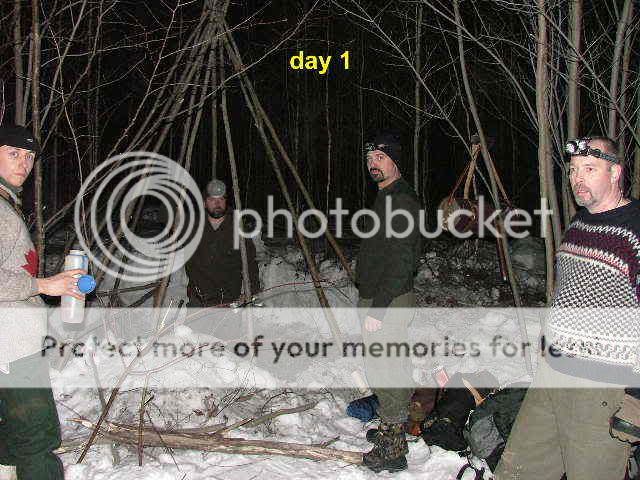

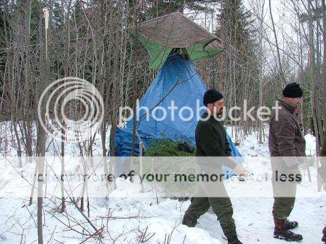

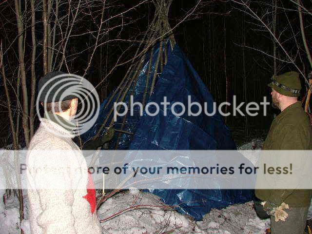

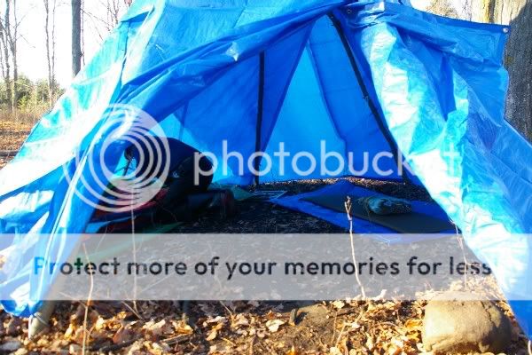

Here's the pictures:
Setting up inside:
At night with a fire going - temperature was below freezing - fire good!! :D
BOOMSTICK: that would be cool, how would you cinch it closed?
There were ropes in the corner grommets and we just tied it closed.

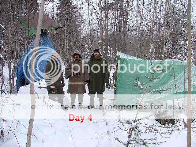

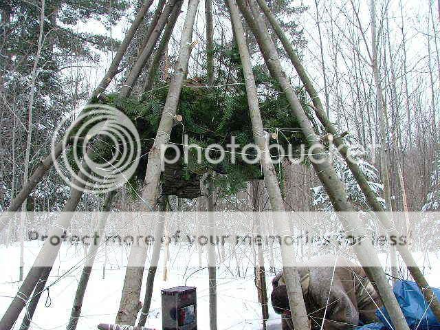

Guess we were posting at the same time. Nice pictures. What's the purpose of the boughs here?
Doc
Hey Rick,
Doc

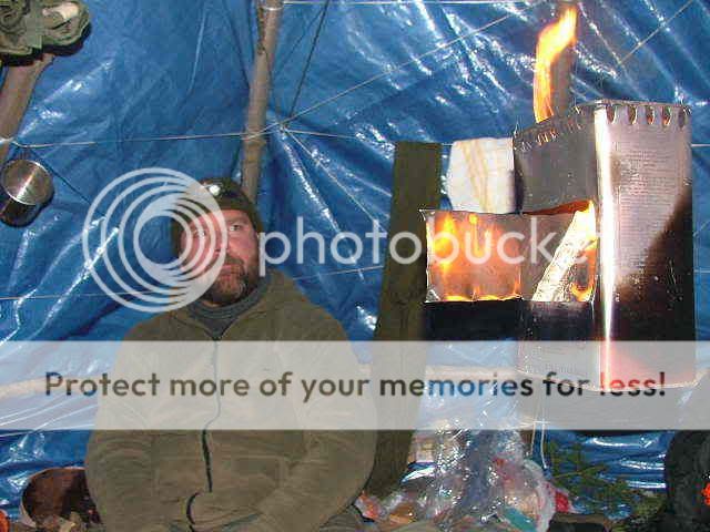

We found the boughs kept the heat lower in the tepee. Did you notice the birch bark chimney and the Naptha can woodstove hanging? could raise it up and out of the way. That one worked out quite well. 6days, at -35C, no sleeping bags....
Rick
What is the risk of carbon monoxide poisoning with the Naptha can woodstove?
Remember, the hemoglobin molecule prefers CO to O2.
Rick
I noticed the wood stove, but still can't see the Birch bark chimney.
With the stove higher, did it not mean that below the stove, where, presumably you were sleeping, was quite cold?
Did the boughs also slow down the smoke leaving the tipi?
acemaster: What is the risk of carbon monoxide poisoning with the Naptha can woodstove?
Shouldn't be a problem as long as there is proper ventilation. Remember, tipis have been used with indoor fires for hundreds of years.
