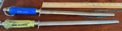

Ah, I was out of town, just back in the last few hours. Let me see what I can do this week in the way of photos and measurements. In the meantime, I can answer the other questions:
The chrome-looking one, called, um, Dick Polish, is great for a simple straightening of an edge in soft stainless. It's perfect for making my wife's crappy stainless knife last longer between sharpenings.
The Multicut is a miracle for Wusthof-class knives, light touch-up at light pressure, something more serious at heavy pressure. Very highly recommended if you use this type of knife.
For Japanese knives, I do not use steels, ever, even for the $45 Tojiro I got for my wife. Just doesn't seem to fit.

OK, picture with measurements. I'd forgotten how beautiful these tools are until I took them out and really looked at them.
