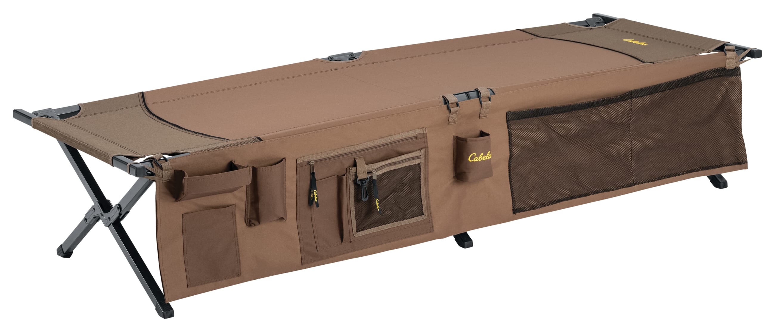

And the old standby Cabela's ones (weigh 20-30 pounds) that have excellent reviews:
master2_100106815_main
Anyone use a camp cot? Especially the ultralight ones? How are they?

I've used a US Army cot similar to the Cabela's cot, slept on one exclusively for over a year. It was surprisingly comfortable, much more comfortable than any ground sleeping arrangements I've used. Definitely durable. That said, it was heavy, too heavy for me to consider backpacking it. No experience with lightweight models. If they can support the weight without sagging or stretching too much, seems like a good alternative.

The cot does take more floor room than just a pad on the floor and the height at head and foot means you have to set up a bit further from sloped walls. Not much problem I suppose in a 12 man when that Cabelas cot is also in the running.

A cot is pretty nice if you can stand to carry it in. I still use them when I’m close to the truck. Even in the warmer seasons I roll out a Thermarest foam mat on the top of the cot. Air underneath you robs warmth.
