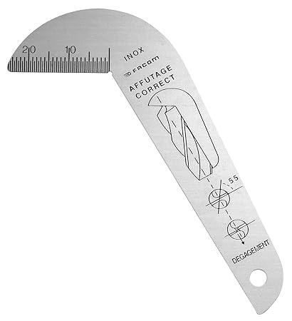

And a drill point angle guide
He explains things well here
https://www.youtube.com/watch?v=y0SQkzScQk0
