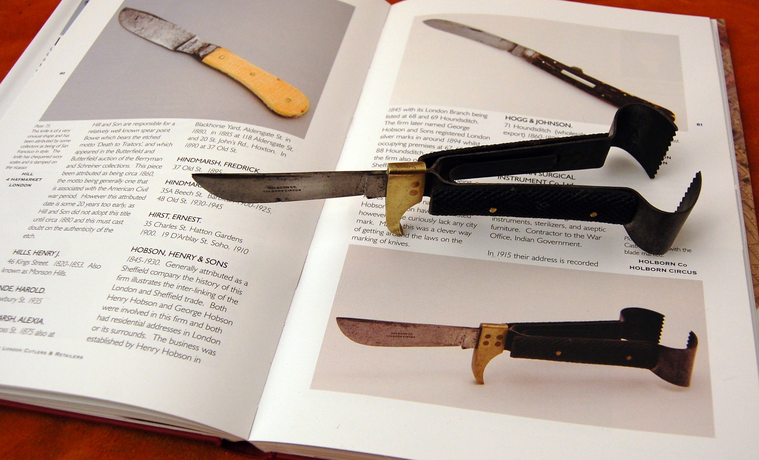

Lamb Clamps / Lamb Tongs were a castrating knife pattern popular in the the first 1/2 of the 20th century. They were marketed to cowboys and sheepmen in Australia, NZ, and England mainly - https://www.jbrucevoyles.com/A117/XHB185.JPG .
