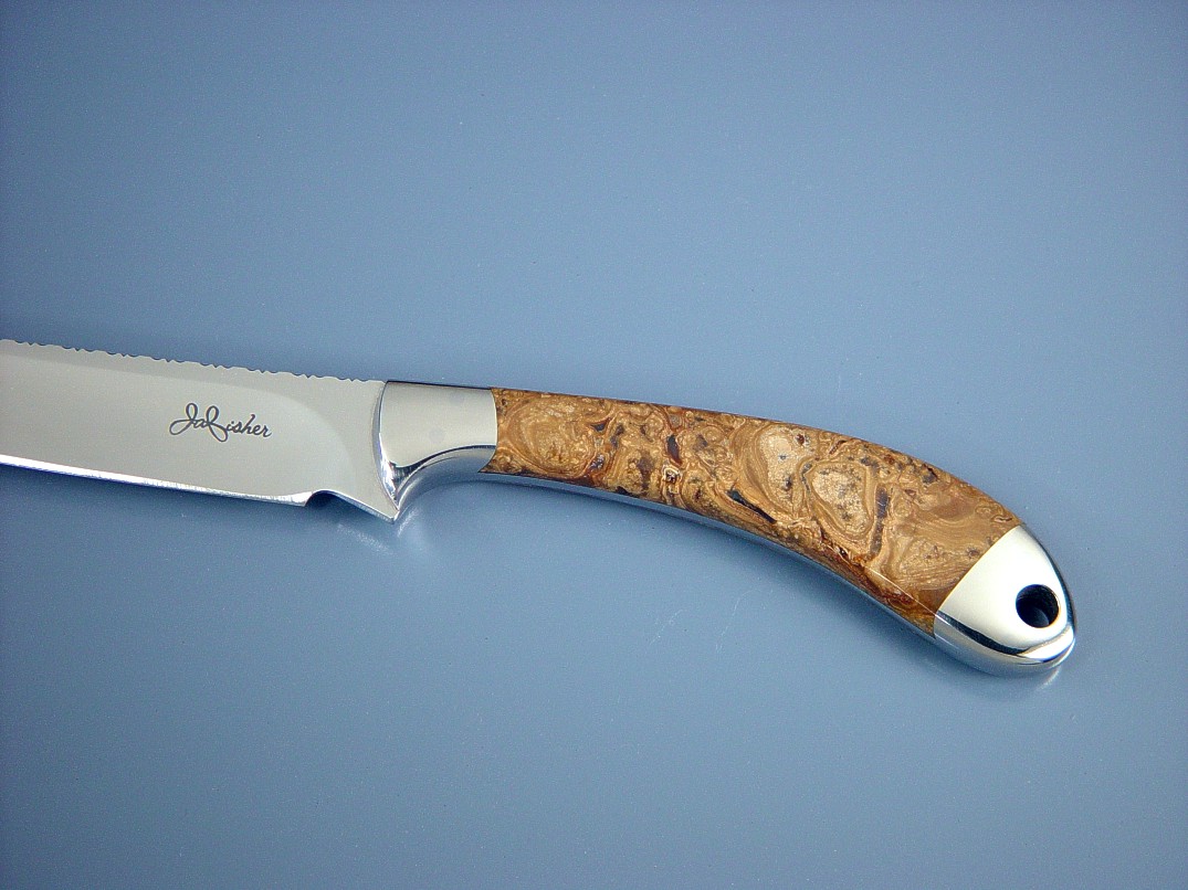

There are a lot of options for petrified gemstone materials that can be used on knife handles. Crinoid limestone comes to mind, as does petrified coral. Here is some 200 myo fossilized Cretacous algae:
