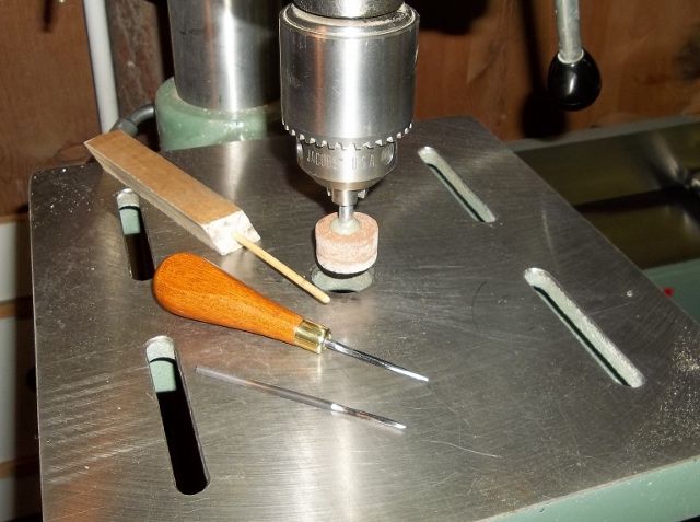

I made my own using a plywood jig:
Basically cut a piece of plywood into a diamond shape with a hole perfectly down the middle to hold the rod in place (wooden dowel used for picture purposes). You cover the rod with permanent marker and grind away material equally on each face of the rod until you get a tiny sliver of marker left on each corner. Then you finish the point with a file and wet/dry paper. And finally, you polish it on a buffing wheel.
I made mine from 1/8" music wire from the hobby shop (less than $2 for 36"). It is high carbon steel that can be easily annealed and heat treated.
I guessed the ratio of the narrow to wide width of the awl to be around 1:1.5 to 1:1.6.
Hope this helps
