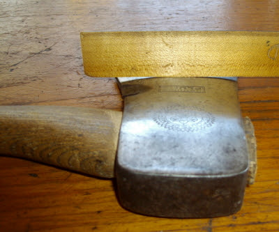

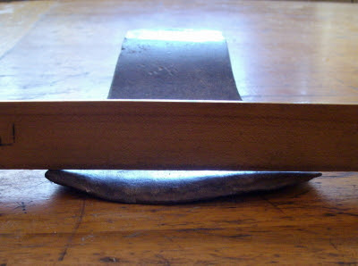

The photos below are an attempt to show the difference between the two schools of thought on head geometry:
[immediately continued in next post]
In group “A” (above) are two old American felling axes, along with the very model of Plumb’s Scout hatchet that Peter McLaren supposedly threw 42 feet to split a woodchip, plus our little Sandvik. Now, if a straight edge is laid across the fore-section of their heads (parallel to the ax’s edge) it will be noted that the center is higher than the top and bottom of the face. In some models the difference is very substantial, in others less so, but it is always there.
Group “B” are European axes -- Rinaldi from Italy, Ox-Head from Germany and the Gransfors forest ax. They all lack the “high centerline” feature. (This specific example from Gransfors actually has a slight hollow on one side of its face...)
“So what?”, some of you may now ask; “Is this a big deal?” To me it is a big deal; just exactly how big depends on the intended use for the ax in question...
In the discussion below I will refer to the two head styles as “flat-sided” and “convex-sided” (terms I just invented). A flat-sided ax is fine for limbing small to mid-sized limbs, cutting saplings the size severed in about one to three strokes, for dressing timber (i.e. carpentry work), and making kindling out of small dimension round stock or scraps of boards. In other words, for all tasks where the ax is not sunk so deep into material that will then exert significant side-pressure upon its face.
For felling and bucking larger than, say, 4” diameter trees, and for serious splitting of firewood, a flat-sided ax is, in my view, inferior to one which is convex-sided. (Assuming, of course, other parameters like head weight, overall thickness and width of face, as well as state of sharpness being equal.)
Why is this so? Well, a suitable chopping ax should not only sink into wood with relative ease, but also release itself from the cut sort of “automatically”. By this I mean that just a slight tug will bring it back to starting position without disturbing the “chi” of chopping. (I am not talking of splitting right now, though the principle is the same). The “high centerline" convex-ness of a fuller-faced ax helps in this regard because the wood has less surface to “grab onto/squeeze/hold” than if the sunk portion of the ax face is flat.

When I found this ax head (above) in a used tool shop many years ago, I bought it for $2 as a kind of souvenir, and with the notion that one day I’ll learn how to reshape and then re-temper axes in my forge...
I have seen many examples of abuse, but this one is unique. Namely, an average ax of good quality -- if that thin in the face -- would likely break before it bent this much. There was no sign that it may have gone through a fire (like a burning building). Its mangled edge was somewhat mushroomed over most of its length ( I had back then filed away the sideways-protruding metal), and there were couple of small chips but no cracks.
Interestingly, the poll showed hardly any signs of being beaten upon with anything harder than it (i.e. a sledge hammer). I suspect that this ax may have been used to chop ice on a road and driven (frantically, or stupidly) against rocks or concrete.
In any case, if I didn’t know its maker I’d think that it was some cheaply-made and uncommonly soft version of an ax. But we’ve used the Ox-Heads enough to know first hand that metallurgically speaking they are first class axes, neither soft nor exceedingly hard. (I never read how hard exactly, but guess them to be approximately 50- 52 RC.) So if anything, this bent-up ax head can rightly be considered a piece of advertising for the Ox-Head company.
