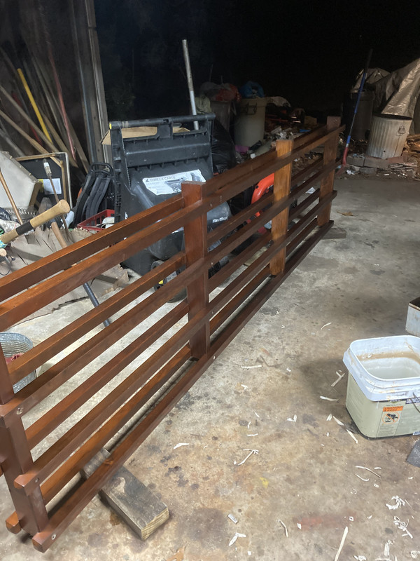

Built this axe rack last week. My shop was getting short on space. I have 75 axes hanging in the picture.

Honestly, I just had an idea in my head and had the lumber in my shop. The cross rails (horizontal boards) are all 2x2 pine and are 9+ feet long. This is just the size lumber I had available so these specs are subject to change depending on what you wantThere are four 2x4 vertical posts that are 36”. The 4 are spaced equally apart and make three racks within the racks. I liked having the separate sections as I used one for DB’s, one for SB’s and one for camp axes and cruisers. I attached the 2x2’s to the 2x4’ by cutting out a shallow notch with a router and then fasteners of course. If you have any questions I can take pictures that show the construction better.I need to make something similar. Any chance you've got some plans for it?

Thanks! Fortunately the racks are on the first floor of my home which was built on a slabWell done, the notched uprights were a nice touch. And that’s not even “half” your collection?? Hope the room has a strong floor, lol.
