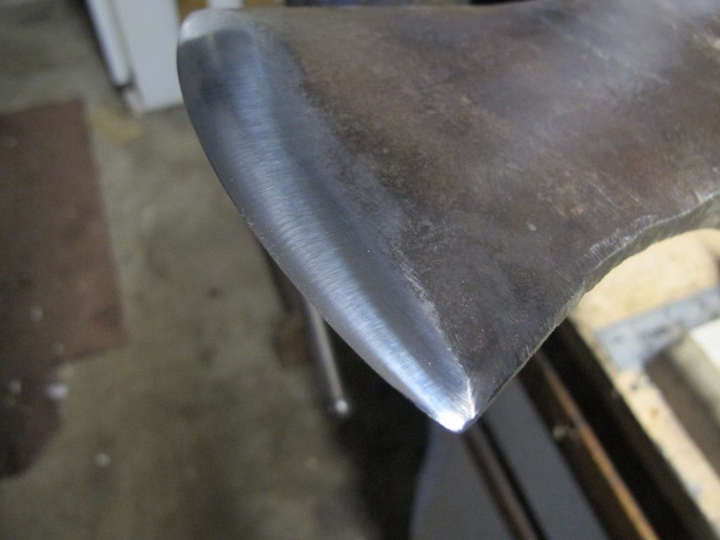

here is a mann double bit i polished up with sand paper up to 1500g and then with a bench top buffer with a couple different compounds.
http://www.bladeforums.com/forums/showthread.php/1215739-Mann-Lewistown-PA-DB-and-WC-Kelly-Perfect
getting the lighting just right is tough with a cheap camera. the pic with the coke can reflection shows the polish best. the head has a coat of beeswax and oil so its not a bright as when its clean. shows the minor pitting in the shine tho.
just using sand paper up to 2000 will get you a nice shine also, but is a ton of time hand sanding. i have done many axes that way, but only the bit/grind though. i much prefer to leave most of the original darkness intact, with the bevels and bit shined up.
a polished bit makes an enormous difference in penetration by the way.
