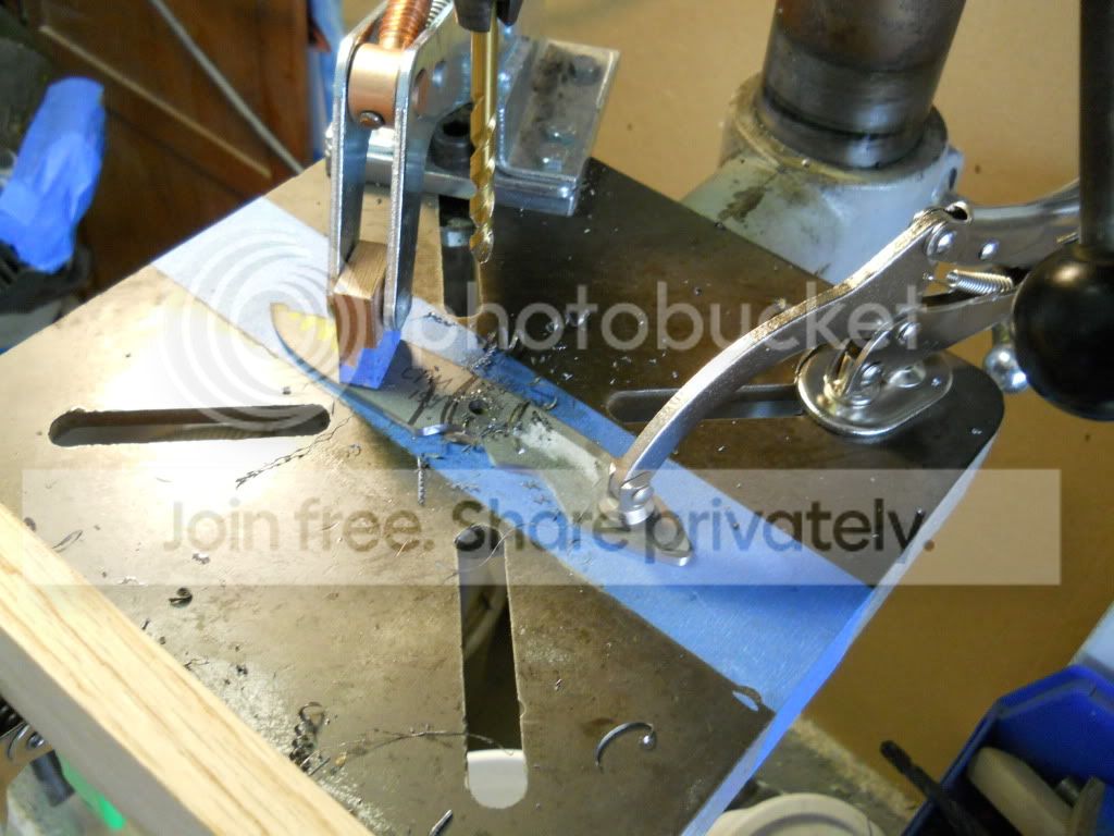

Well, I'm very careful to securely clamp my work when drilling holes, use plenty of cutting fluid, and I've had a great track record with the drill press, but am a bit shaken by what could have been a whole lot worse if my heavy duty Kant-Twist brand clamp hadn't done it's job:eek:
I had been thinking that it was about time to pick up a fresh couple of 3/8" bits for drilling tangs. I use the ti coated bits from Dewalt with the little starter point and I've always been happy with them. Started to drill through some .144" CPM-154 today and was already thinking that it wasn't cutting as smooth as I'd like and that yes, I definitely should get some new bits soon. Right at the end, with the hole on the backside about 1/4" just ready for final breakthrough everything went bad. The bit somehow snagged in the hole and with a whole bunch of force drove the half of the blade that wasn't clamped down up the bit about an inch!! At that point the bit seized up and stopped the motor in it's tracks. I ended up with a severely bent blade with somewhere near a 140 degree angle. Thank god that Kant-twist held firm because I don't want to know what would have happened if that blade had been shot right into my stomach!

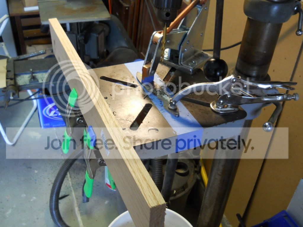

That one scared me a bit, so I immediately added a second clamp to hold down the opposite side when possible, and did a quick setup of a barrier with some clamps and a piece of 1 inch oak to block any projectiles. Is this a little better? Am I being a little too paranoid? Does anybody know if there's anything I did wrong to cause that to happen that I can change in the future? If it was an operator error, trust me I don't want it to happen again.
Here is how I changed the setup.
On thicker material, with a large hole, you should ramp off the pressure on the tail end right before you break though. FYI Most of the time a blade will not be thrown, it will just turn into a helicopter rotor.
No you're not being too paranoid. When I work on anything that requires cutting, grinding, drilling I always take the utmost precautions. You're right, that blade could have easily flung straight into your stomach and your story would be on Spike's "1000 ways to die".

I would clamp closer to the hole being drilled and add a clamp or bolt of some type in the direction of rotation that can stop the blank from rotating at all if it comes loose from the clamps.

I was a bit surprised to read that you are using those "starter point" drill bits for steel....especially for drilling something like 154. After viewing the first image, and seeing the size of the "chips", my opinion is that using those bits is asking for trouble. Chips of that size are normally what you would see coming off of mild or wrought, and only then if your really over pressuring the bit.
I would recommend staying away from those bits for anything other than very soft materials such as wood, plastics, Micarta, etc. Get yourself some good 135 degree split points, and back off on the pressure. The best safety feature that I have ever come up with for drill presses is a momentary foot switch (Linemaster/Clipper switch). That way IF something goes wrong, you simply step back and everything shuts down.

I don't have any problem with sharpening normal drill bits, I've done it many times. I've just had really good experiences with these bits and still in the past. Ed, maybe you're right and they're not the best for this. The bit that did this today had drilled hundreds of holes perfectly up until this morning, and although the chips you saw were large, there usually weren't many at all, just nice big solid curly cues all the way through.

In my opinion, your setup looks okay. Also, it is okay to use a fair bit of pressure when drilling a hole. It is counter intuitive, but underfeeding a cutter can wear it out due to excessive rubbing.

If you're getting hundreds of holes in knife steel out of consumer quality drills, you're doing it right, and your set up looks okay. I think you may have simply got sloppy with your technique.
