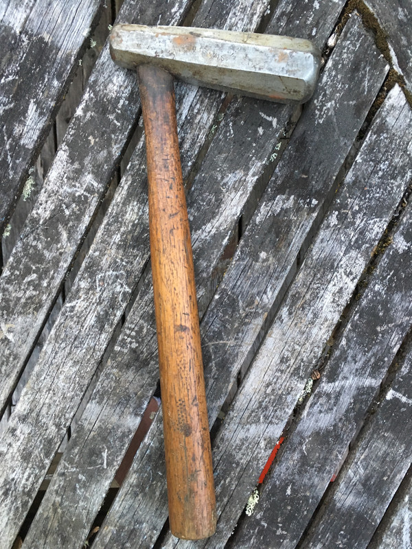

Whenever this topic comes up I am always reminded of dog head hammers. The balance of a striking tool is the ability to hit what you are striking with out side to side wobble, or square. Probably not the best way to articulate that and not everyone will agree, including some tool manufactures. But that is what balance is to me.
Garry, I thought that was well-articulated with the dog head hammer example.
Closed hang in this case maybe keeps the side to side movement down?
I would think that would be all about what Old axeman might call angle presentation.
We have seen some examples here lately of a cobblers hammer that was really closed also. Working over the edge of an anvil is one of the places such a hang might be advantages.
Maybe I should have called it angle of contact instead of angle of presentation. Years ago I thought angle of presentation made me sound smarter. While balance is important, the angle of presentation is more important to me. This all relates to the task you are trying to preform with the axe. You can adjust to the balance, but not so to the angle of presentation that the size and shape of the haft dictate.
