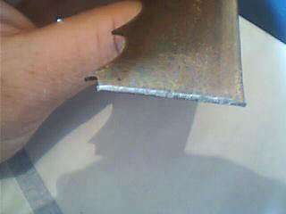

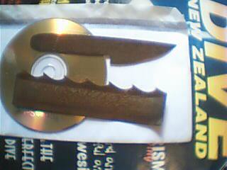

hmm... reading my first post again, describing the saw blade. 1/3 is teeth should read 1/3" or one third of an inch. heres a pic of the raw blace snapped into a short length, plus the knifish bit, with a CD-ROM as scale. the grain where I flexed and snapped the bit off is nice and grey with a very fine grain small enough it looks like matt grey paint. I hope my HT and quench can make as nice a grain :D might be just as easy to make thin filletting knives just out of the basic blade by grinding off the teeth and profiling it up :D
The webcam is crap, makes the grain in the pic look big and granular [:(] but the good digicam has flat batteries so this will have to do [:P]
