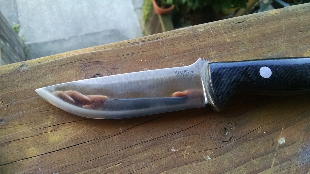

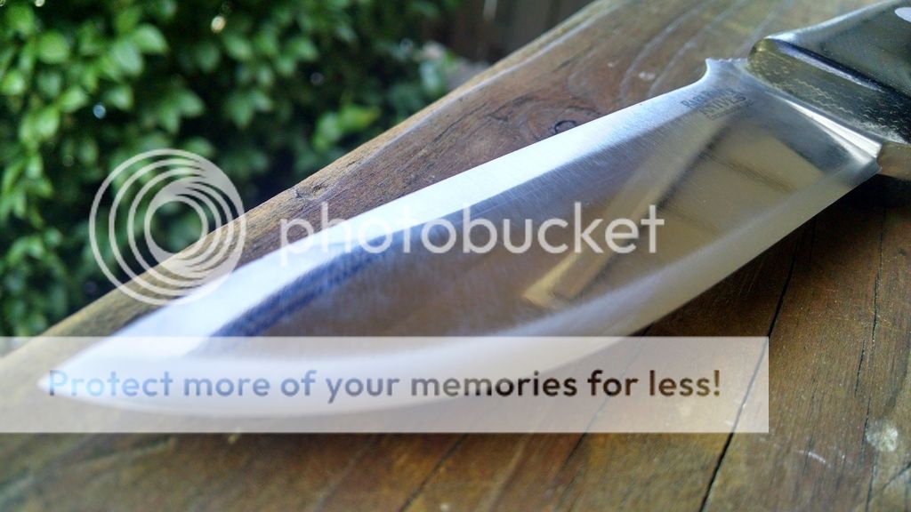

The blade geometry. This is my favorite blade geometry off all of my knives so far. It's simple, elegant and razor sharp. The convexing is not as bulbous as a Fallkniven H1 or A1 it can almost lay from grind to edge on a strop but not on a flat stone.
This grind is alot like a Finnish Puuko knife which has a high full grind to the edge but is not necessarily convexed.
The knife came with what looked like a micro bevel. a small reflection of light about the width of a hair was seen when looking perpendicular at the edge at a 20° angle.
Stroping with compound also didn't make it any sharper further confriming I was not reaching the primary bevel from the grind.
Out of the box it was able to cleanly cut printer paper and shave a few large hairs with effort.
I decided to regrind the knife to zero to remove the micro bevel.
Waterstones are essential for this. I can't imagine doing this on a Spyderco Sharpmaker.
Zeroing a convex starts by regrinding a primary bevel then blending that into the grind this involves changing the angle lower and lower to remove the all the shoulders and blend it perfectly into the grind. Most sharpening on waterstones by hand is convexing the bevel over time it just a matter of blending with a convex ground knife.
This is done with a back and forth motion on stone terrecing each angle and then a rocking is added while grinding back and forth to blend it all in.
Zero grinding, This is what really brings out the performance. Arm airs "popped" off when shaved and wood was cut like a laser. The amount of joy this brought was immense and at the same time creepy because of how obsessed I've become about knives. I'm sure someone saw me giggling shaving hair and carving wood and was quite disturbed haha.

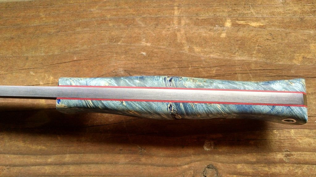

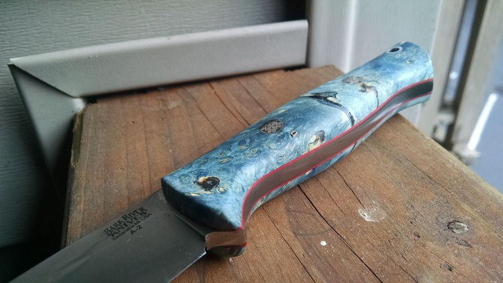

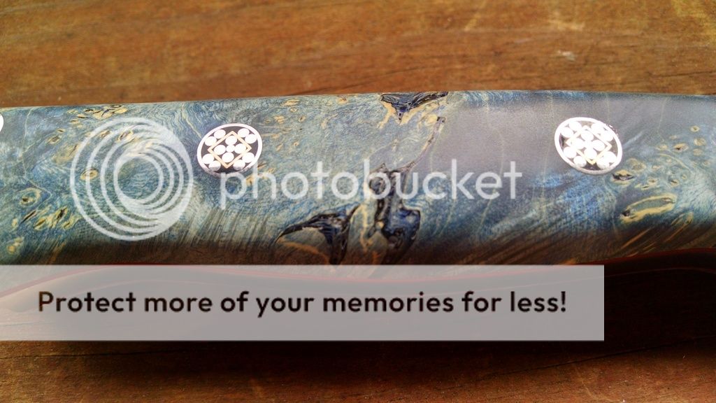

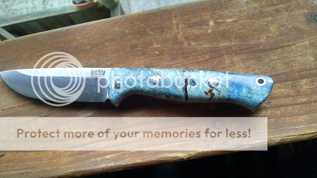

The handles are just beautiful. I'm so blinded by there beauty that I don't care that they are smallish for large glove sive hands.
I didn't think I would like the smooth handles but after carving for a few hours it was quite comfortable. I did get a muscle cramps in my hand from the narrow area before the palm swell. That's OK it's designed for medium to small hands. I hate finger guards. This is a very large and comfortable one though.
The ramp is pointless for my needs. The jimping is very grippy, A lot like the high end Spydercos. The front of the ramp can be uesd as a ferro notch but I prefer to use the tip anyways. I could have it sent in but I just don't care to go through the time, cost of shipping, and effort involved.
Despite the drawbacks this handle is just too beautiful for me to care. Love it.
The worst part is that they are not interchangeable handle scales meaning if you see scales you really like, one has to buy a whole new knife!
Even worse...
They are so beautiful I'd buy two of the same knife just to get the scales I want hahahaha. Oh god help me.
I should have never went to Knivesshipfree. Once I saw these Handle scales. I lost it. Had to have it.
That's the best part about Bark River in general. The scale options are incredible. This is the greatest combination of art and performance at a obtainable price I've seen.
I wish the picture could do it justice.
I wish all knives had red liners.

The stock geometry on the Bark River has a micro bevel at ~40-45dps per side
It leaves more to be desired.
Especially when my other heavy duty knives like my Fallkniven A1 and BK 2 pop hairs
It scrap shaves hair. It s just too obtuse
This same geometry on my Bark River Gunny is way sharp.
But because of the thickness of the Bravo 1, its a meh.

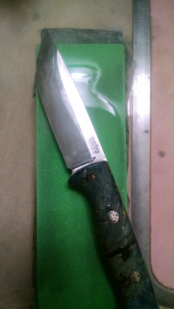

I reprofiled the knife virtuevoice style.
Unlike the Fallknivens geometry that is more bulbous.
If you take a stock Bark River Bravo 1 and lay it flat on a stone, its convex is super shallow.
The scratchs reach all the from the micro bevel shoulder to 1mm below the shonogi line.
The game plan is to keep grinding until a burr is formed on both sides and the microbevel is no more.
Grit progession
Chosera 400
King 1k
Suehiro 3k
King 6k
Bark River White compound
Flitz metal polish.
2 hours later
Sharpest knife in my collection.

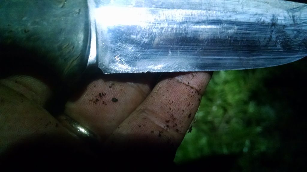

I went to for an overnight tarp camping trip in the foothills of Mt Hood.
The performance was great.
I cleaned the campsite of pine branches and was showing my wife how to safely make tent stakes.
Upon inspection of the edge however.
Massive damage
If one was to lay the Bravo 1 flat on a stone and sharpen away the microbevel, the geometry is just too thin for wood carving.

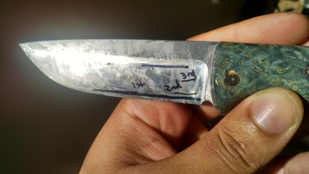

So the current plan is to start with a 15dps secondary then blend that into the primary in series of terreces that will then all be blended into the primary.
I'll update with progress
I use A2 steel frequenly when woodworking. I have A2 plane irons and chisels. I too got the same chipping out and had to resharpen at higher angles. That did fix it, but my conclusion was that A2 is not ideal for a good thin knife edge. I will never buy a knife in A2.
