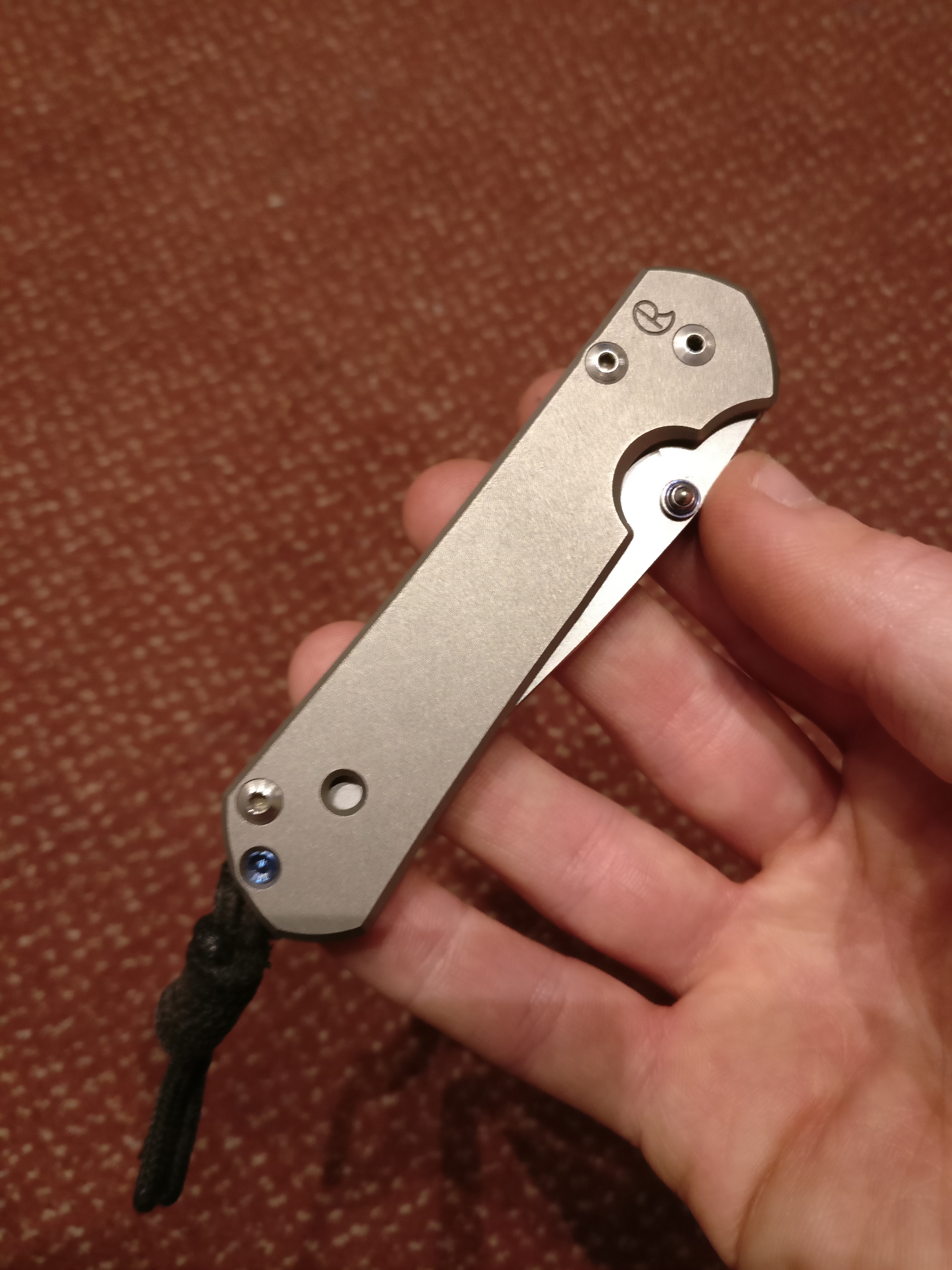

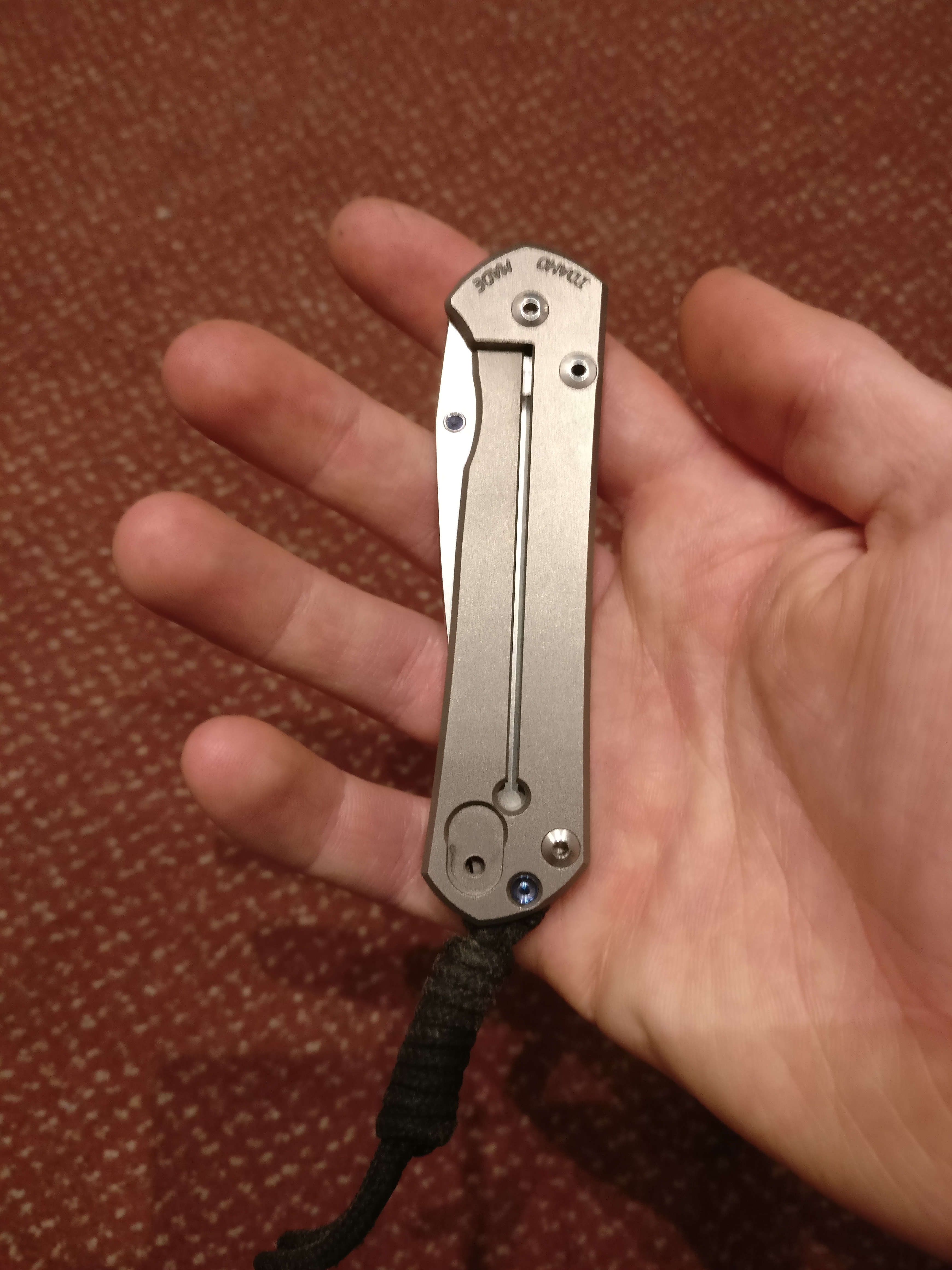

Thank you all for the replies and help. I finally had the courage to blast the Sebenza after the bending titanium nightmares. And it went super quick and without any problems. Results here:
That turned out nicely! I haven't done bead blasted finishes in ages. Last time was a set of S35vn drop points for a couple of police officers
