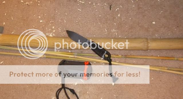

I finished my three for Ethan's contest but I want to do more. There is a foot of snow on the ground and more falling. If it stops tomorrow I will finally get to set my traps. In the mean time I'm indoors, which sucks because there's not much trap practice that I can do indoors that will really entertain me. I decided to try my hand at a new trap. John (Rescue Riley) sent me a link to a Tilong rat trap that looked really cool so I decided to make one. I didn't have any bamboo wide enough in the house to make the trap full size so this first one is gonna be a mouse trap instead.
Here are the raw materials, along with my Eskabar

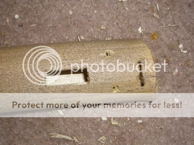

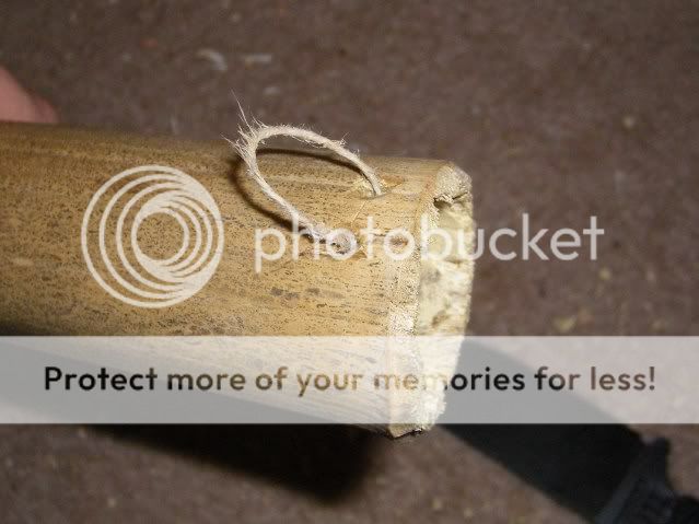

Step one, notch around the bamboo so it breaks cleanly and then use the tip of the Esky to drill two holes for a loop of string that will anchor the back of the toggle

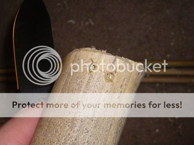

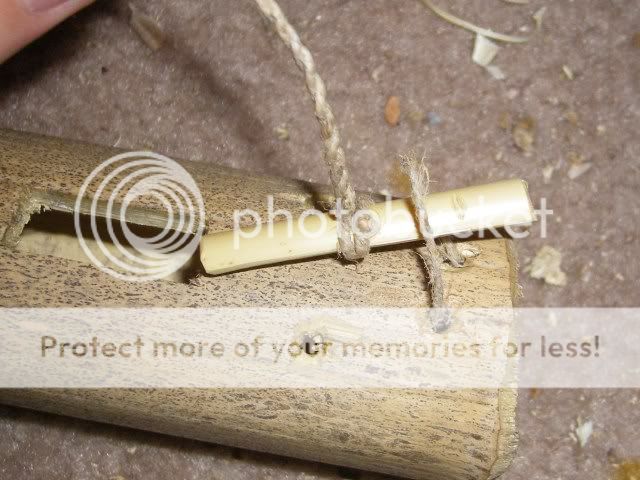

Step two, use tip of knife to make two more holes behind the loop. These holes will eventually be for the killing noose. Then cut a rectangular notch behind the noose holes

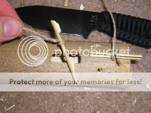

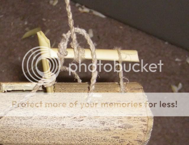

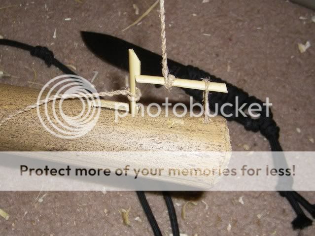

The first pic shows the toggle and the second shows the trigger and the third shows the trap set but the noose is not installed yet. This is just to show the trigger mechanism.
The bottom of the trigger is the bait stick. It extends deep into the trap and will be smeared with bait like peanut butter on the back side

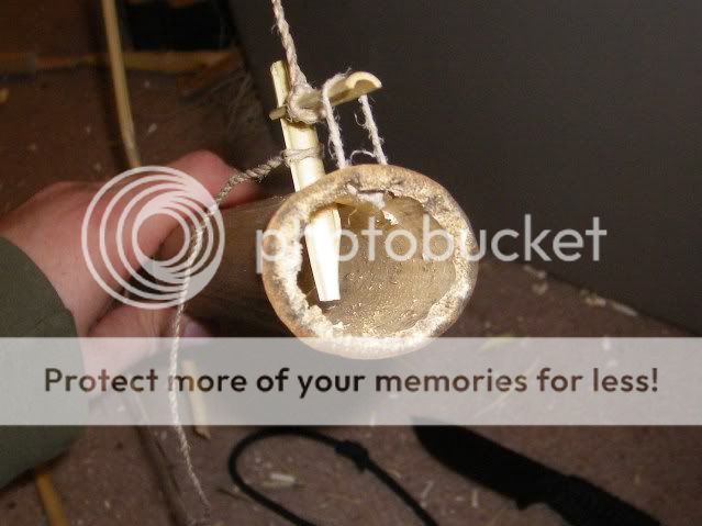

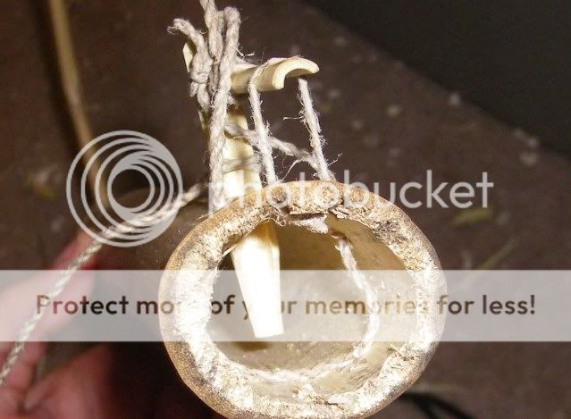

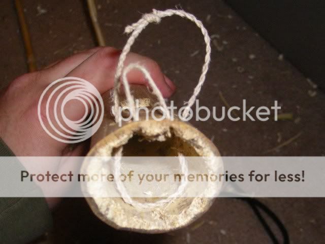

Now install the killing noose through the holes drilled earlier.
Slip the noose around the toggle and set the trap as before. The trap is now armed.
