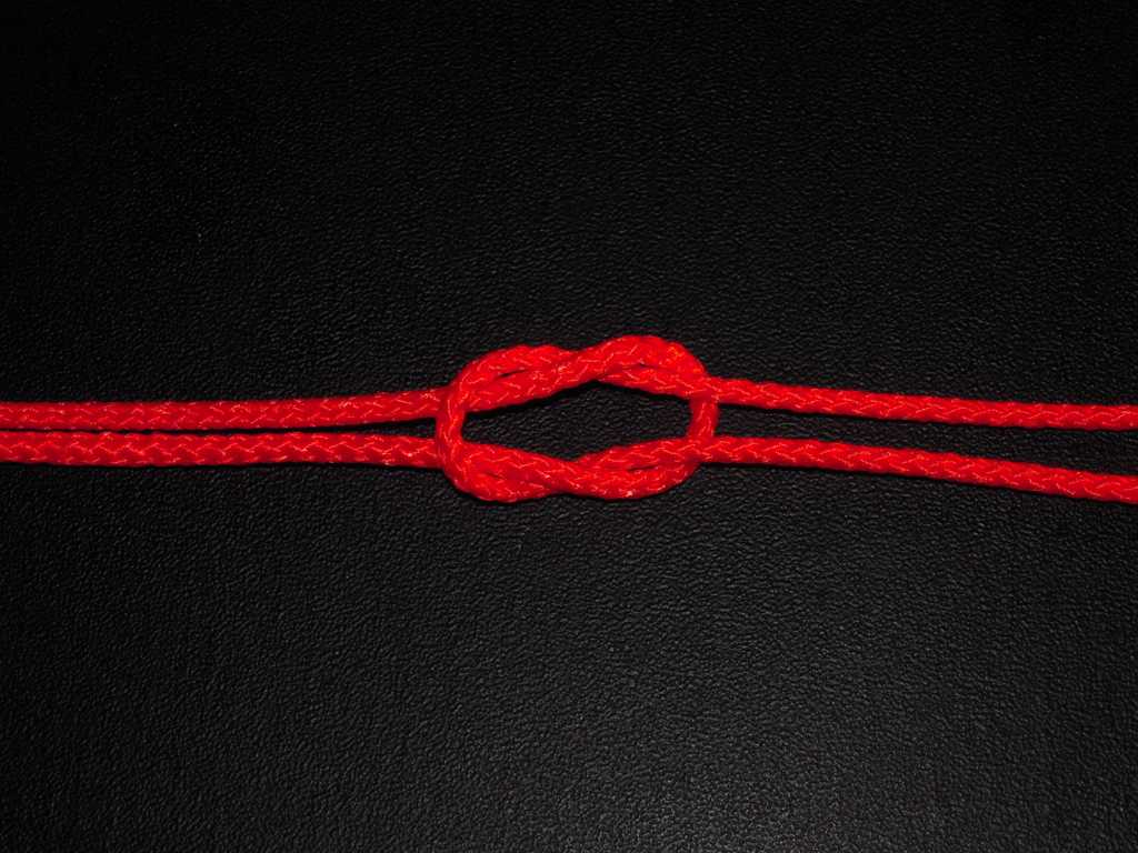

The Square Knot - Also known as the first aid knot, doesn't come undone with use, useful in bandages to keep them in place.

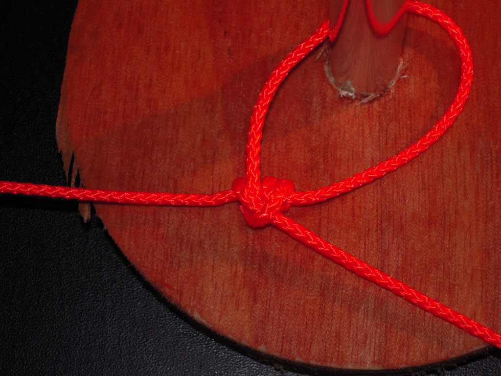

Two Half Hitches - Basically a clove hitch around your cordage, make for a very useful and easily tied sliding loop. I use this frequently in securing cargo on the initial end before tensioning.

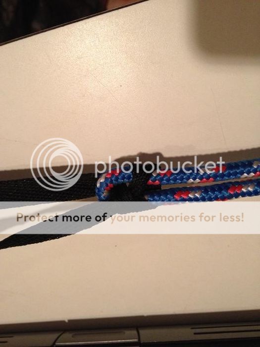

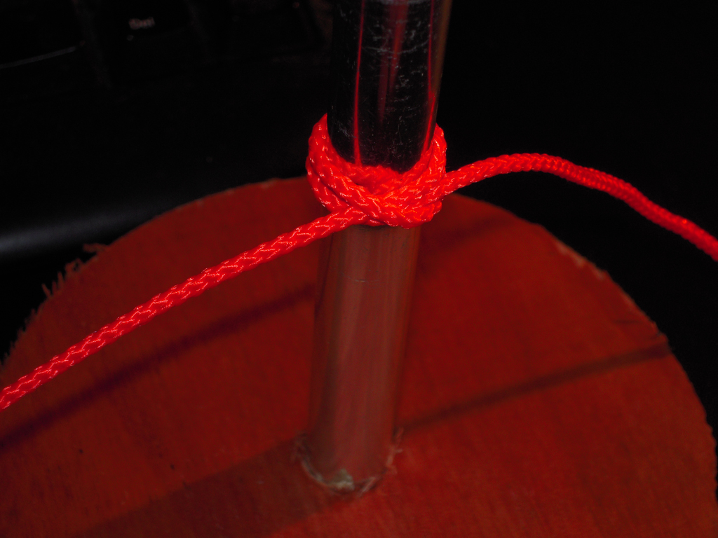

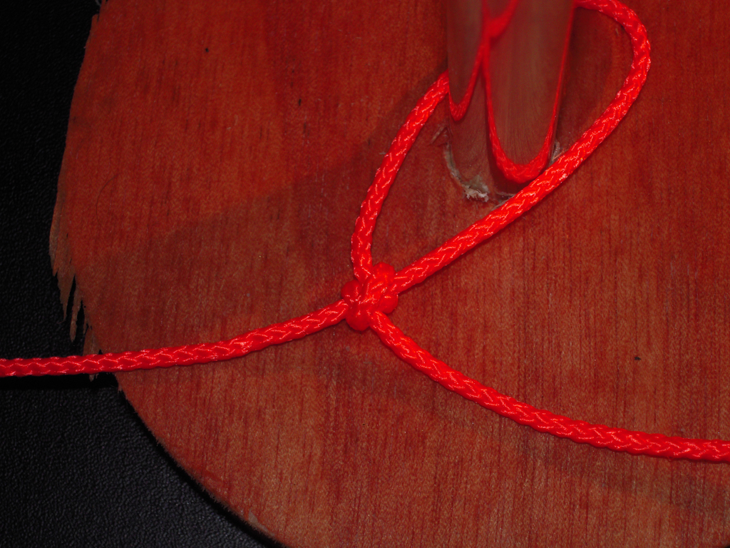

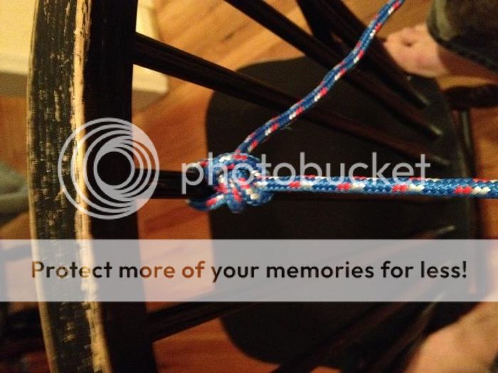

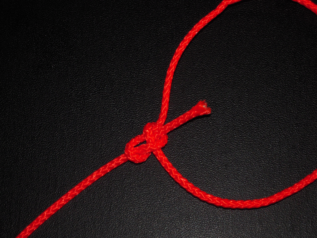

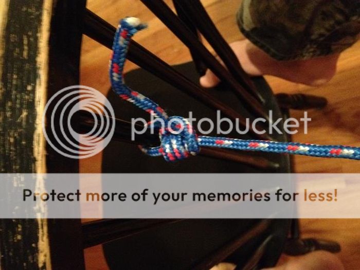

knots are my thing. I've fished since i could hold a pole and my old man taught me a million and a half of em. here's 4 i have pictures of because i used them for another forum. I'll post some of my useful ones i learned from sailing, fishing, boating, etc.
these are basically a couple repeats of yours derekh, but still, I thought i'd post em nonetheless. I'll add new ones soon.
figure 8 on a bight
sheetbend
tautline hitch
2 half hitches

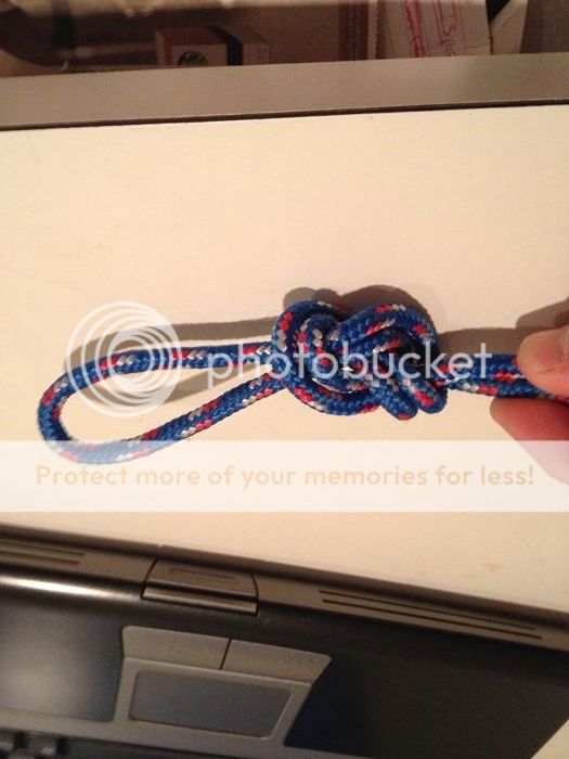

figure 8 on a bight
I think it should be noted that this double figure eight is also very good at joining ropes together.

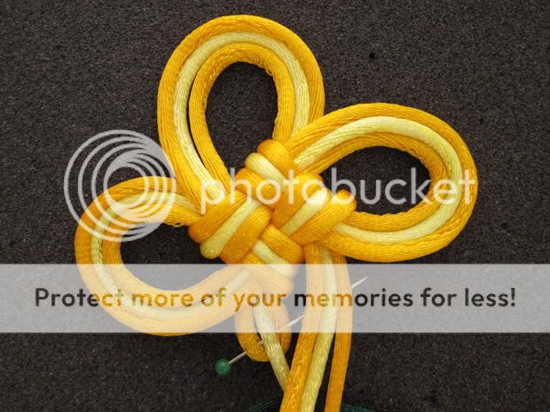

I can't do a turks head to save my life! I've tried multiple times, looked at videos, looked at step-by-step walk throughs, even had me shown in person, I just can't do them. However they are more of a decorative knot to me so not one of the necessary ones. One of my favorites for just killing time though is the Chinese clover knots
Not my picture:
